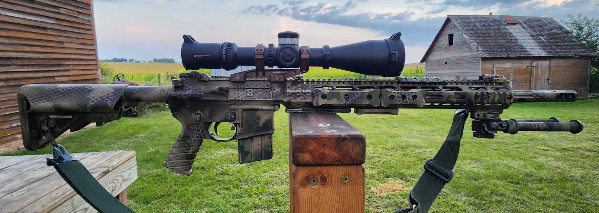

So I put together a non clone correct SPR type upper and have been struggling to get the groups I had hoped for. Trying to get some feedback from some more seasoned shooters regarding gas gun accuracy shooting. I mainly have shot bolt action when trying for precision and so I’m not sure what to expect realistically. I’m trying to do some basic load development using 77 gr OTM from Mid South Shooters. I’m loading new Starline brass with Varget and CCI 400 primers. Rifle is 18 inch PRI Douglas stainless MK 12 barrel 1:8 twist Geissele Mark 18 Arca handguard on BCM upper receiver matched to my BCM lower with Geissele 2 stage trigger. Using B5 Sopmod stock with a bag rider. Shooting prone with bipod on front and rear bag. Optic is Meopta Optika 6 3-18X 50 in ADM Recon mount. taking my time and shooting groups at 100 yards, checking all the boxes of solid position, breathing, trigger control, follow through,ect…most groups have been larger than moa. I have one sub moa 10 shot group so far in 200 rounds of attempting my best. I can shoot in the 3’s with my Tikka CTR 308, but don’t know what the deal is so far with this gun ammo optic and shooter combination. Any thoughts? Maybe I should try some 75 gr Hornady or some 69 SMK, but not really blown away so far with this barrel. I’m not saying it’s not just me shooting poorly. I hear a lot of people online claiming 1/2 moa groups with precision gas guns so I’m thinking I have a dud, but then I watch 9 hole reviews comparing a PRI douglas to a BCM 18 inch 1:8 and their best 9 shot group was 1.3 inches with factory Match ammo…I’m fairly new to precision shooting, reloading and especially precision gas guns, so what’s some thoughts dudes of the more seasoned variety? What should I focus on?
I am new to gas guns too. For the better part of 10 years my poison has been precision rifles with an incline for long range shooting. Which led me to start compeating in field shooting. This was the only way to stretch out to and sometimes beyond 1000 meters.
With my fully decked out Sako TRG 22 I was able to shoot about 0.5 moa back to back with handloads. With my new AR, not so much...
For the past year, I have dived into gas guns and have tried alot of stuff to get things going. The difference from a tuning fork stiff TRG to an AR with some play here and there has been detrimental at times. That and the fact that the locktime on an AR is completly different to that of a precision bolt rifle.
I have been able to go down to 1.1-1.2 MOA groups at 100 meters at times. But no where near on a regular basis, around 1.5 MOA would be closer to the truth. But I am thinking that this is the nature of the beast. An AR was never ment to be a TRG, and never will be.
I am however still curious to just how tight I can get my AR to shoot. Thats why I ordered a WOA SPR barrel for it, and I think it will get here this week.
My AR is pretty much a faux Mk12 mod H as it is. But will get a 18" barrel with rifle lenght gas now when the WOA gets here. I have also shot friends DD Mk12, DD M4pro, IWI Zion SPR and a few others. My roundcount is just below 2000 rounds shooting ARs since this past october.
Will report back as soon as possible.

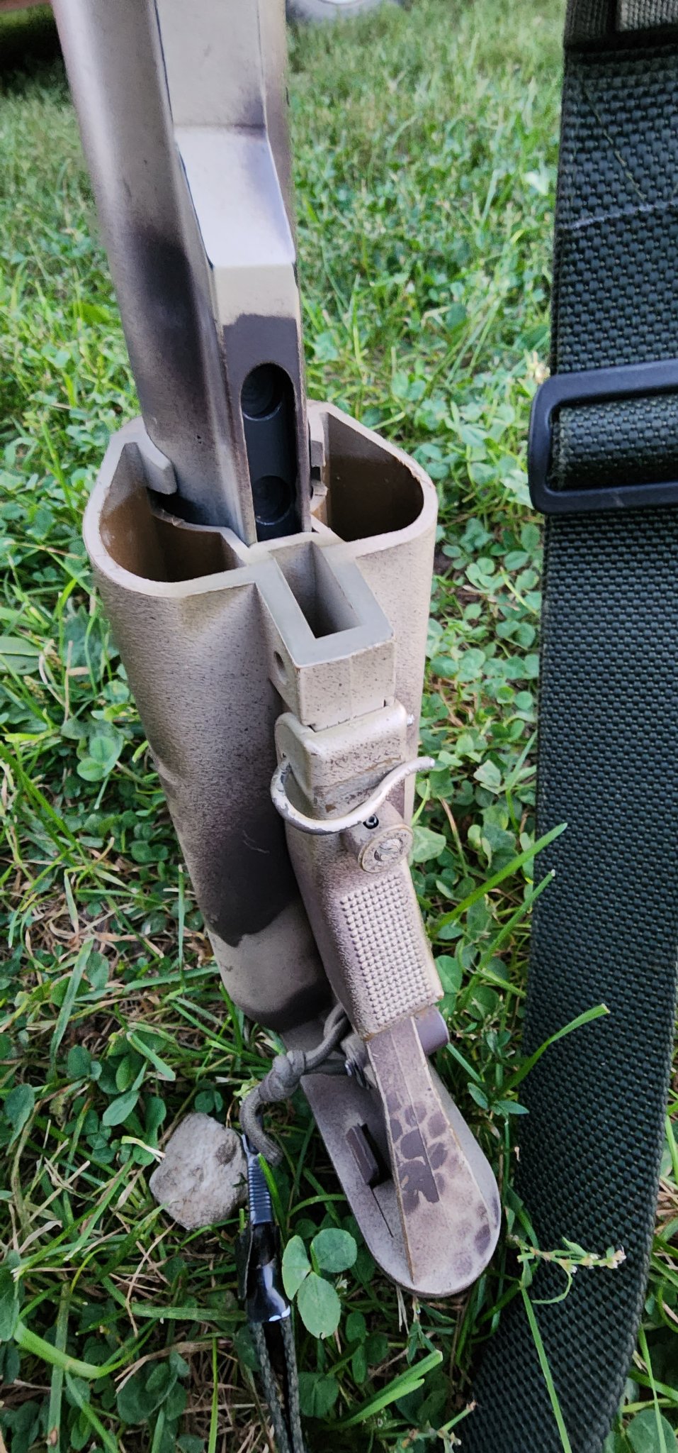

I agree. I use a b5 on mine for prs. I've modified it by drilling a hole in the stock adjustment lever to allow me to lock it into position. I've had the stock close when shooting off a bag. Now it's pretty solid and will only move when I want it too.

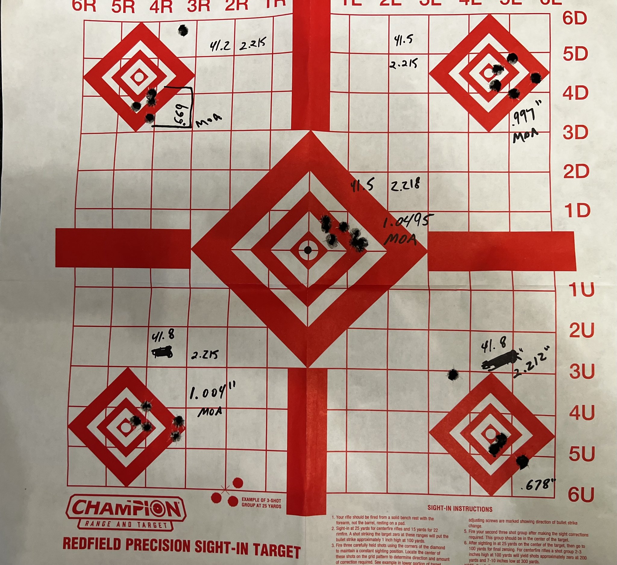

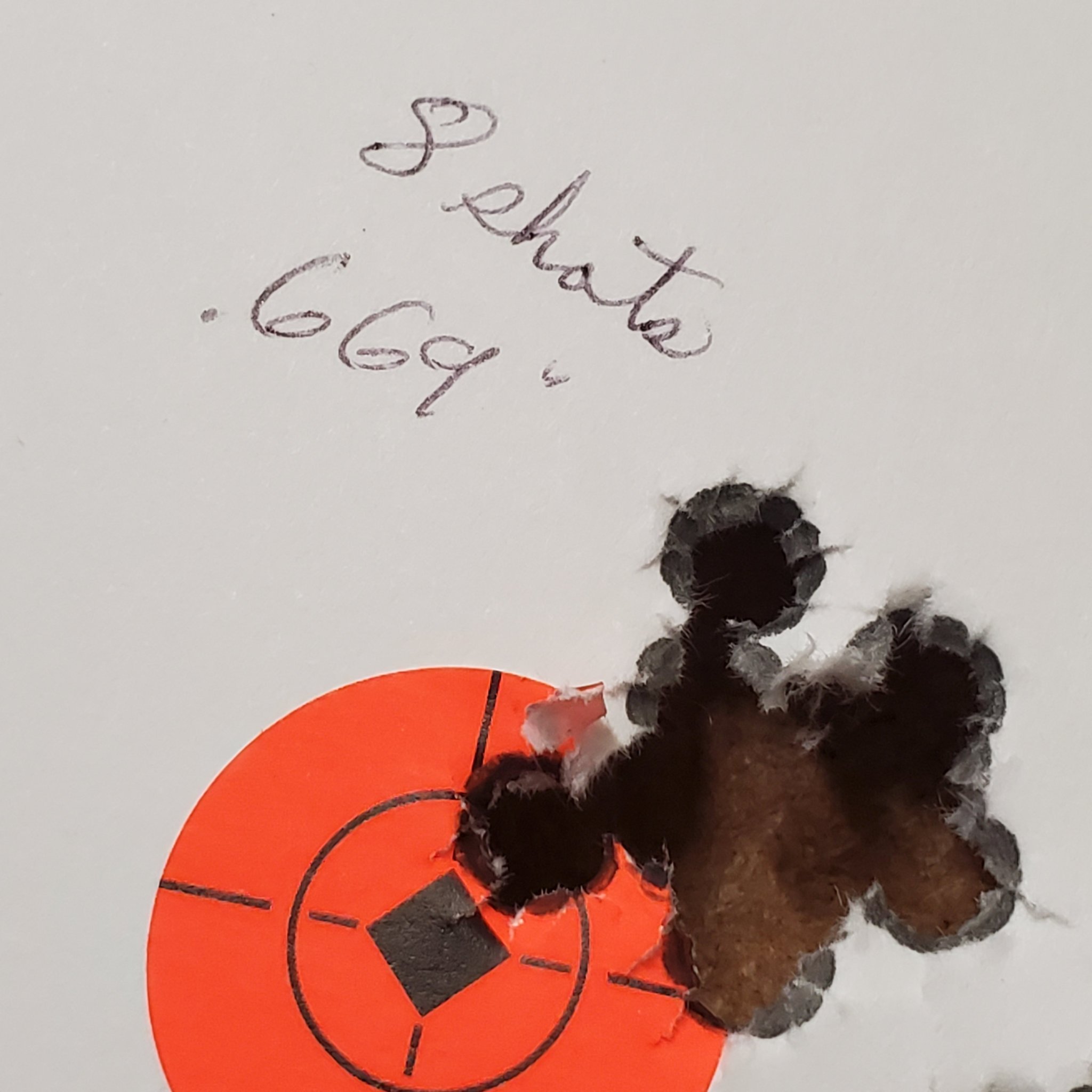

I'd say 10rd into 3/4-1MOA is peak performance for an AR that isn't built as a purely match rifle
You could try different seating depths for your bullets and weight sort them if you aren't doing so already
Shooting inside of 500 yards a flat base varmint/match bullet would be an easy choice and they group really well on paper
ARs are a bit strange...sometimes a cheap barrel will shoot good... but that would not be the start for a precision rifle.

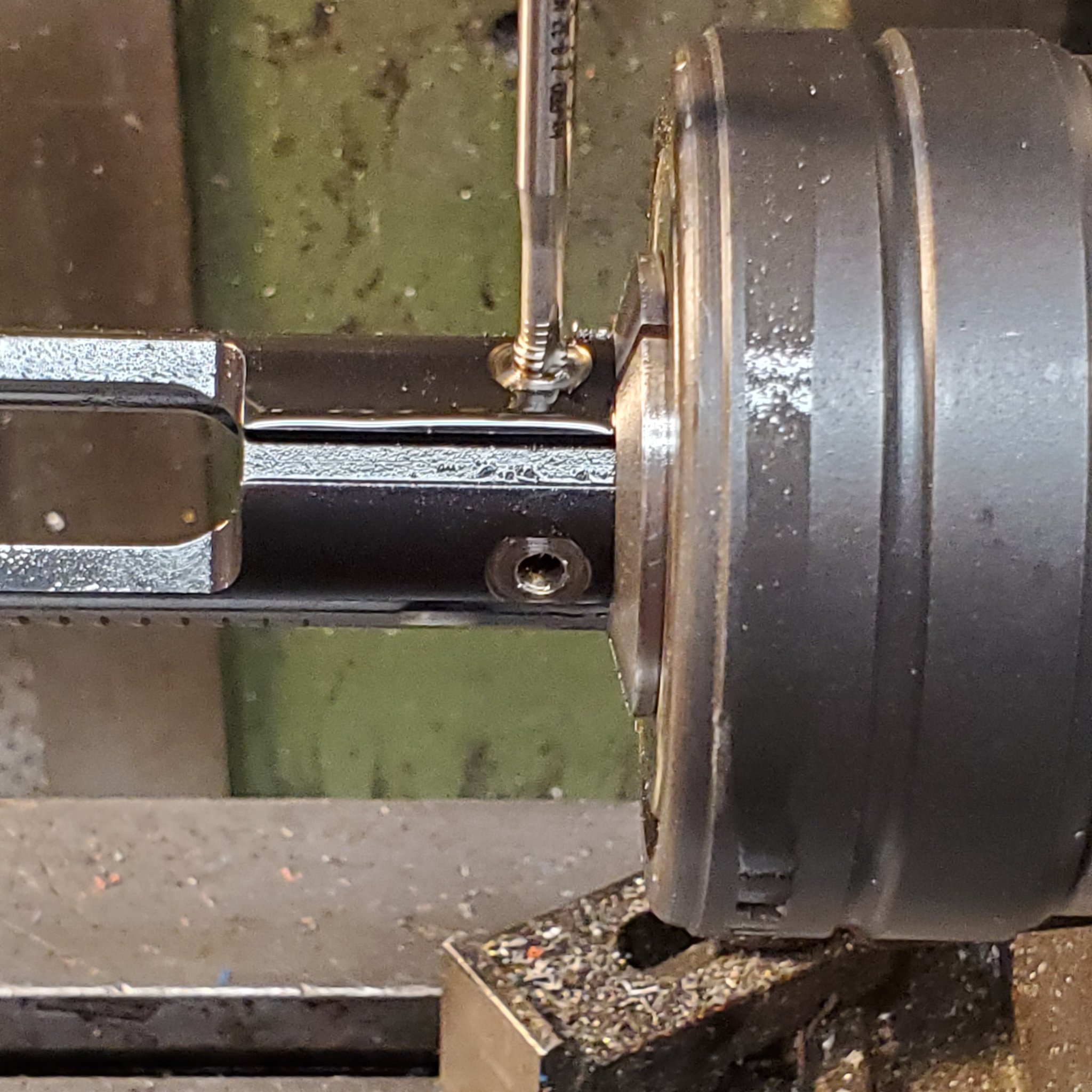

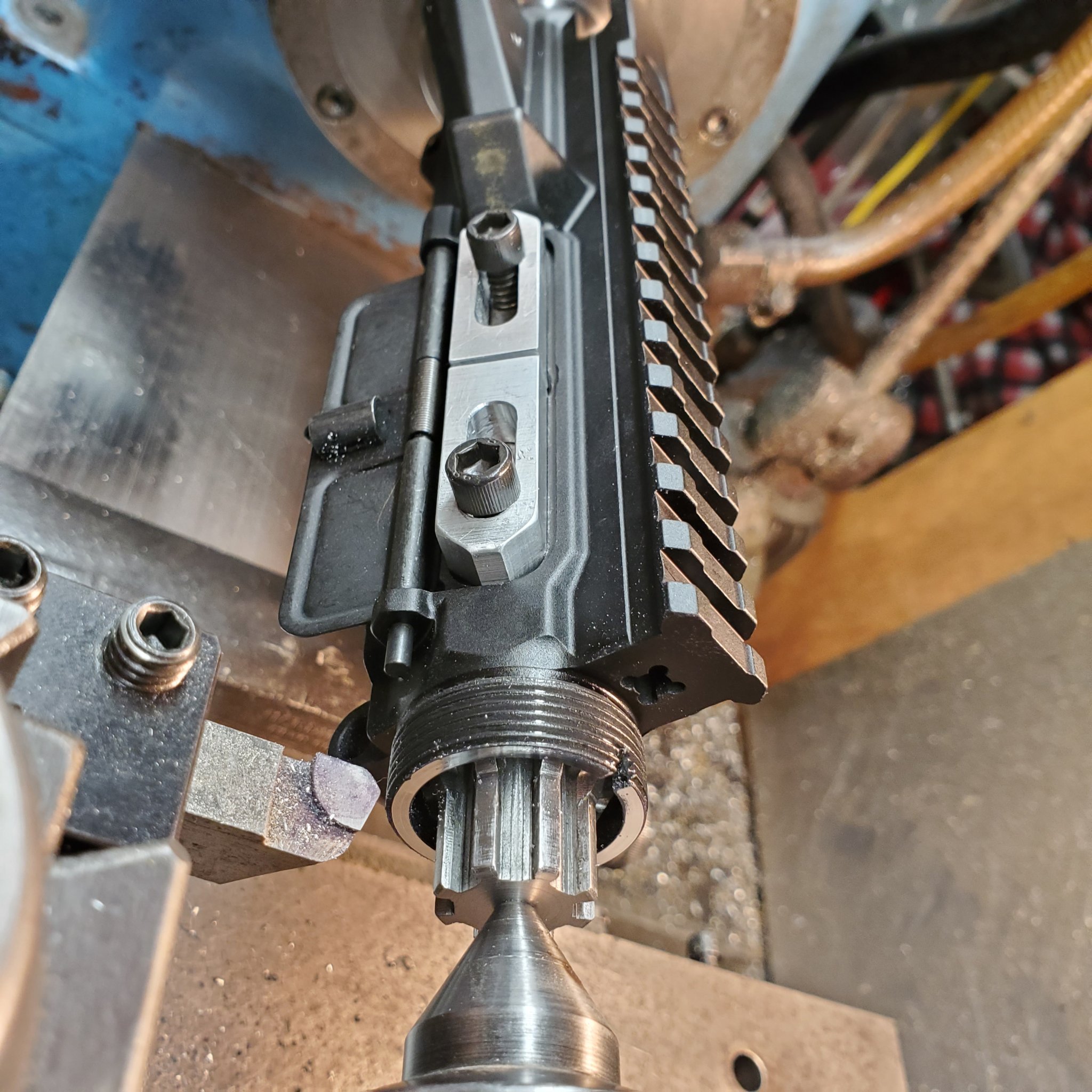

I took a 8000 rd bolt 308 W with lots of firecracking. Cut & Profiled the barrel for AR 15, made it rifle gas, put it together with used and leftover parts, including a used barrel extension. Chambered it for 30 RAR an obsolete cartridge. Total cost $340 including the reamer. So how does the 8000 rd 308 barrel shoot as a AR 15 30 RAR. Very good with the same bullet as it liked when it was a 308 W.
But I'd never suggest this for a competition rifle. I start with a premium barrel. True reciever face. Glue in with green high temp bearing sleeve loctite, wax the reciever in that area for removal. Always tighten barrel nut to 60 ft/lbs. Mill a gas tube slot to make it so.
Some Will start at say 38 ft/ lbs and work up, tighting the barrel at the range...shooting their match ammo to see if the groups tighten up...I don't do that.
I center the bolt carrier requiring a lathe, mill, and inspection equipment.

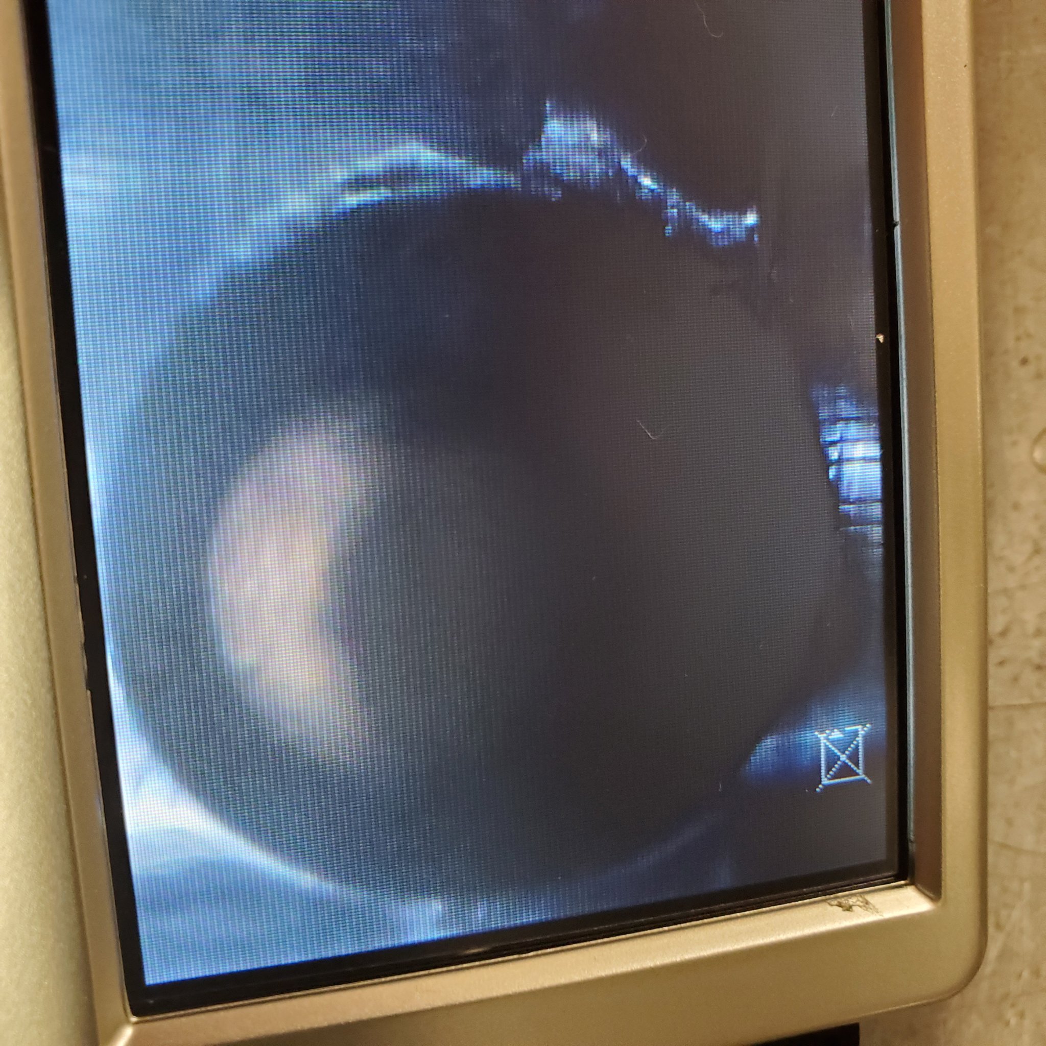

Also have a bore scope to check your barrel and chamber interior.
You may have a burr at the gas port like this. Recut with the next size up, new sharp number drill, with dark heavy cutting fluid.
Then lapp and inspect before installing. I generally lapp all barrels,..keep the muzzle tight. If a 5.56 consider not having it threaded for a muzzle device. The more one cuts down the OD for a muzzle device the more the bore opens up in that area...especially button rifled.

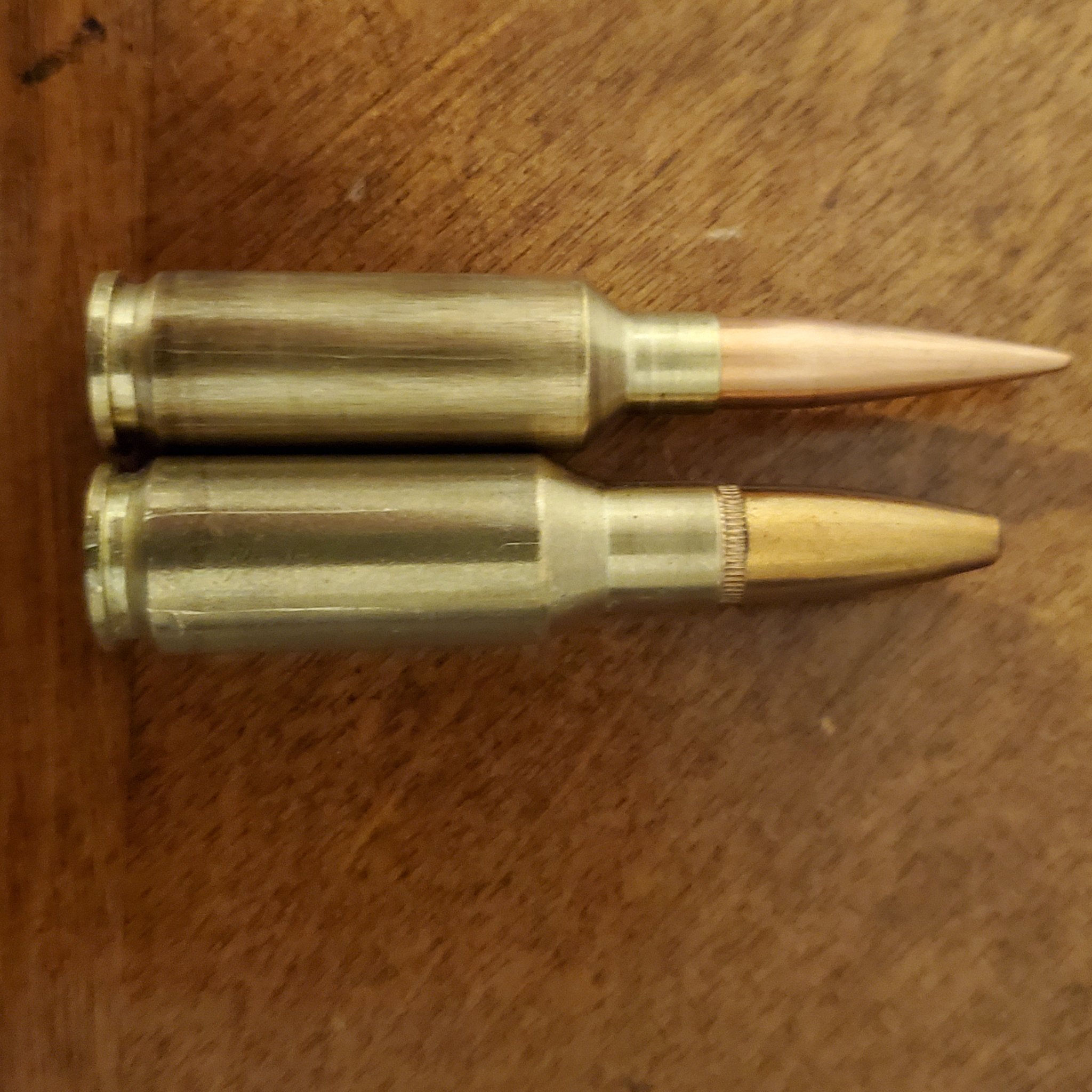

30 RAR is a great little cartridge. It just needs some extensive magazine development and would really benefit from being done in .257”, 6.5mm, .277”, and maybe 7mm. It would do well with a larger magazine well in both axes. As it is, they made a new upper for it with larger extension tunnel that is AR-10 sized, with an AR-15 outer form factor and AR-15 bolt carrier raceway.
From an industry/production standpoint, it was easier for DPMS and Remington to make a small frame .308 Win that already has decades of magazine development, without any need to encroach on the ammunition production SKU schedule.
Reactions: bfoosh006 and 45-90
There are alot of ways to improve on the AR 15 platform.... if it was only dimensionally a bit larger, with 308 bolt and barrel extension.
But the whole industry would have to adapt to new cartridges with higher performance.
The 30 RAR uses 450 Bushmaster mags, no alteration needed, feeds 100% , limited to 2.3" COAL.
Necking it down to 22, 24, 25, would give the AR 15 platform more power, just as it is, without the alterations.

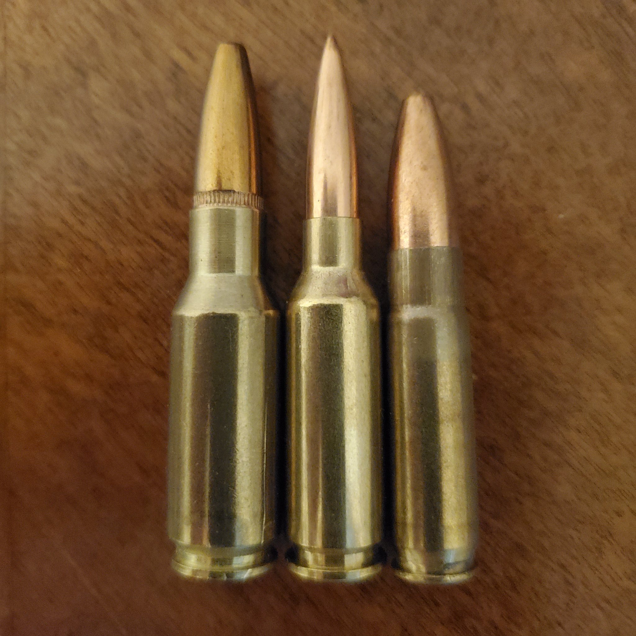

30 RAR in 450 Bushmaster mag.
30 RAR, 6 ARC, 300 BLk...for comparison.

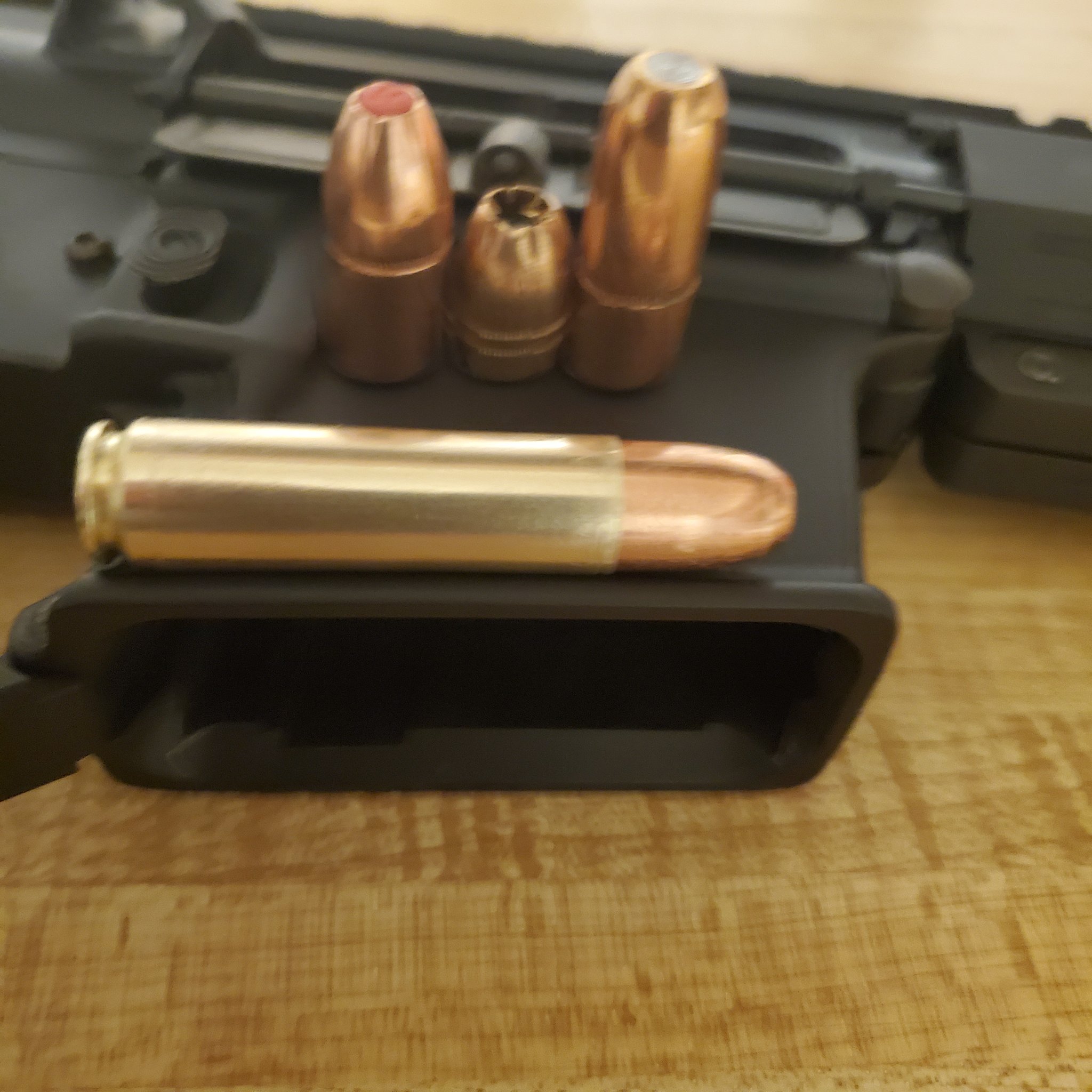

I was thinking in a double stack magazine, which may or may not be desirable.
If I was hunting in dangerous game area, I would want capacity and want it to run reliably.

All that is allowed is 5 rds for hunting in autoloaders for big game here.
If serious dangerous game were on the menu I'd just go with the fast 16 twist 450 Bushmaster and 5 quick shots of 502 grains plus 1 in the chamber. Or resize any .458" bullet to .452" for close range smack down, this is hard to beat from a standard 16" AR.
But a 6mm X 30 RAR Ackley would be interesting...

After rereading this thread, and there is a ton of great info in this... a few more suggestions come to mind.
How snug is your upper to lower fit ? If it is loose, it might result in failure to wield the AR consistently. Especially if you "fidget" while shooting those 10rd groups. So after settling in at the bench, don't move... no resetting the cheek, no shifting the shoulder contact, no shifting your butt ....nothing....etc.
Make sure your parallax is set properly.
And.. If these are the bullets you are using... https://www.midsouthshooterssupply....at-tail-hollow-point-with-cannelure-250-count
Try the Sierra Match Kings.
The above linked 77gr bullets, "might" be the "New" Hornady 77gr OTM's... and the link above photo sure looks like the Hornady 77gr OTM. ( Cannelure placement, and depth, and just eyeballing it )
FWIW... https://www.ar15.com/forums/ar-15/F...-/16-787367/?r=-1&page=1&anc=8678440#i8678440
  • Love
Reactions: sinister
Wow only one person posted actual target?
100yrds 10rd group in the middle. Rest were 5 rds. Basically 1moa and could probably get a hair better in sub moa category if practiced enough.
Scar17 + hand loads
Oddly enough I did go shoot today and got 1.5moa for 10rds of American eagle 55gr. Its a green mountain barrel rifle I put together that was giving me issues until I realized the flash hider was loose. So 1-1.2ish with handloads should be possible which would be fine for it.
Ought to get better then that with hand loads being there’s no recoil with that
Like this ^^ . Let’s not be a hypocrite
When your woman wakes up and texts you your colon smelled good. See how spelling is important?
Offended I did not like your group picture? OP asked for advice on his situation and all you posted was some half ass groups. Offer something of importance to the discussion next time.
Half ass group? A ten shot 1.04” group with a semi auto is half ass? I don’t care if you don’t like my pic. I figured OP was asking to post groups. I’d imagine fundamentals play the most important role on producing consistent results…
How was your barrel installed?
If your expectations are to shoot 10 rounds into MOA or less.....
Your upper receiver should have a square face and tight barrel extension tunnel, which are pretty standard for BCM, but I would prefer a different upper and handguard combo than the one you have, even though both of those companies are great and staples for me for other things.
Use an upper/handguard combo that doesn’t touch the barrel nut. LaRue, Seekins, and Ridgeline Defense make upper/handguard combos that fit this description and eliminate contact between the barrel nut and the handguard.
If you really want to achieve this, have a precision rifle builder or exceptional machinist true-up your barrel nut, barrel extension, and bolt so there are no variations in squareness of lug engagement and bolt face orientation to the chamber.
Consider using a match bolt carrier with adjustable guides on the tail so the carrier stays almost perfectly true inside the raceway and RET as it cycles.
Bed the barrel into the extension tunnel either with a thermal fit or Green Loc-tite.
Since your barrel is a heavier profile, use less torque in the 35-40ft-lbs region to where it "feels dull", not like a tuning fork when you tap on the barreled upper. You’ll want the mating of the barrel and upper to be dampened, not resonant. If the barreled upper resonates like a tuning fork, it will encourage more deviant harmonics that will increase the likelihood of larger grouping.
Make sure your muzzle device has little or no torque when installed, as this can slightly warp the last .625” of the bore. Do you have a Mk.12 collar brake for the AEM suppressor?
To chase extreme precision with 10rd groups, it might be better to get a heavier bull profile barrel, a Bartlein or Krieger, turned and chambered by one of the few people who know what they’re doing. Use a longer gas system and tune the gas so that you have reliable function, but not such secondary reciprocating mass effects that the rifle breaks your position with each shot.
If you can find one, get an Alexander Arms tri-lobal firing pin that doesn’t drag inside of the FP channel like a normal AR firing pin.
If you can’t find one, you can use a JP Titanium FP, but just understand that Ti FPs don’t hold up to high volume well without special surface treatments. They are notorious for pitting, and then piercing primers. But for limited sessions, it will help reduce lock time.
Use balanced torque on your ring fasteners and cross bolts on the scope mount. A torque wrench will help you measure each fastener torque value and ensure each is the same.
Use a Geissele High-Speed National Match trigger adjusted so it doesn’t double on you.
Use a Magpul PRS stock with the cheek piece set up so you have no facial muscle twitching or need to adjust your head when behind the scope.
Do what Sinister said and ditch the bipod supported position. You’re already doing well with that as it is.
Get a Bulls Bag and tuck it up close to the magazine well, with the handguard nestled into it really well.
iu
Use a good rear bag that allows you to adjust, but maintains good stability on the back end.
Load the Sierra 69gr SMK on top of Varget using CCI 450s, Rem 7 1/2, or Fed GM205AR, in weighed and sorted Lapua brass, all uniformed.
You’re basically going to need to build a rifle specifically for shooting extremely tight 10rd groups.
The above formula will get you on your way to chasing that in the AR-15.
