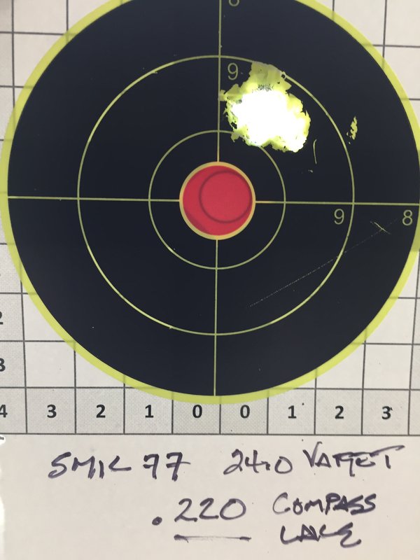

Can't say enough about getting a good barrel; I prefer cut rifling given the choice. Krieger, Satern, etc. I have a Geissele Hi-Speed trigger in my tack drivers, best trigger Iv'e used. While it doesn't do anything for accuracy, I like the JP Ent. FMOS BCG's, super reliable and slick as goose shit even when dry. FF the barrel of course and remember to save some for a good optic, that's gonna be the singular most expensive part probably.

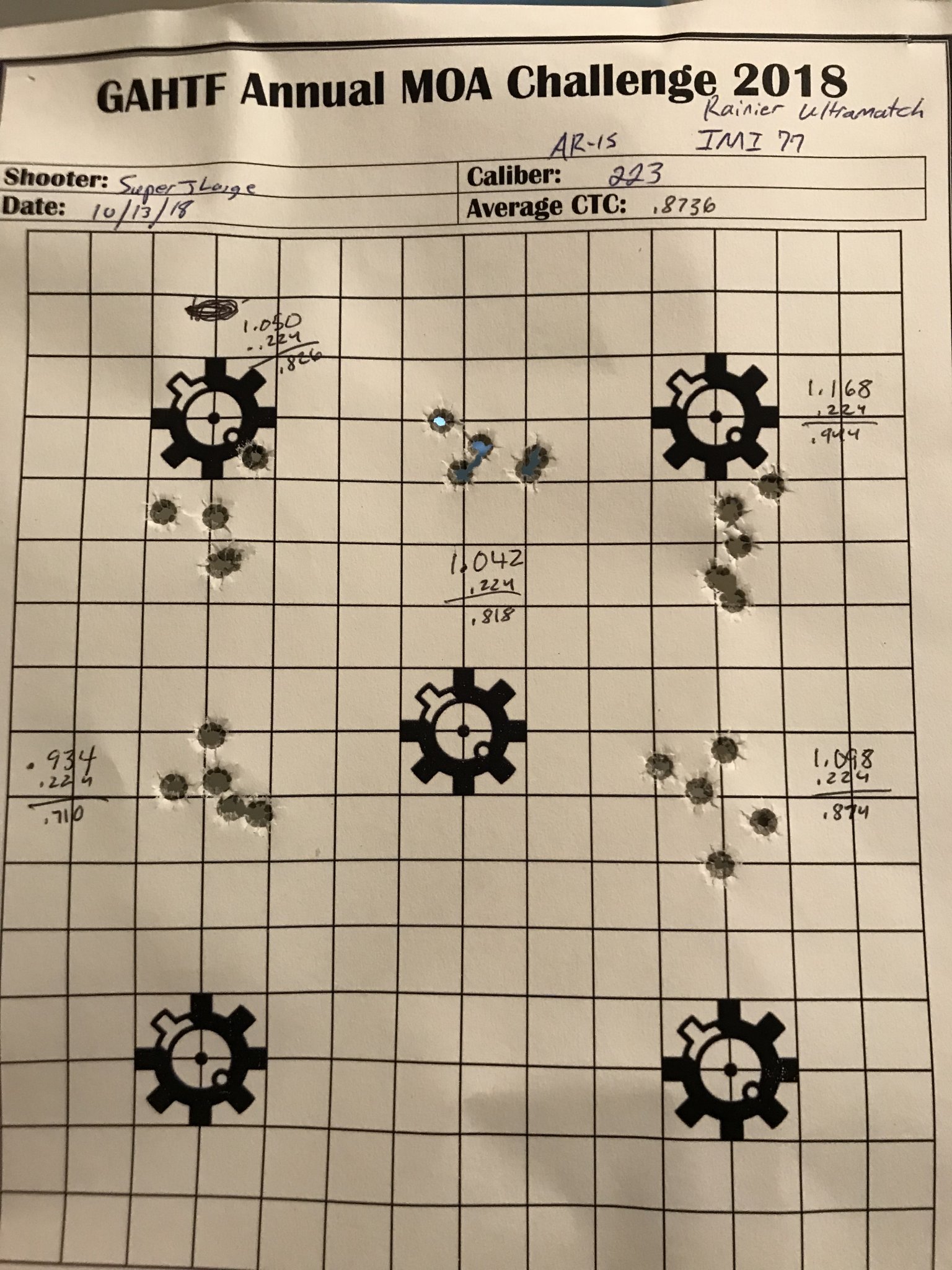

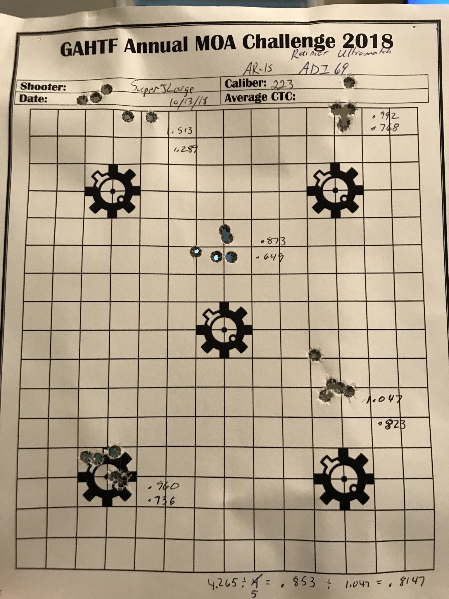

I’ve been very pleased with my Rainier Ultramatch barrels. These 2 groupings were fired back to back and shot in under 10minutes per string from a bipod and small rear bag. The ADI did good aside from the first round from the mag on a few groups, and the top left group where 2 lots of ammo were used. The IMI wasn’t bad for cheap 5.56 pressure 77’s.

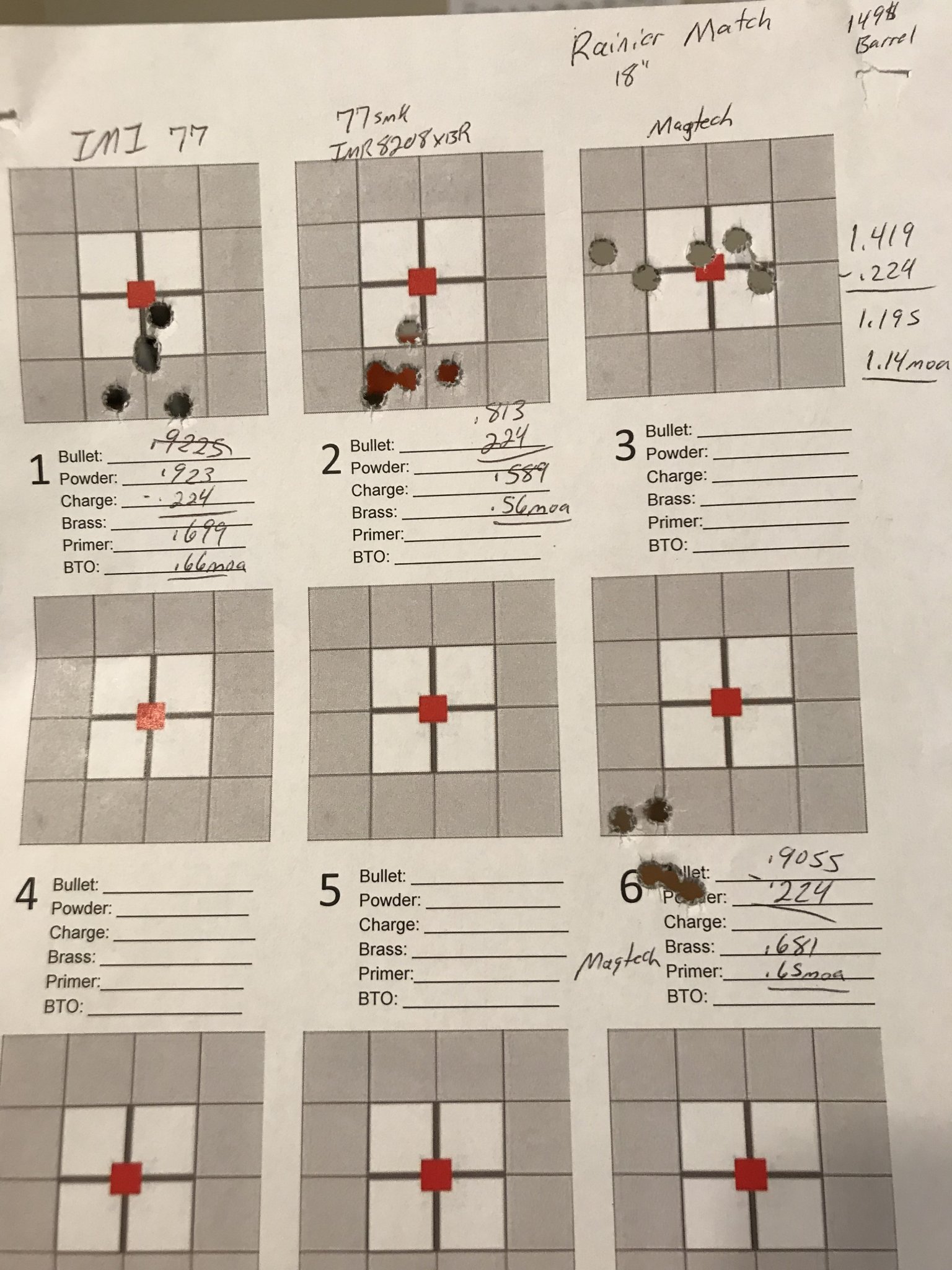

Rainier Match (Black Friday barrel) that I tested yesterday. Didn’t have a good test on the first group of Magtech, but I went back to the triad rear bag for the follow up group.
Very happy with it for the price.

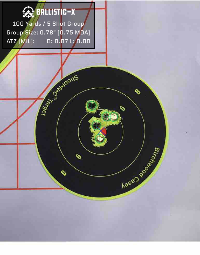

and since everyone is posting groups, here's a 10 shot@100 one MOA Group
and a 5 shot@100 SUB MOA group
