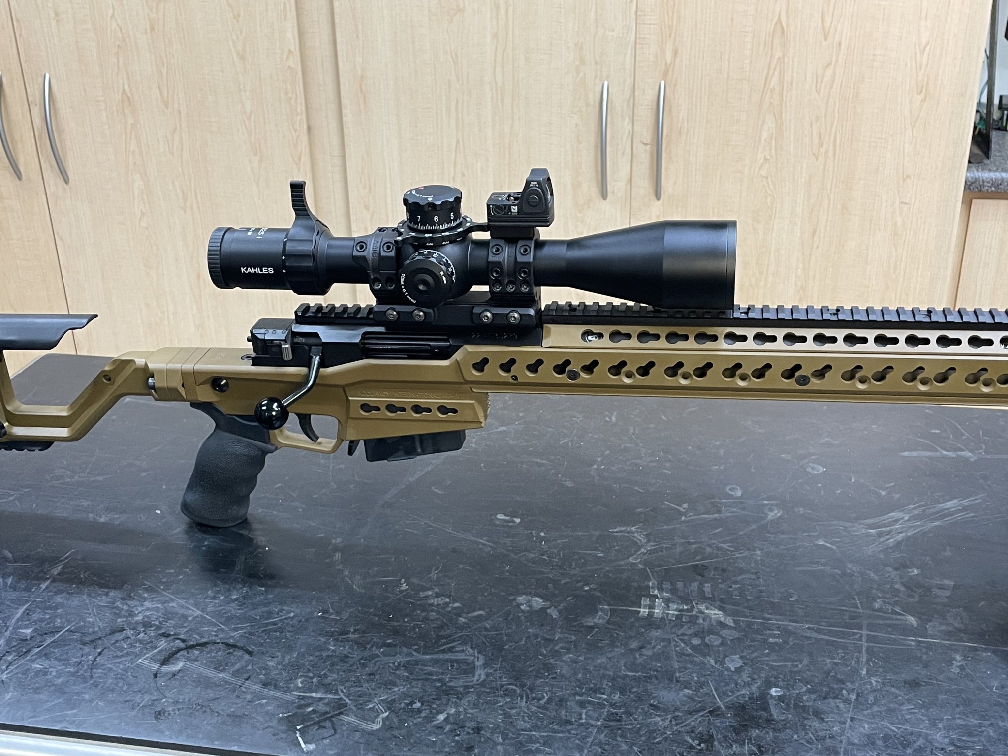

Using some form of Tyler Kemp’s vertical AR grips across my precision gassers. Tried a MDT Elite too, but it was just…a lot.

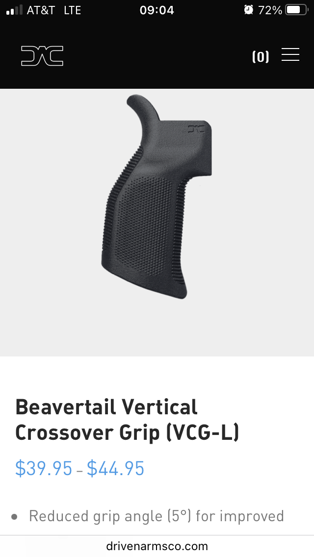

Driven Arms
Reactions: stoweco
The picture doesn’t quite display how ‘hand-filling’ the palm swell is. I use one on my carbine. The bottom cantilever makes a huge difference in leverage for controlling the muzzle.

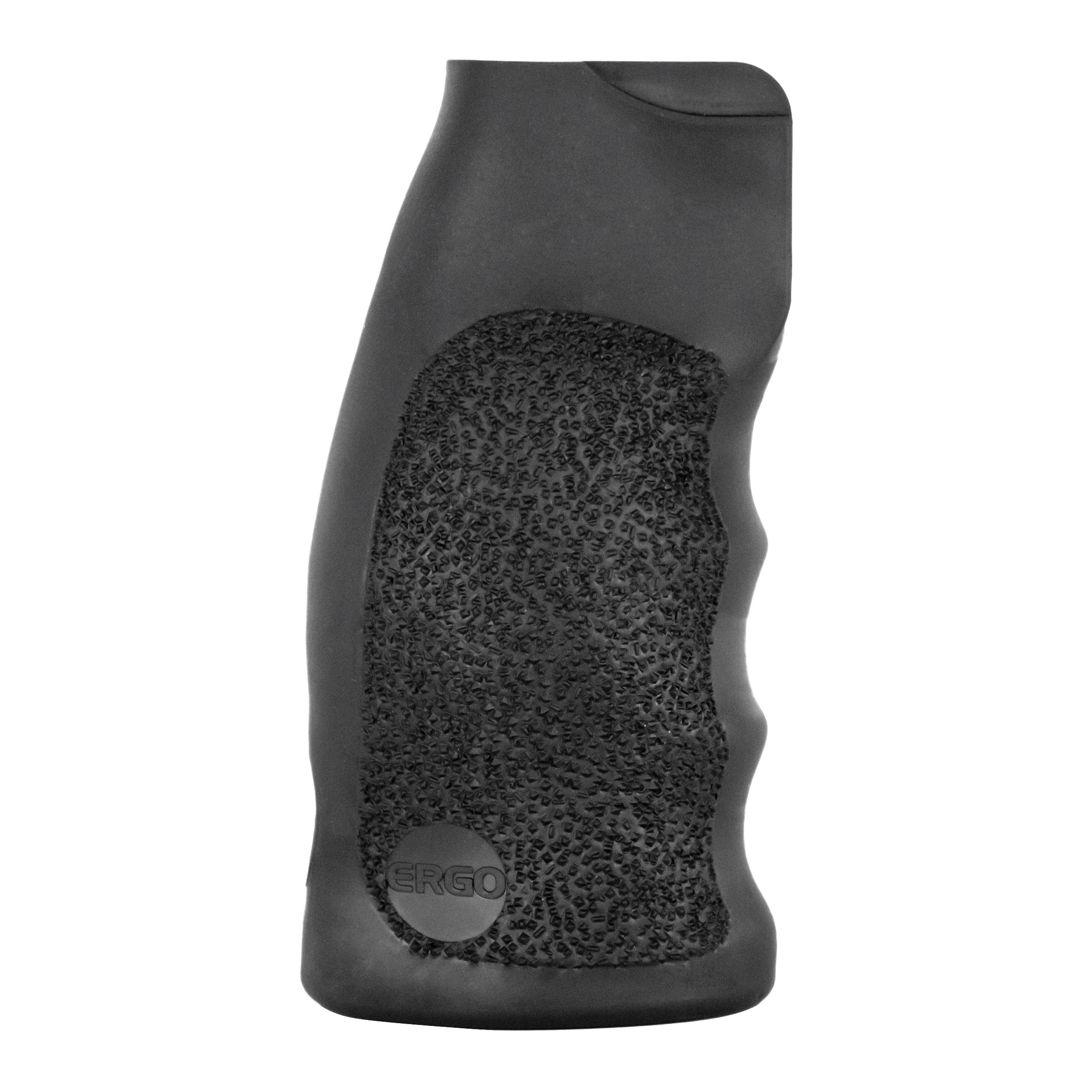

I like the standard AR grip angle. The ergo tactical deluxe is my favorite grip for its palm swell. It works well for running your hand thumb on the shooting side of the grip and indexing on a 45 degree safety lever to use as a thumb shelf.
I’ve got a practically new 90 degree tactical deluxe I don’t need anymore I was going to list eventually if you want to give one a try.
