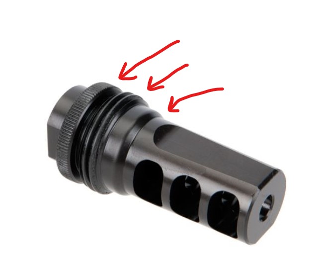

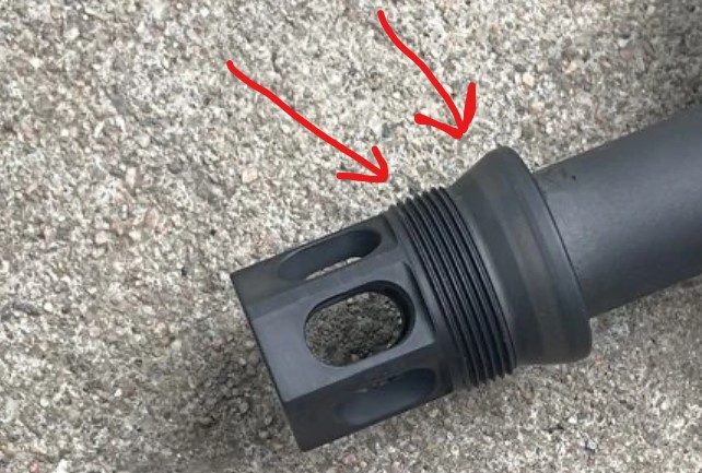

Sure - taper and thread refers to muzzle devices (adapters, flash hiders, brakes, etc.) that stay on the barrel more-or-less permanent, and provide a mating system for a suppressor to attach to said muzzle device instead of the barrel's threads.
For an example, here's the taper and the threads on a Plan B system:
And on the TBAC CB system:
Note that Plan B is Taper in front of thread, CB is thread in front of taper. I like the idea of taper first to keep carbon out of the threads... but I'm a few thousand rounds into the CB system and have never been unable to just snap my wrist while holding the suppressor to break any carbon and remove the can after a match. So, while in theory I like one way, in practice I'm using the other and doing great.

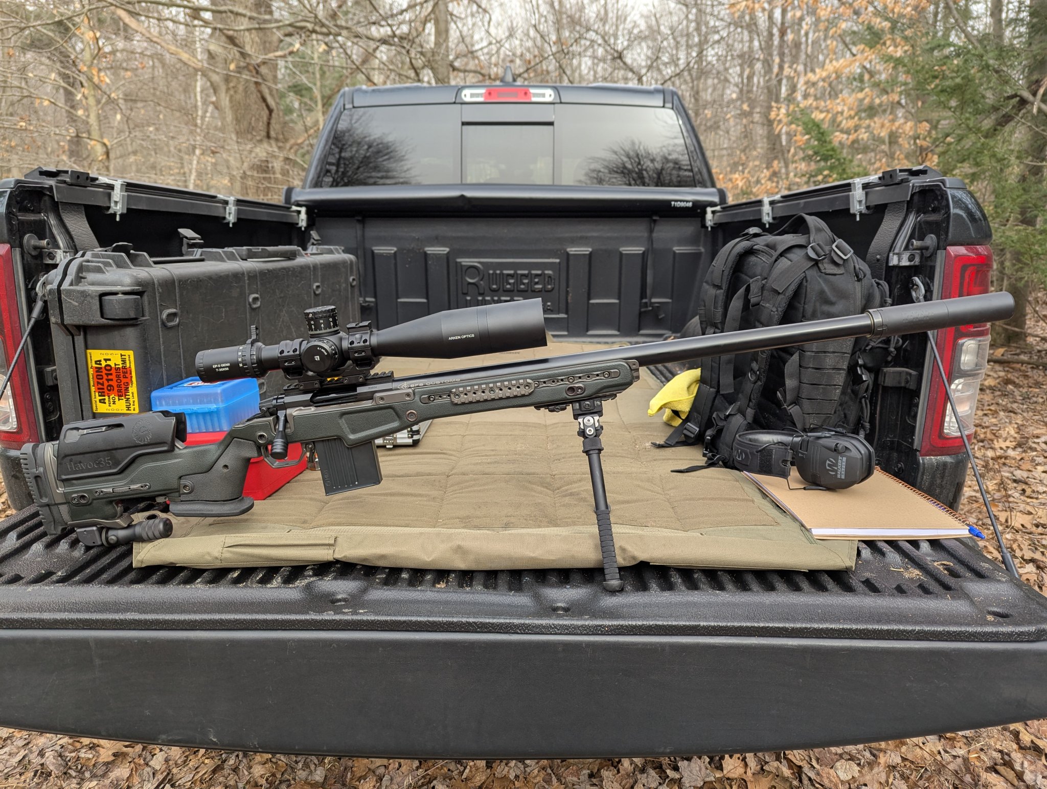

Just wanted to post a quick update and say thanks to everyone for the suggestions and advice.

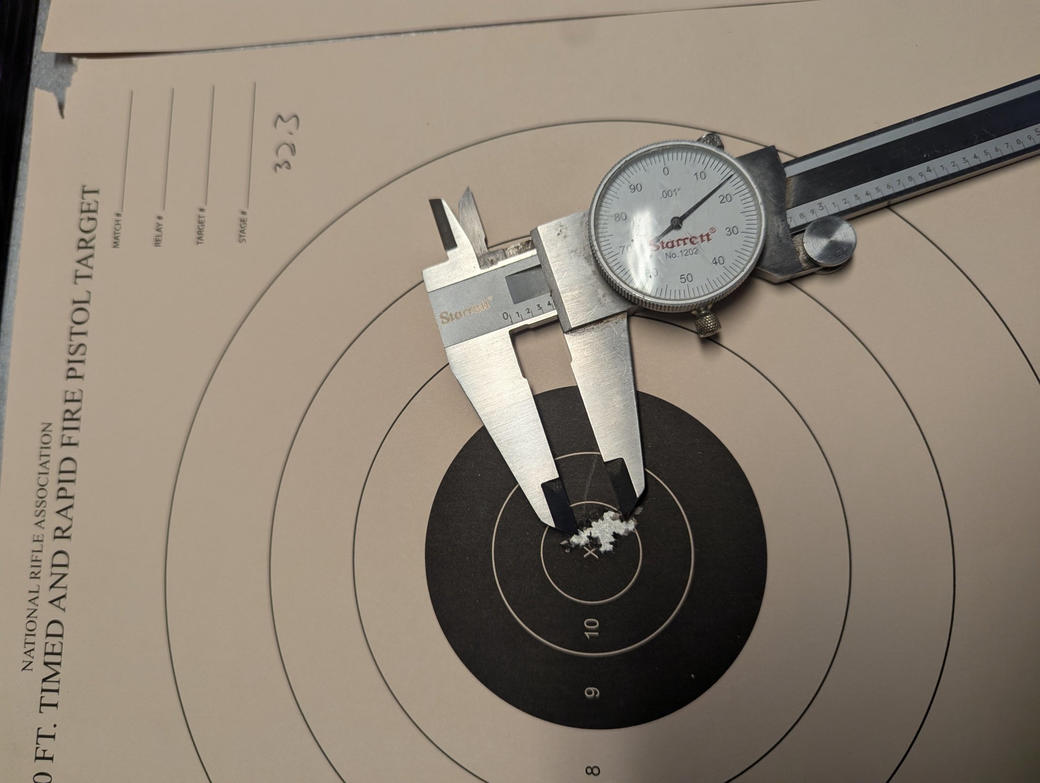

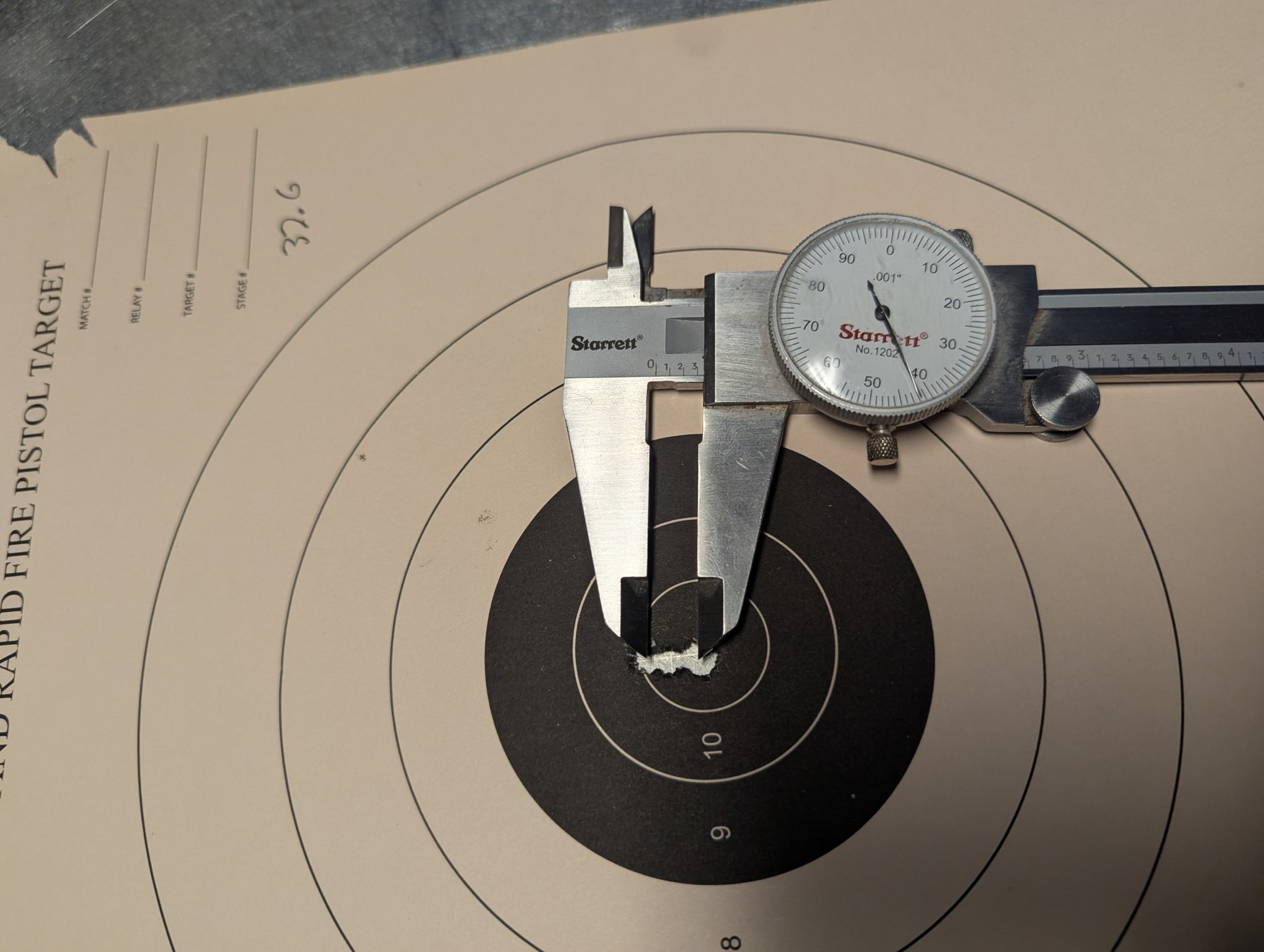

Shot the first 50 rounds through it today to do some break in and load development. I'm completely shocked by how well this gun performed with pretty much everything I put through it. I'm extremely happy with the build.
To give a rundown on the gear I ended up with...I stuck with the original JAE stock, its part of why it weighs over 23 pounds but it should do for the rest of the year. I used Area 419 for the scope mount, suppressor mount, and muzzle device (hellfire). I'm very impressed by that company, I work in the tool & die / automation industry and have a lot of respect for the quality vs price point. I went with Arken for now until I'm a more competent shooter and know exactly what I want after I shoot for a season. That being said I think its pretty incredible for the price, I had an SFP NXS a few years ago and I feel like its just as good if not better. That being said it was a pretty overcast day today. I bought the new rough diamond TriggerTech too but I still dont have it unfortunately...tariffs and all.
Reloading...went with Redding type S and am happy with it. Stuck with my XL750. Bought a FX-120i and really like it, bought direct though and it didnt come with a calibration weight...that was a bummer. Shooting the standard 6 Dasher setup (Alpha brass, Varget, Berger 105 hybrids) Shot in .1gn increments from 32.0 to 32.8gn, 5 rounds per. Every group was either sub .5 or just above .5moa. Starting .015" off lands but I have no idea how to "fine tune" this. Once you hit your ideal cartridge setup you play with the gap and see if your muzzle velocities / groups improve?

First: Congrats! Shooting 0.5's over and over again means that I have zero concerns about torque, pretty much everything in that system is at least in the ballpark of correct.
Your average velocity and standard deviation numbers tell a few different stories, but it's not all bad. As for the averages, considering you're only 50 rounds into the break in period, that's looking like it'll be a plenty fast barrel - this is great. As for the fact that we see some back-and-forth, though... that's worrisome, because all things equal, more propellant nets more velocity. I start to worry about the statistics and sample sizes when I see slower averages after adding more powder, and we might be chasing ghosts a bit with regard to some of those standard deviations for the same reasons, as well. Out of curiosity, which chronograph are you using?
If you wanted a suggestion on where to go next, I'd pick a load somewhere in the middle to stay away from pressure (say 32.5), load up 100, and practice a few different field/positional shooting techniques for a day - we know it shoots good groups, we're curious about how consistent our velocity can be with your current reloading hardware and technique. If your chrono/target/position allows it, chrono each of the 100 shots, and THAT would be an interesting data set to chew on.
Alternatively... load up 100/150 rounds of whichever you like and just shoot the thing some more. You could easily argue that we shouldn't be worrying too much about velocity until it's completely broken in and you've deep cleaned that bore.
Either way, all signs point to a great system, and it'll work great for what you built it for. Congrats again!
