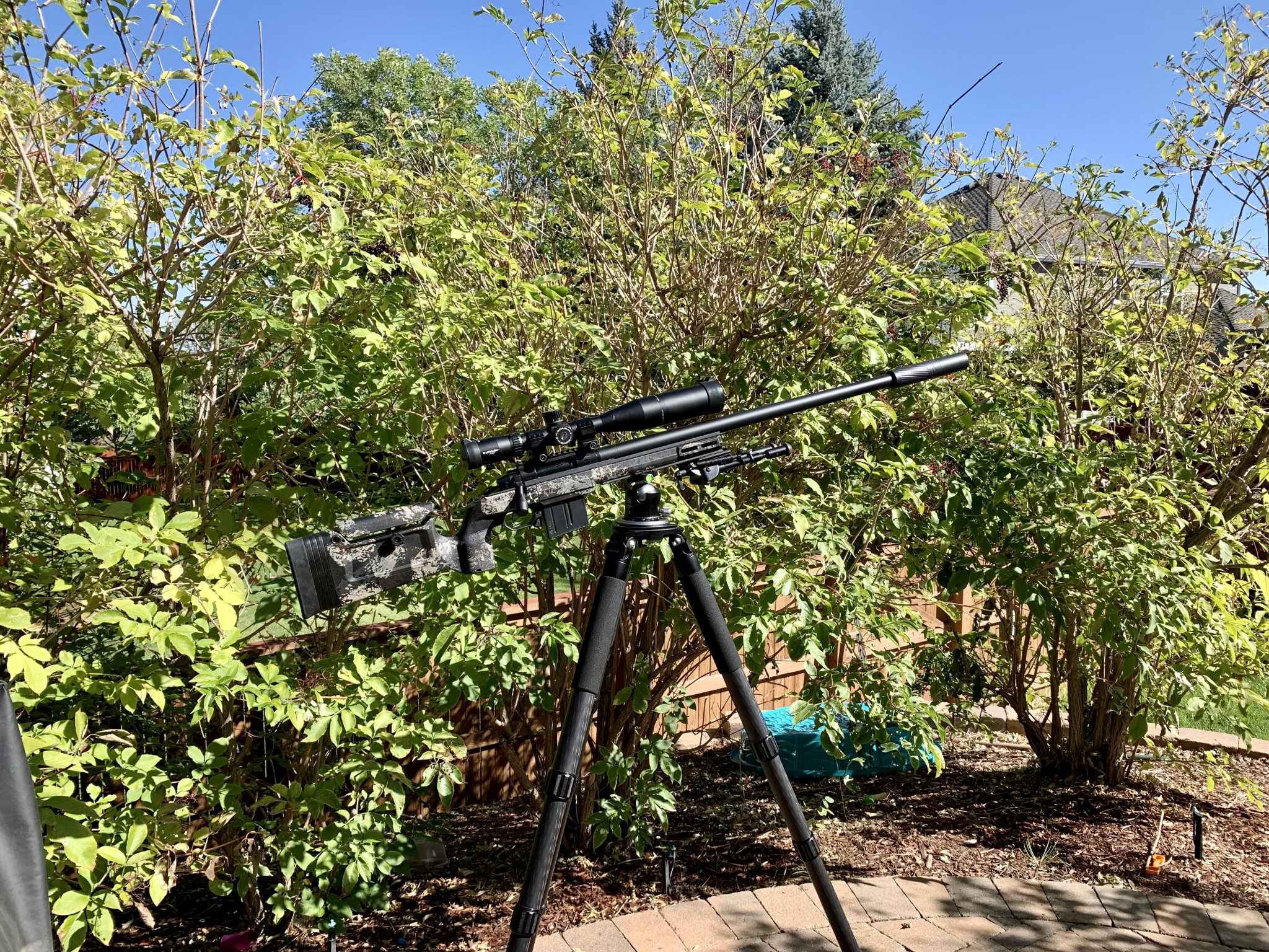

I did as others have reccomended, BigHorn Origin, Proof, TriggerTech, KRG Bravo. Thing is a TACK DRIVER, it is the way to go.
Reactions: Hattrick
That rifle is a beauty! Where did you source the Proof barrel? Was it a blank or did you find one chambered and ready to go? I've been having a hard time finding one chambered and ready to shoot. I found did a good Smith to do a chamber on a blank but he was almost $500 for the work plus the cost of a blank...

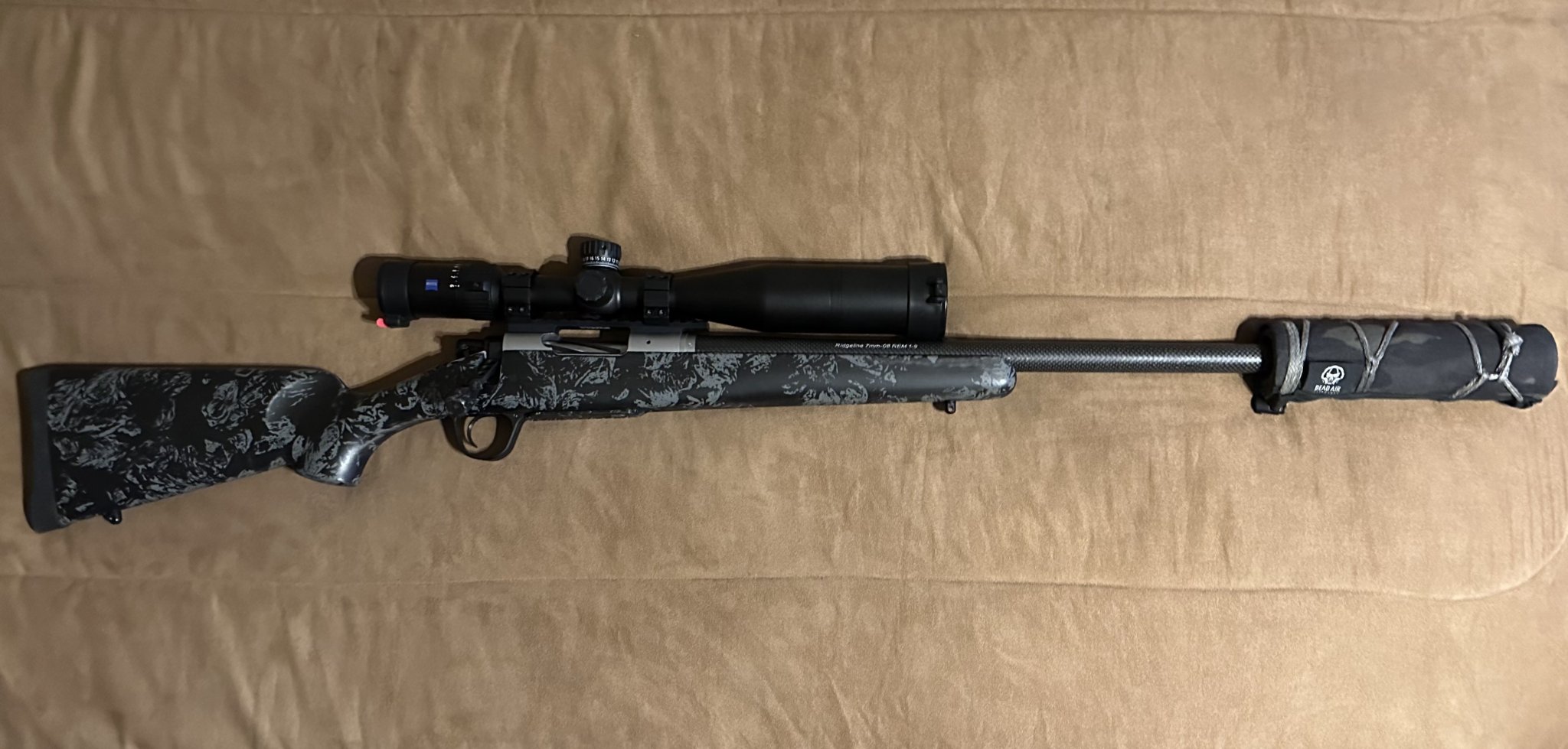

I have a rifle that was built by a fellow by the name of Tony Cannon at one of my sponsors, Doc's Pawn and Gun in Greenville, NC The rifle was a Remington short action that Tony blueprinted. I purchased a Satern M-24 barrel from Brownells that was short chambered in 6.5 creedmoor. I had it bedded in a Bell and Carlson Tactical stock and the rifle is a shooter beyond belief. Factory Hornady ammo. I shot a .187 and my fellow shooting partner shot a .208 with it. I have less than $2k in it and I also have a Jewell trigger in it.....
I also have a tikka t3x tac a1. It’ll outshoot me any day any time and is a fantastic stock rifle.
I have the Bergara HMR Pro and an Altus Defiance custom, both in 6.5CM. The Bergara is a great gun for the money and mine performs quite well out to at least 1000 yards, but it's not in the same league as the Altus/Defiance/Bartlein/MPA. If you are going to spend $2500 I would go custom. There is an Altus built 6.5PRC barreled action with a Hawk Hill barrel for sale here on SH from a reputable seller right now. You can find everything you need for sale on the Hide. You will probably end up spending a little more than what you were originally thinking, but less than what you will spend if you go with one of the stock rifles and then upgrade it later. What are you planning to do for an optic?

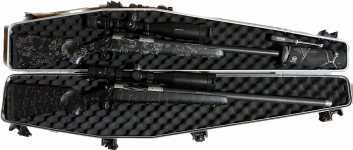

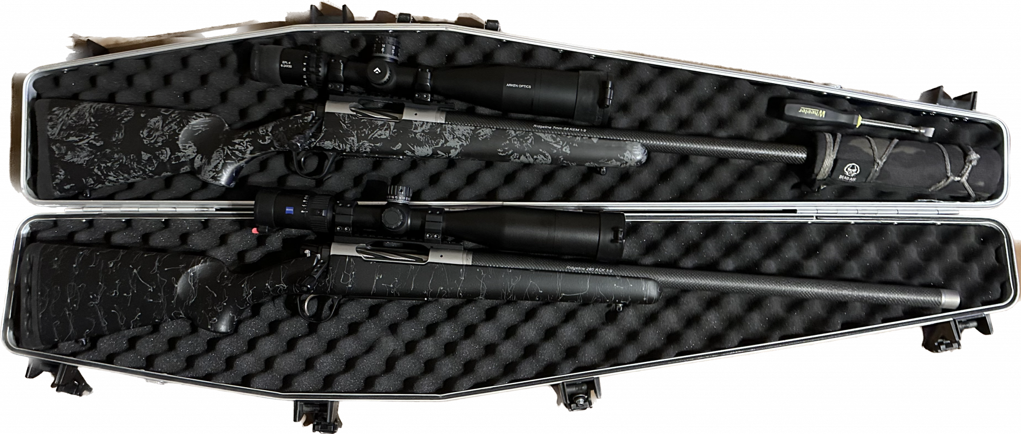

Christensen Arms Ridgeline. Comes with a TriggerTech as standard equipment. MSRP $1999. I have 2 of them, and with handloads, they both shoot in the 1/3 MOA range. You could always sell the stock and put it in a chassis if you wanted, but they’re pretty accurate and lightweight for hunting.
