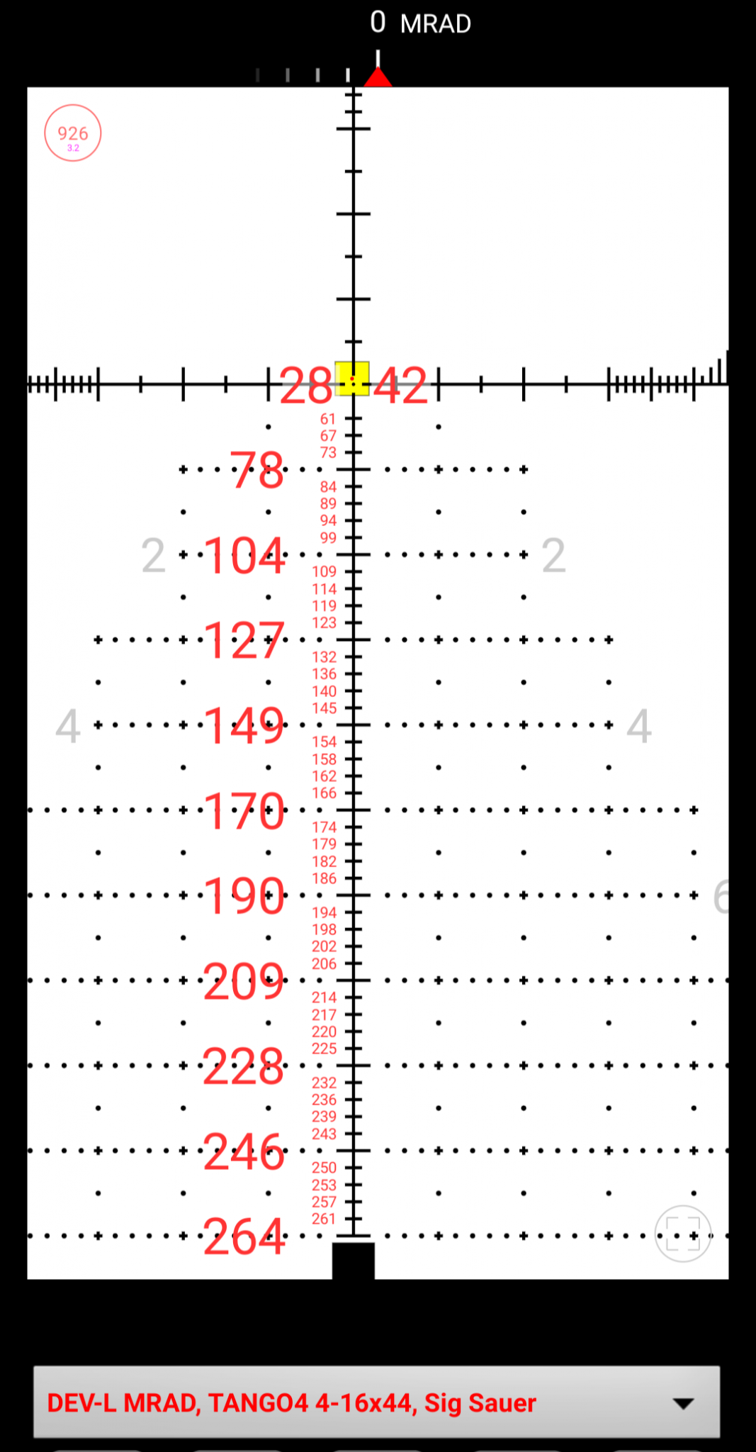

I use a 30y zero to cut out environmentals. My MV is 1119 fps. At 50 it’s a 0.08D dial which my scope can do (rounded to tenth). I don’t have any issues smacking a KYL at that distance even while holding dead center. It’s not enough to make a difference to me at least.

I have yet to find a 35 yard target where I couldn't cover it with the center and .2 up.
This is a .5" square target. Even at .25" you can cover it and get good hits. This is the silly things that you can argue about all day, or just shoot it and get hits.
