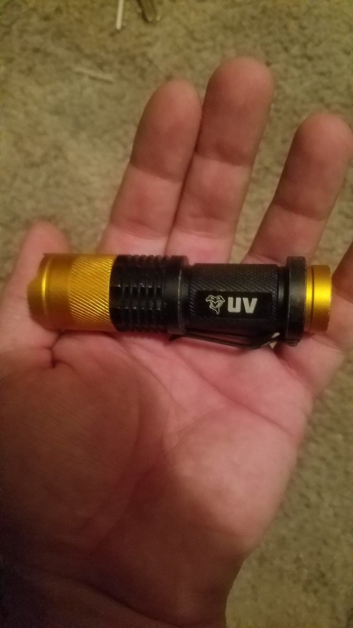

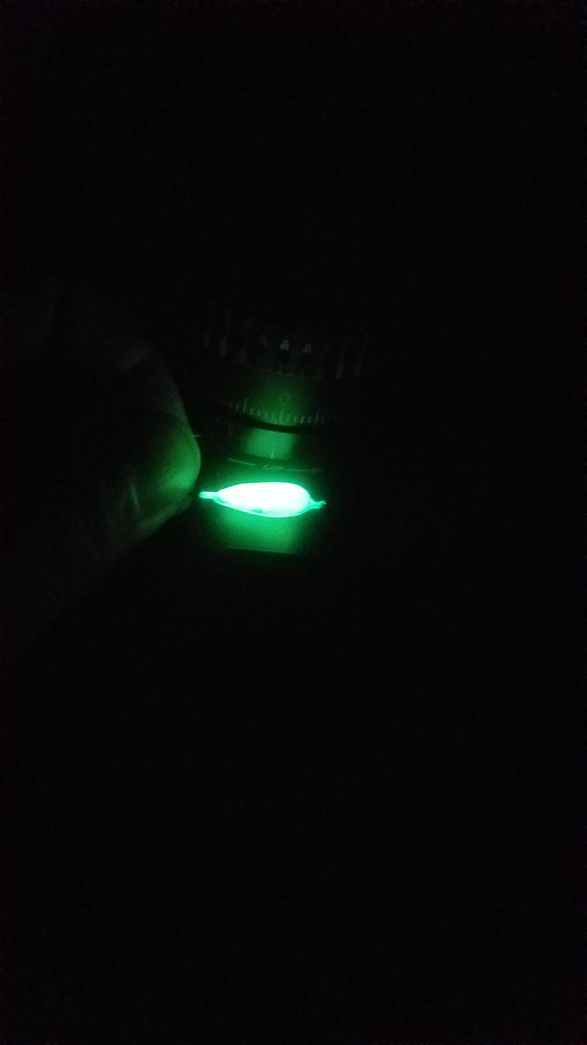

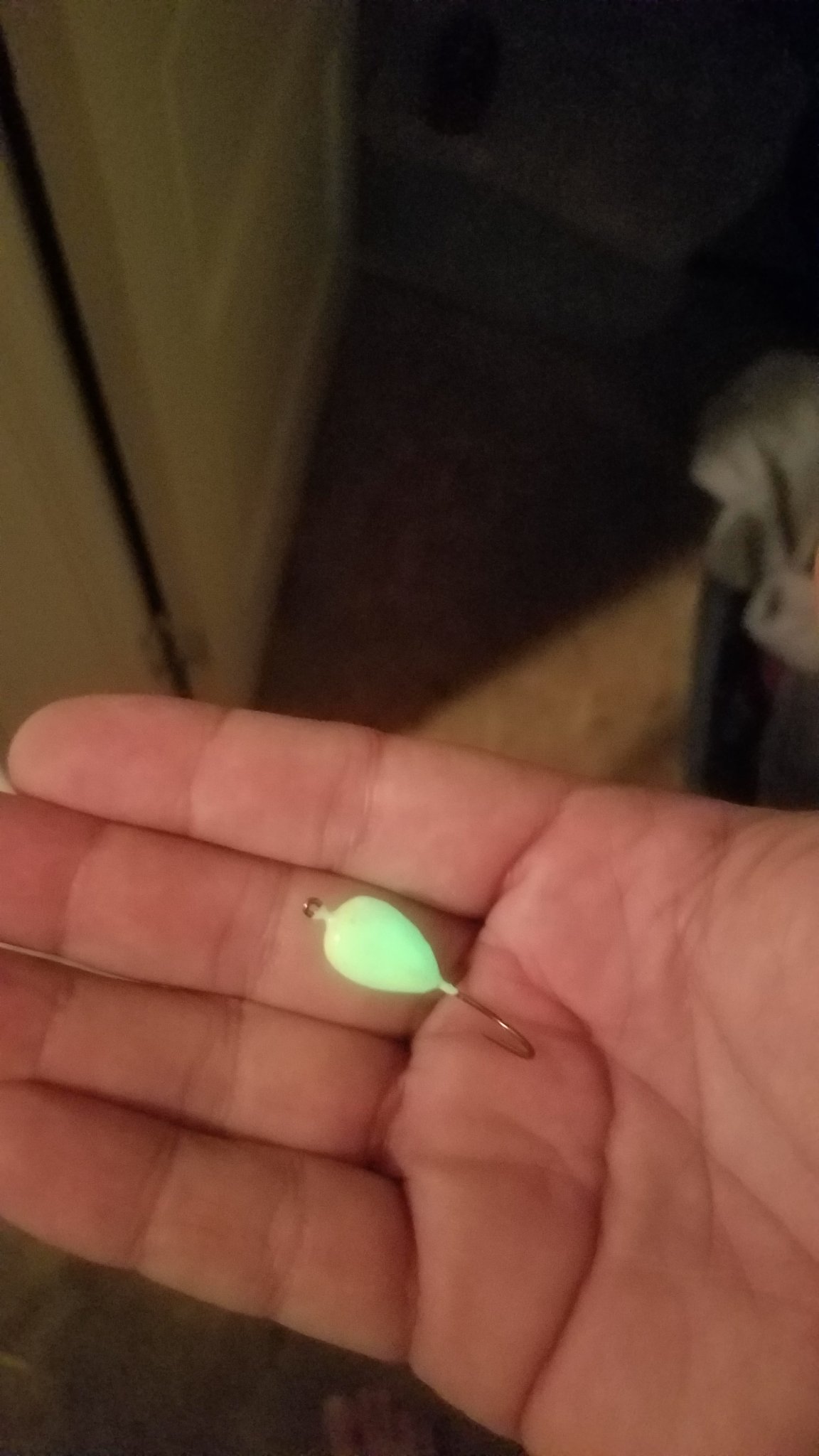

I wonder if you just scotch taped a glow in the dark tungsten fishing jig (with the hook snipped off obviously) to the top if it would provide enough light to see the turret....if that would work.
Then you use a small UV flashlight to make it glow better if it gets weak.
Initial test looks like it would work.
