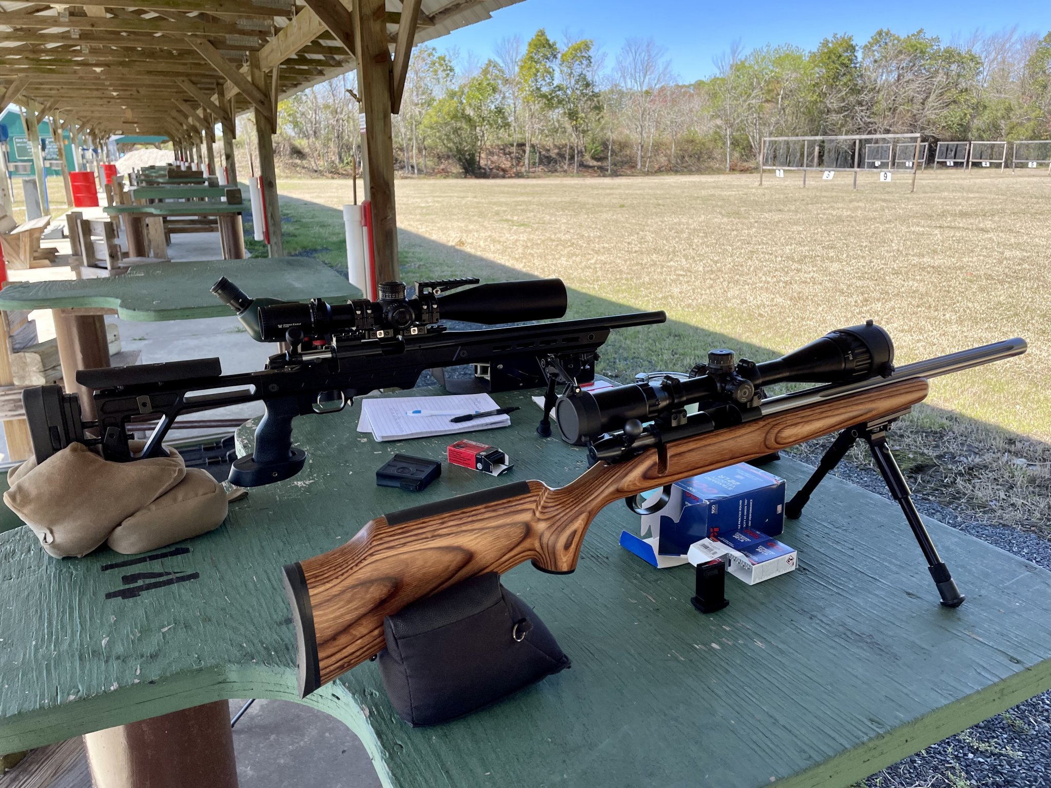

When I got into this game I was running a Remington 504 with an aftermarket 10/22 barrel having a Bentz chamber. It is surprisingly accurate. When my bud ordered his Area419 custom CZ, they fit a fluted Bartlien barrel with a Bentz chamber as well. He has score first round hits out to 500yds, and makes it look easy.
I think the idea was having the semiauto chamber in a bolt gun intended for rapid fire strings would increase reliability.

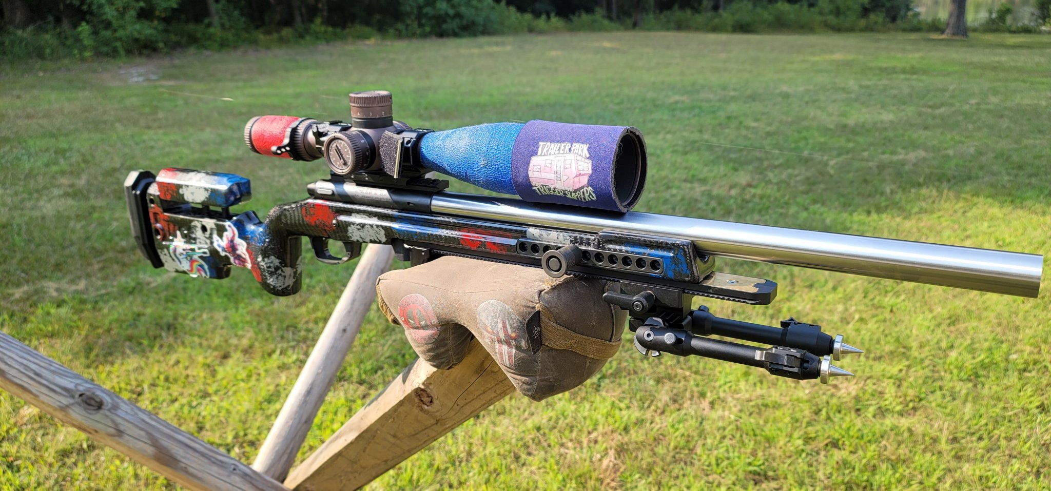

Bergara b14r, running a stainless swan rifle barrel in 9 twist, m40 profile, 22" long. Tac driver. Way better than me
