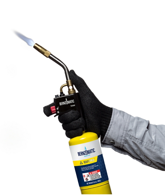

Reccomend the auto lighting head for the torch. Fyi map gas in the yellow bottle is hotter and quicker, a quick couple seconds spin in the fingers before it gets too hot to hold is sufficient.

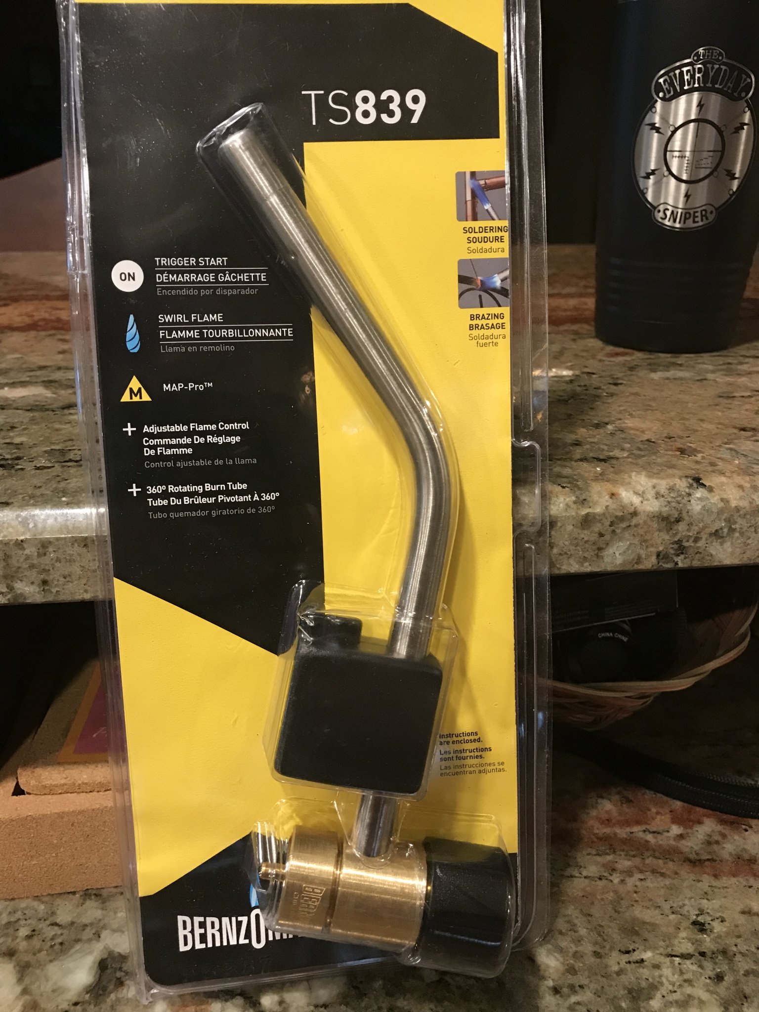

Using one of these on Bench Source annealer. Could set up and use two, but the swirl head provides a larger, broader flame, whether camp gas spares I’m trying to use up or blue bottle propane. Has worked well to date, with a couple thousand annealings under torch.90A3E8E9-C497-4665-A27F-9111576F198B.jpeg
