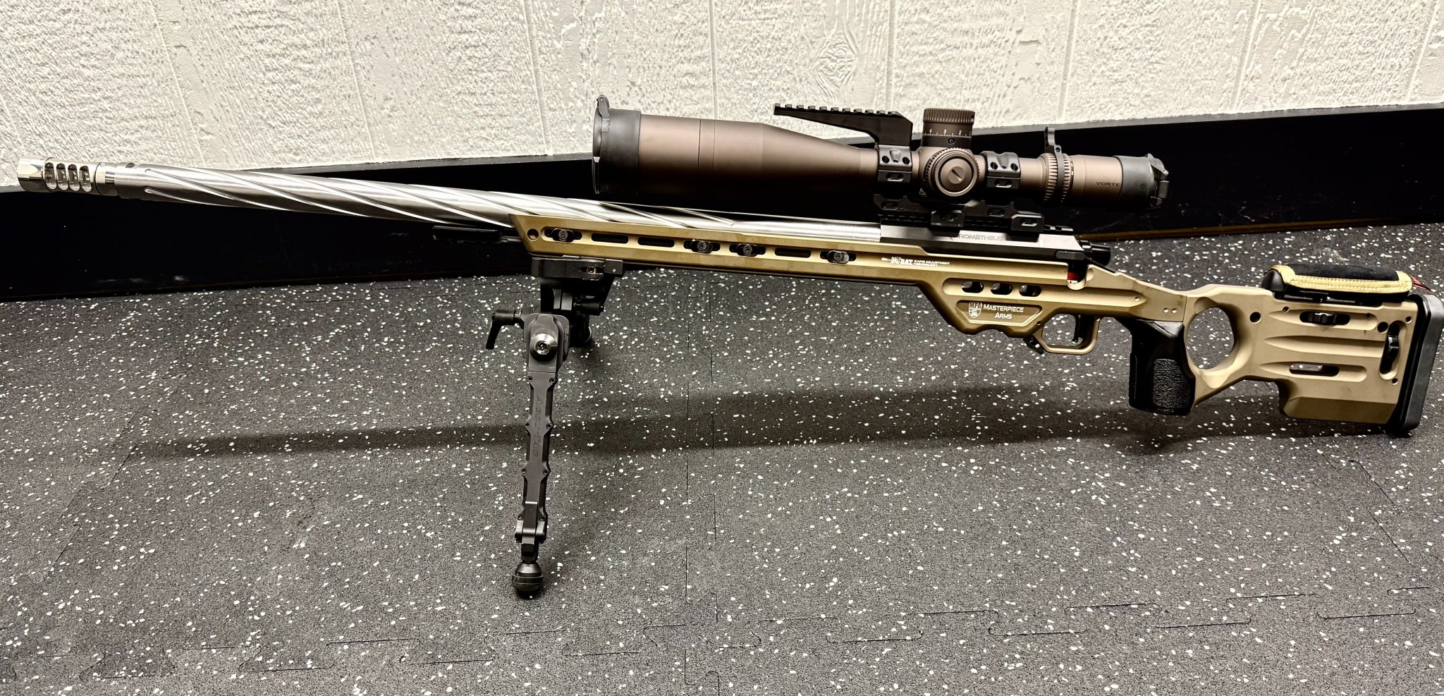

I had a 20” 308 barrel in their .900 taper less contour with a spiral flute pre fit for a Kelby Atlas Lite. It shot .5 moa with 178gr ELD-X and I felt it was a good balance of diameter and weight. For the price I wouldn’t hesitate to buy again.

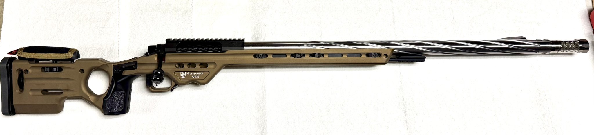

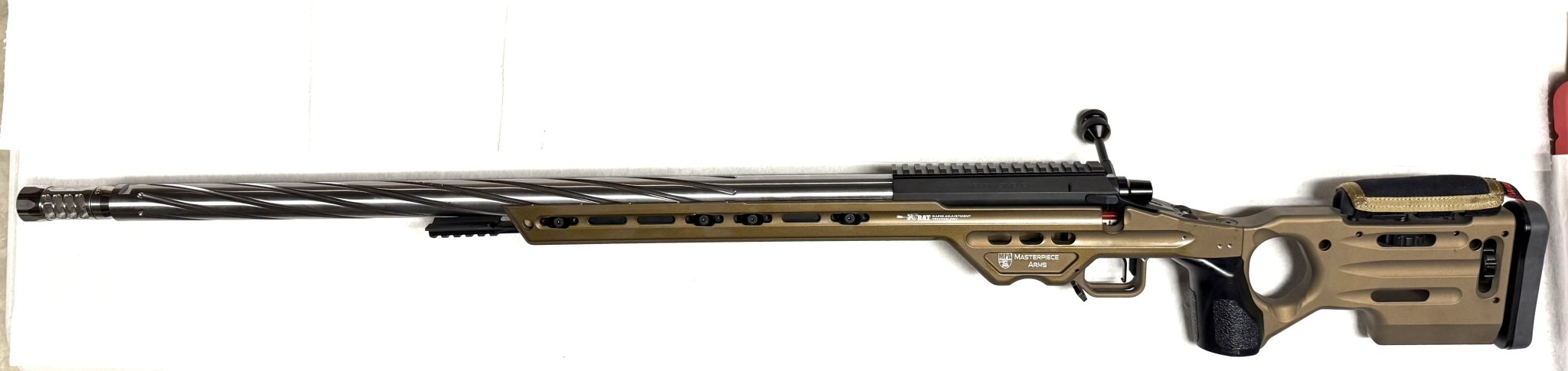

Put a shouldered prefit carbon wrapped 24" 6.5PRC on a defiance anti for my dad. It's in an ALG carbon stock with a tbac ultra 5 on it.
It shoots. It's his long range hunting rifle, it took a handful of loads to get it shooting sub .5moa with eld-x and he has left well enough alone.

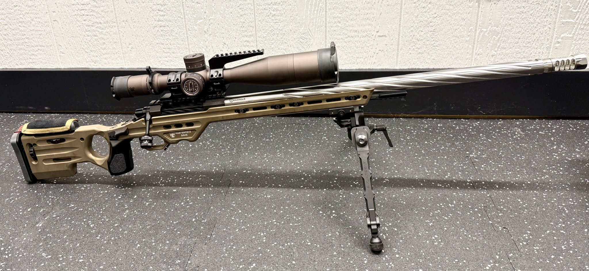

I love their barrels and am about to place another order with them for a short 8.6 build. Good quality, great communication, and the barrel is dead to nuts.
They do a pretty sick spiral flute if you’re into it as well.
Overall, no complaints from here. 🤙🏼

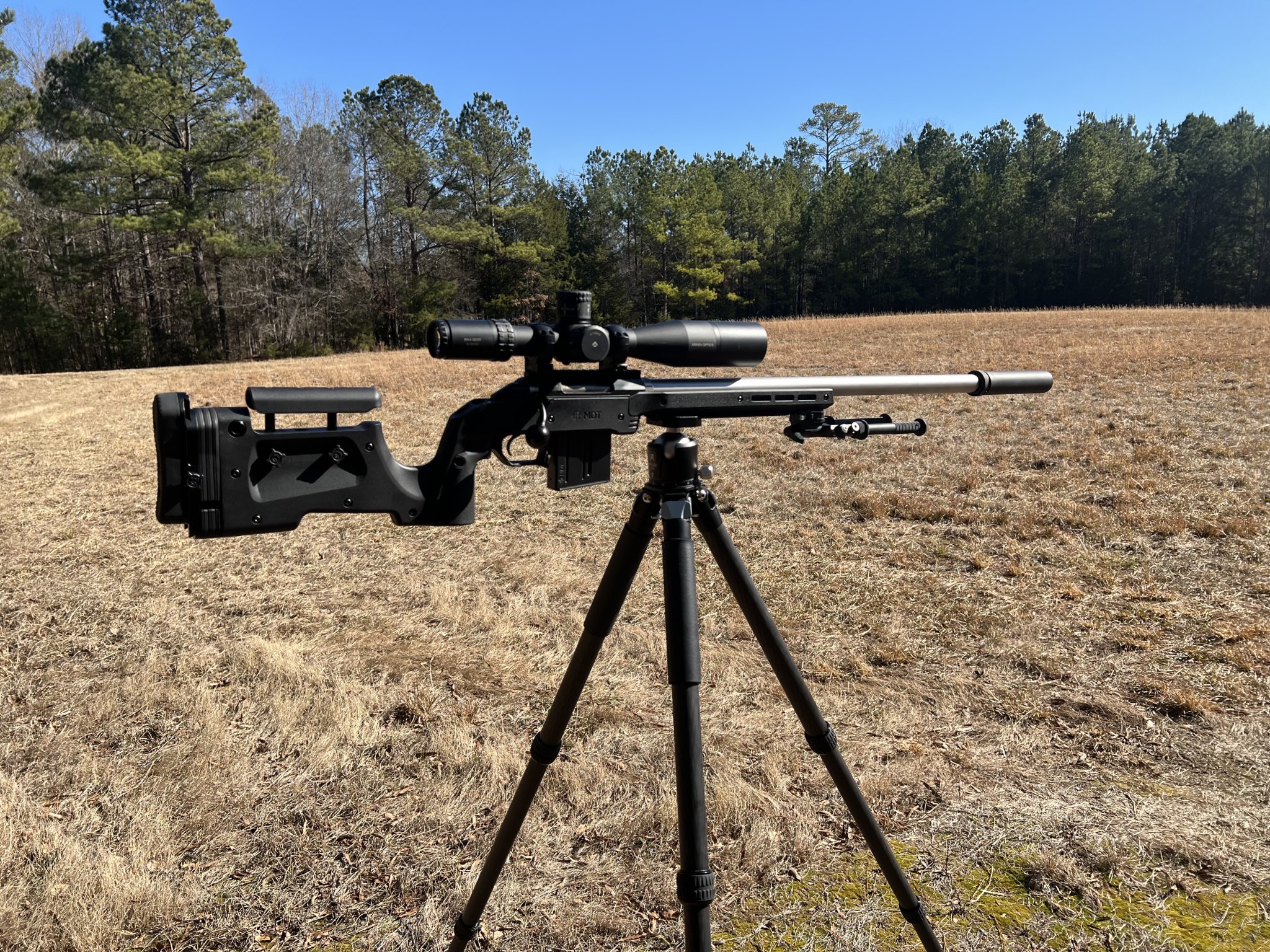

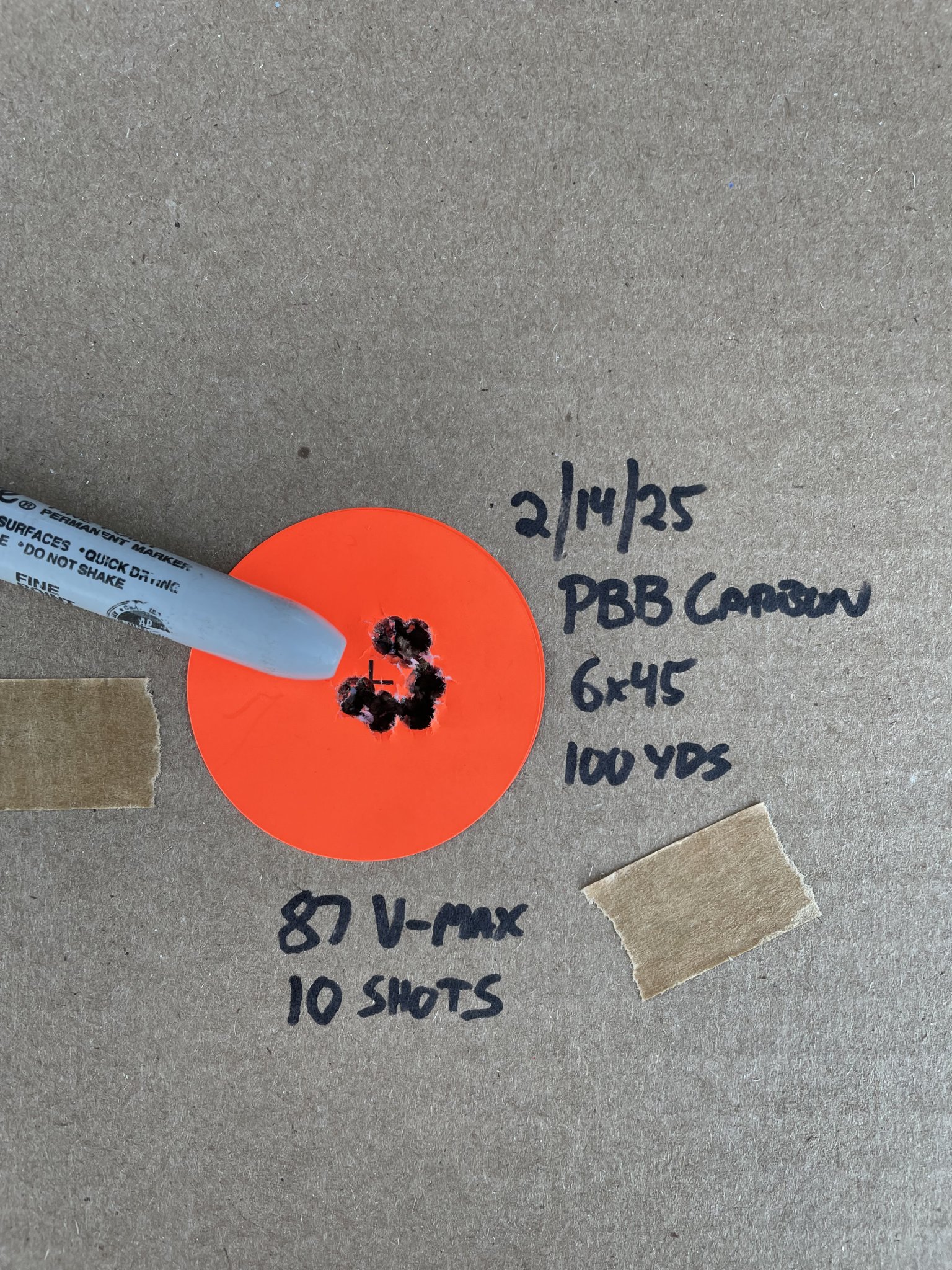

PBB recently built me a Carbon pre-fit for a Definace action chambered in 6x45. I sent them a dummy round so they could set the freebore much longer. The barrel has been great. Not one bit of copper fouling, easy to clean and super accurate. They got the freebore perfect and the headspace is within .001 of the barrels I’ve had done by my local smith.

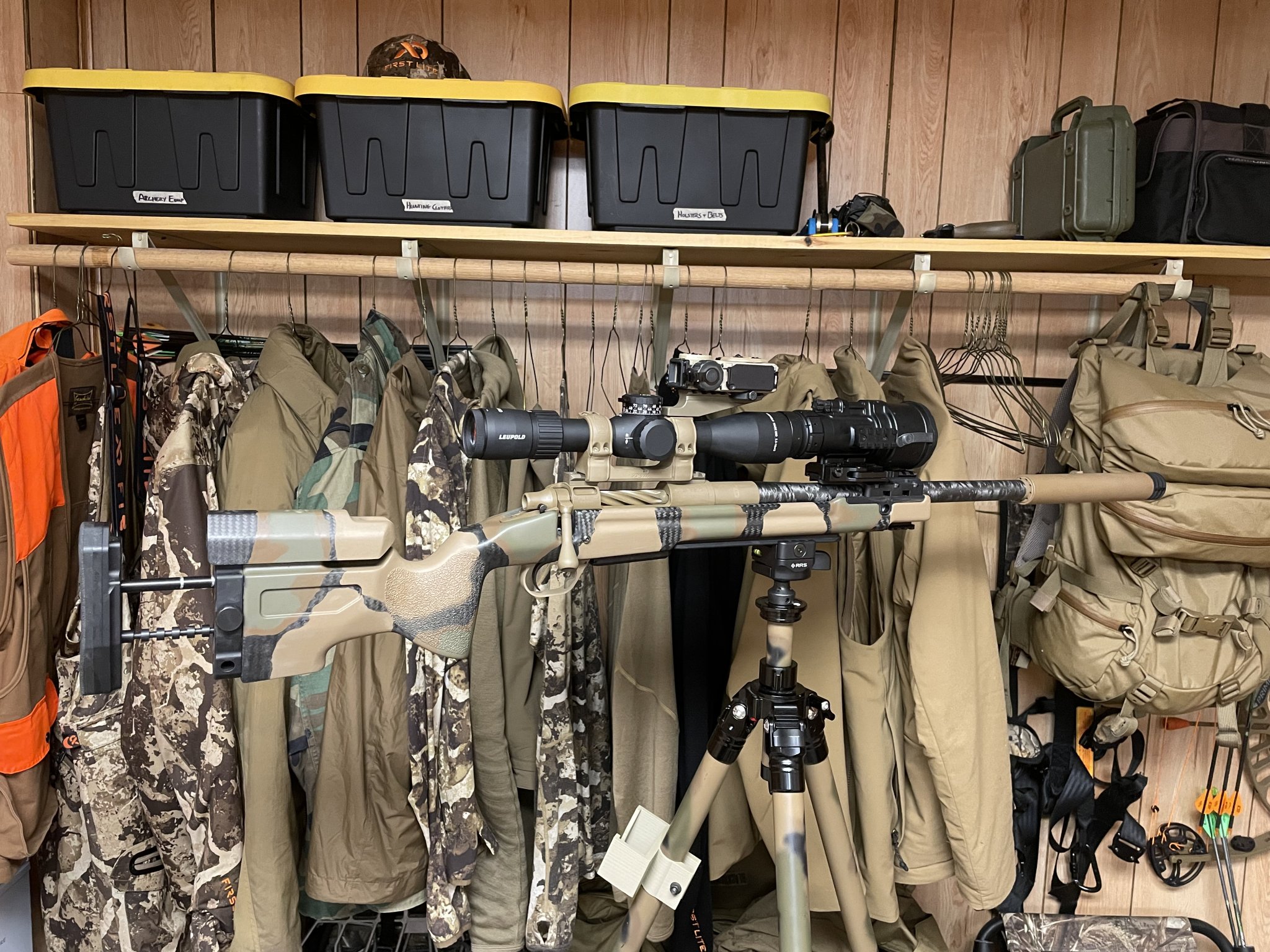

Love that nightstalker. Who did the paint?

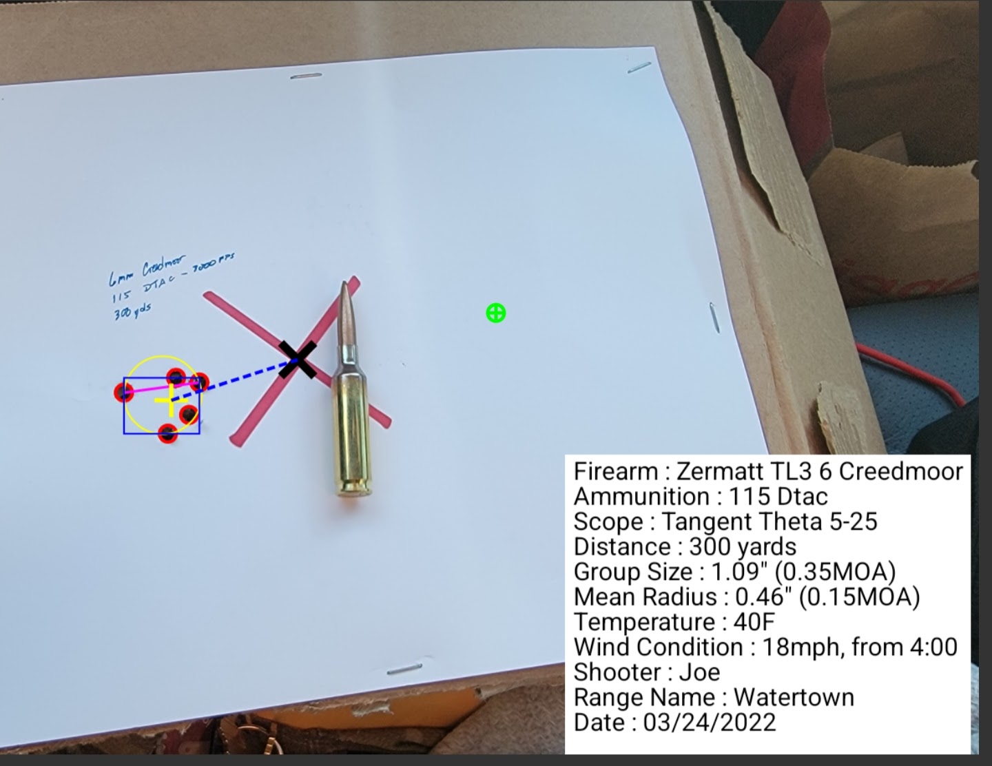

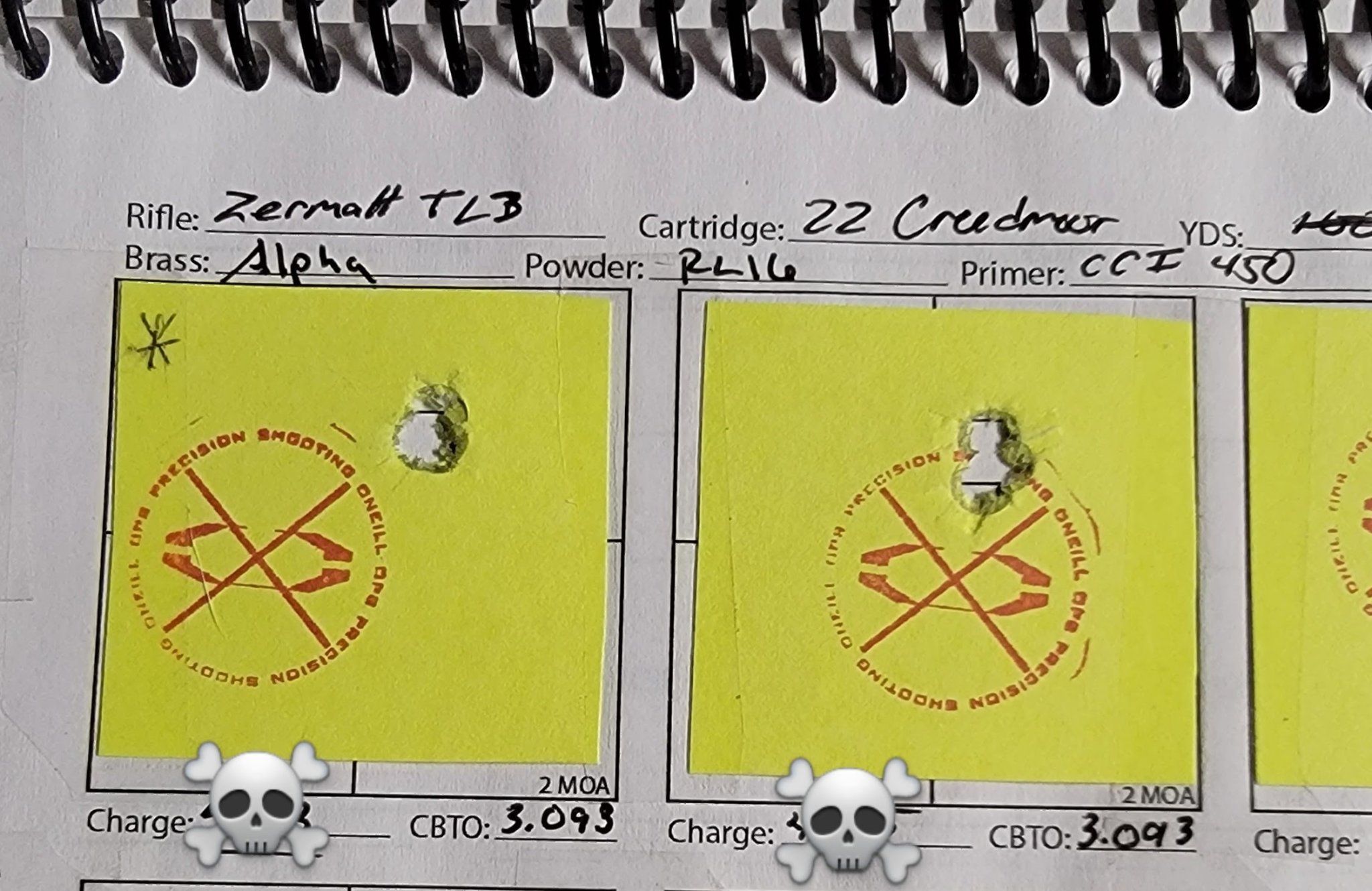

I think i have about 6 barrels from them so far. My 6 Creed and 22 Creed are both 18" and they are two of my most accurate rifles.
The rest are roughly 1/2 moa, but these two are stupid.
View attachment 8623638View attachment 8623639
Very nice groups you have there!! I will post some photos later of the 7 PRC, went and zero'd it for the first time and its shooting .6 in 5 shot groups at 100 yds with Hornady ELD-M 180 grain. So I believe pretty good for just starting to break in the barrel.
