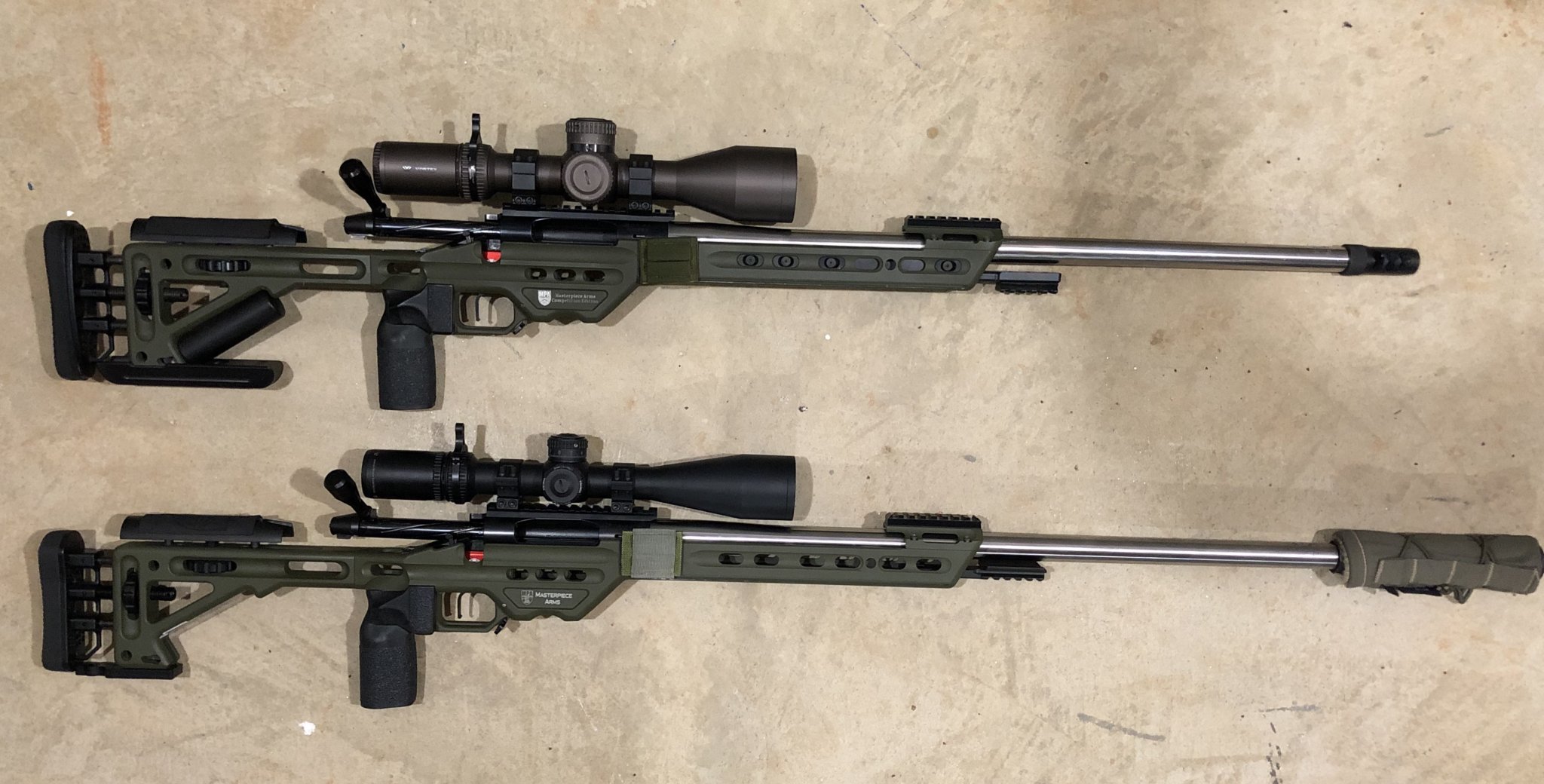

I swap the barrels out between matches so all my practice is the same rifle, stock, scope, barrel length... Only the caliber is different.

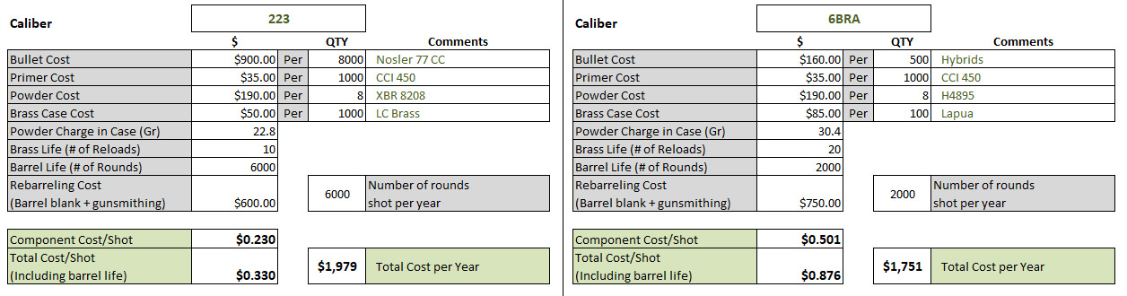

My exact costs below. I save over 50 cents per round fired ...
Send me a PM with your email address an I can send you the Excel spreadsheet. It's fill-in-the blank and does all the math for you.

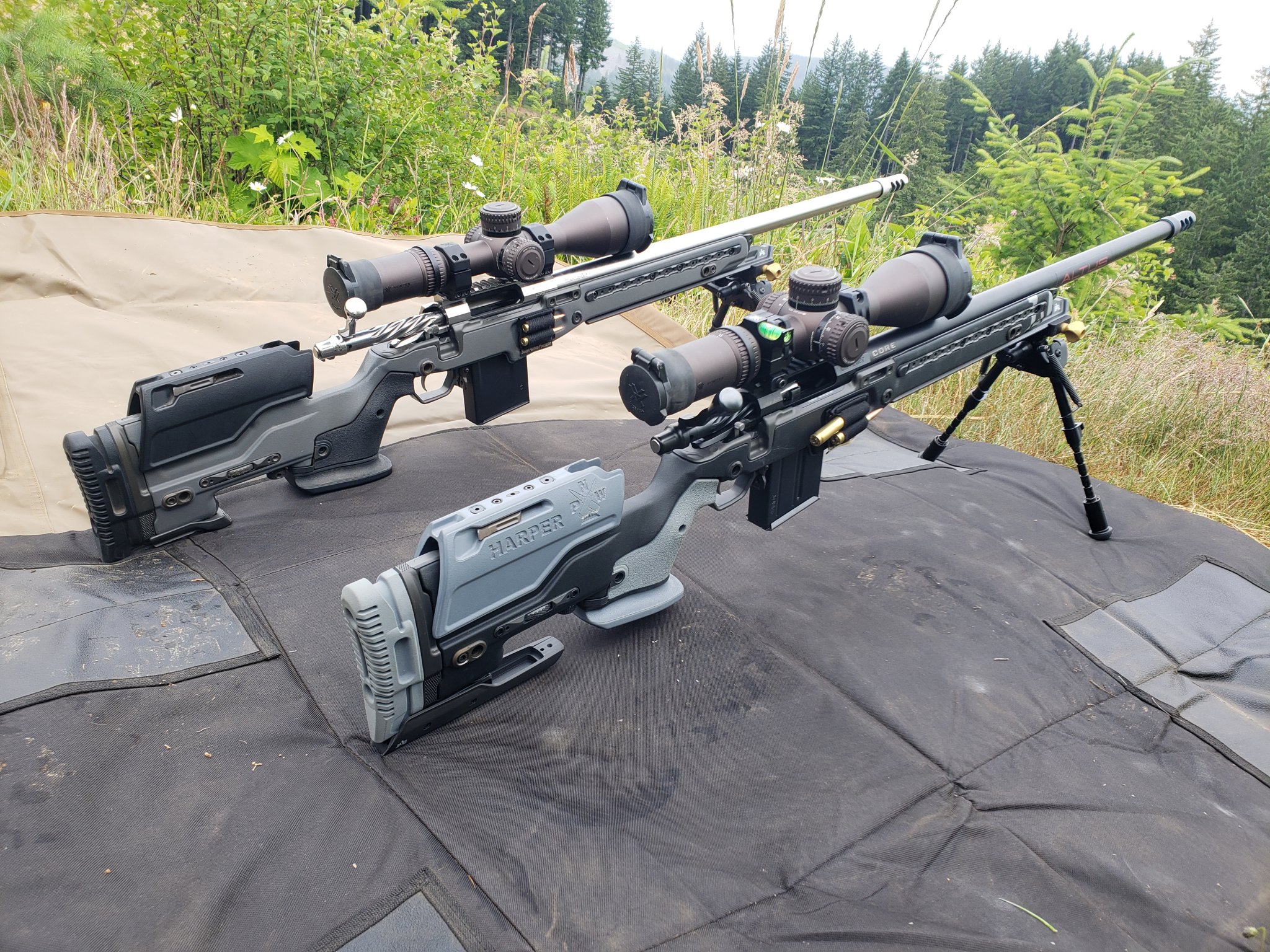

I had a .223 chambered for my Bighorn. I swap barrels and can use the exact same gun, chassis, trigger, scope as my match set-up. And I can shoot Tac-class if I want.

On a progressive you can load about 100rds every ten minutes. Not to say you can't load larger calibers than 223 on a progressive, but I think most guys prefer to single load match ammo and weigh charges individually.
On a progressive it's done with a powder drop so it's not as precise, but still plenty capable at 'practice' yardages.

Many others have mentioned it, but I am in the same boat, I built a 223 to save the barrel on my BR. My BR only comes out to confirm zero, check speeds and shoot in a match. Otherwise, the 223 is in the truck. They are super easy to load for and are a blast to shoot. A few buddies run Magtech First Defense Sniper Ammo - 556C, loaded with 77gn SMK's. From what I hear they shoot great and typically run around .55$ per round. I still hand load for mine, shoots the 75gn ELD's like a champ...I plan on running it in a few Tac classes next year.
I built mine to be exact replicas minus the scope. Opted for an AMG to attempt to lighten up the rifle to allow for more recoil. Otherwise, they are the same.
