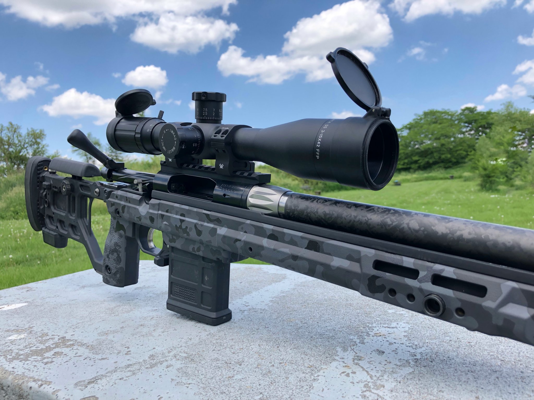

Thank you all for the input and humor on the barrel but question. I’ve ordered a PVA and a bugnut. I’ll see what I like best.I just put together a rifle with a McGowen Barrel, Nucleus Action, and a Bighorn Barrel Nut. The Barrel Nut is great and can be tightened down with a standard 1 1/8" wrench.

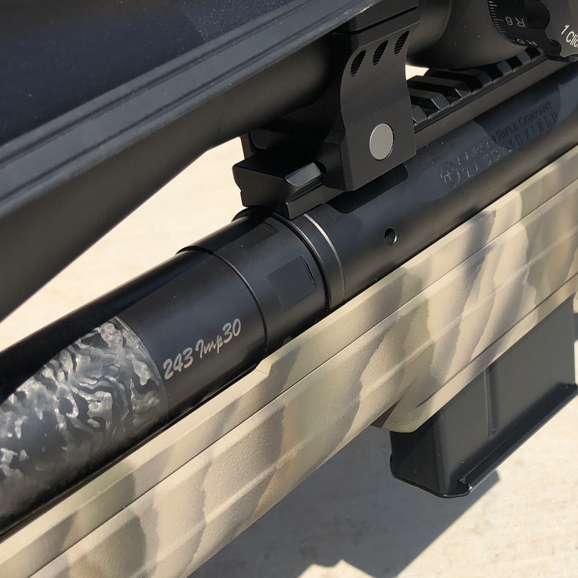

Is that cerakote?
Looks great, I think that’s the way I’m going with mine.Yes. The bugnut and bare stainless on the barrel have been Cerakoted.

And that’s cut for the bugnut or that’s a bugnut on a savage style? (Trying to clarify since the discussion has veered towards the later but it looks like the first)Check out my post (#28) if you want to see what it looks like. The pic is my Mausingfield in a Bravo, barrel is a Proof light Sandero with the bugnut.

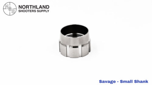

No but they say it may be possibleSorry. It’s the version that goes with shouldered style barrels (not Savage). Do they make a version for Savage countours?
BugNuts may work on a Savage or Remage pre-fit barrel, but will leave unsightly gaps between the nut and barrel, and may leave exposed threads on the barrel tenon.
For those interested, this is what a Bighorn 12-point nut looks like on an Origin with a Proof CF. (It’s also an opportunity for me to post another pic of my rifle)
