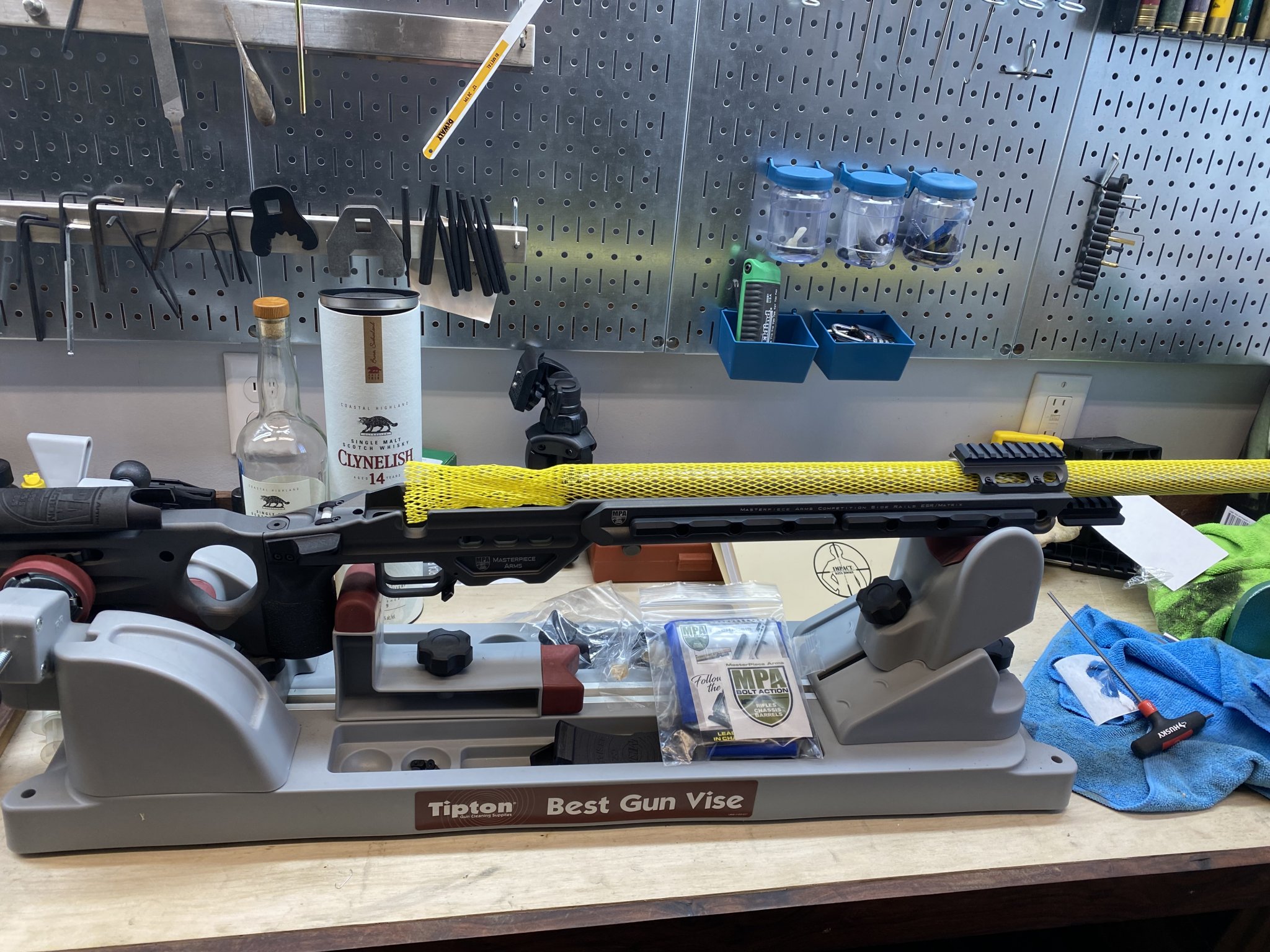

PVA was about the same time. Got mine a week or 2 ago, think it was 8-9 weeks. Joel told me 2 weeks ago he was gonna be invoicing for Zeus actions, yet to get one though. That’s all I’m waiting on still
