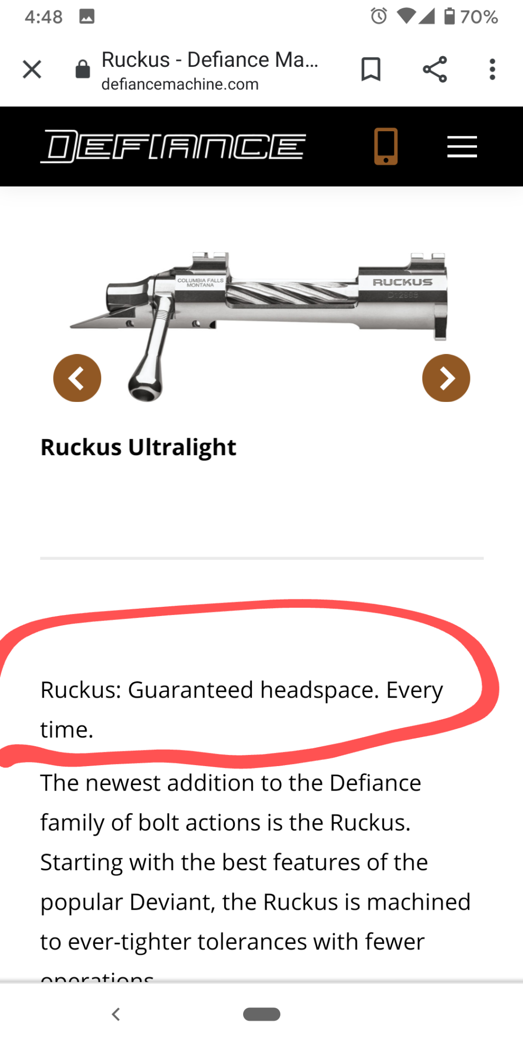

So I have a Ruckus action on order. They guarantee tolerances, but for some reason they dont provide the information needed to get a prefit ordered from a local smith. Im wondering what information is needed to get a prefit made?
Thanks

Ok, I dont pretend to be a gunsmith or a machinist. I let the professionals do their job, and I do mine.
But what does guaranteeing tolerances do for the consumer if the smith still has to get the specs off of their action in hand? Marketing? I'm not trying to be rude, I'm trying to educate myself.
If companies like Proof are able to manufacture prefits for these actions due to tightly controlled tolerances on the action, then what is stopping others like my smith? Believe me, Id love to grab a proof prefit, but unfortunately that isn't exactly the most financially feasible and with COVID halting everything at the border for months, I would love to be able to send some specs to a manufacturer, and have them spin me up a prefit. Also, shipping a $2100 (Canadian) action across the country twice with a completely inept shipping service like Canada Post is why I wanted to go the prefit route. If that's not doable, that's fine, and really isn't a slight against Defiance. They produce phenomenal actions, and I wouldn't have placed an order for one if I thought they were trying to screw me or had an inferior product. I had plenty of choices, but I chose them for a reason.
I'm just genuinely curious what the tolerance guarantee is for, if not prefits.
Looks like I got some terminology wrong and assumed "guaranteed headspace" was the same as "Pre-fit compatible". They explain their position pretty well in the FAQ, although I don't remember seeing this last time I was on their website, so I'm guessing it's come up a lot lately.
Regardless, I stand by my opinion that guaranteeing the headspace dimension is a moot point if you won't disclose the dimension it's supposed to be guaranteed to be.
