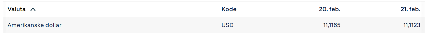

Exchange rate $1 = NOK11.1
Prices listed are included 25% sales tax..
