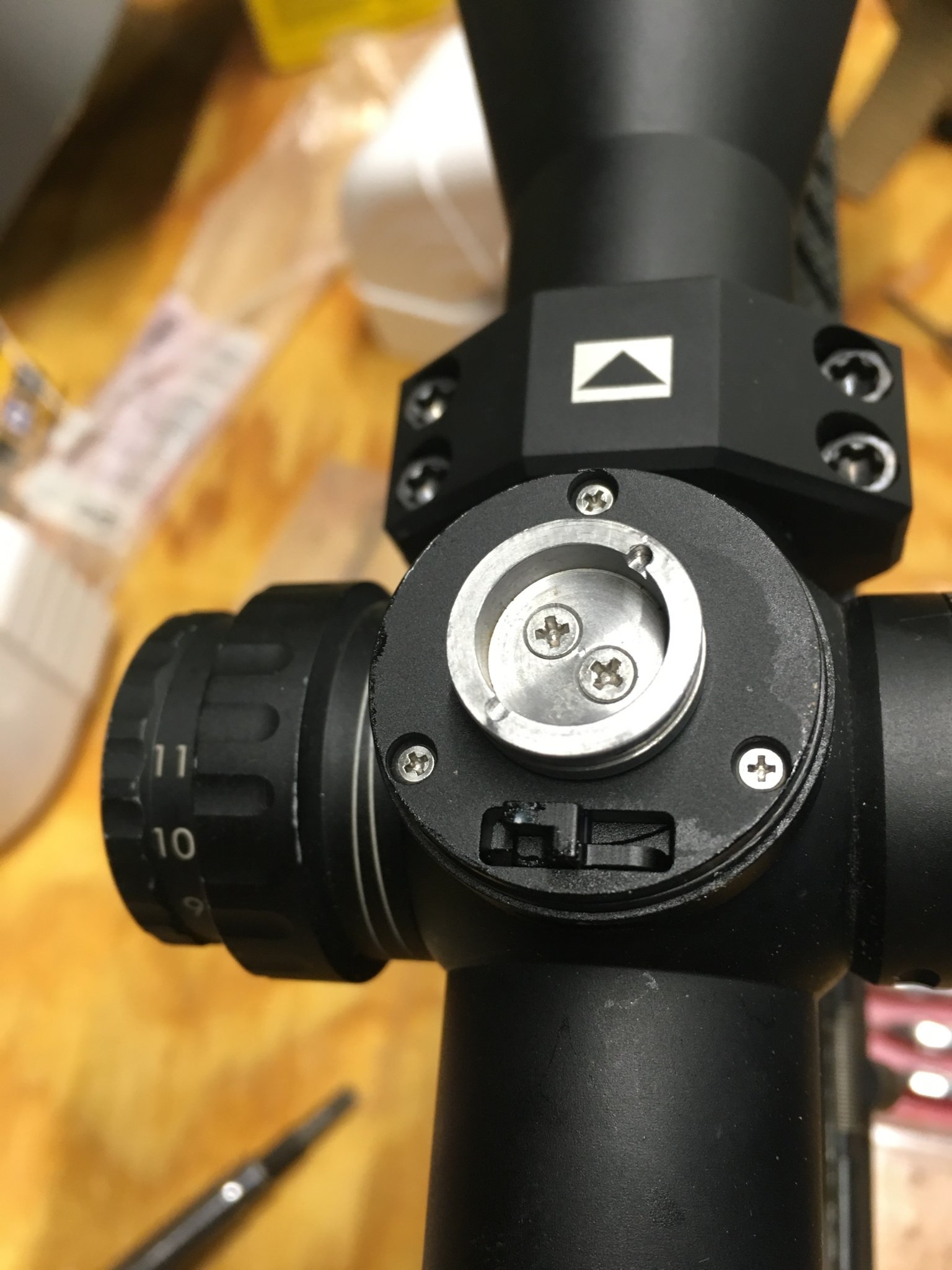

So, I'm trying to zero this optic, it's in a Steiner unimount, that looks like it has zero cant. It's on an AR-10 in 308, and I can't get it any closer than impacts hitting 2.5 mils above my point of aim. The turret is bottomed out, and I can't get it any closer. It has the two little set screws in the turret... Is there a way to move the zero stop?
here is the mount, it's the 5971
https://www.steiner-optics.com/accessories/t-series-ar-mount
thanks,
Scott
So I popped the cap off
I tried to loosen the screws in the center turret, but they seem locked down pretty good, and when I tried the screw on the top/left in the photo the entire center post rotated a couple clicks.
I also see two notches in the center stainless turret, so that looks like spots for a tool to rotate the entire center turret and adjust the zero stop.
So if I'm impacting 7.5" or 2.1 mil above my point of aim, I suppose I want to make this stainless post taller to adjust the zero stop in the right direction
Scott
Just so we are clear - With the turret bottomed out on zero, did you loosen the turret screws, dial up your 2.5 mils *floating the turret*, tighten the screws, then adjust back down to zero?
So that is what I think I'm gonna do... pop the cap off, then float the internal stainless turret up, and hopefully that will do it. so the internal turret screw clicks must be the same as whats marked on the dial right? So I can turn it like 22 clicks and that should give me the headroom to zero.
also, I'm not sure if those stainless screws come loose. I tried and they seemed torqued pretty well... I think I just rotate the internal screw, and then put the cap back on.
Scott

Do not touch those screws! Did you do as I asked earlier? There are no user serviceable parts where you are now and you will screw something up. Most of those parts are no longer available.
Did you try to loosen the screws and dial up a few mils then tighten the dial down again?
Then again what do I know? I just built the things for over 10 years.
If I remember correctly the LT had a simple 2 hex screw dial but it did have a zero stop. since you are down at zero, loosen the screws on the dial and simply turn the dial up about a mil and lock the screws down and turn down to zero and you should have enough travel then.
This is what I remember having to do.

A5scott,
DO NOT DO THAT! What are you doing man haha? You are making this 10x harder than it is. Read the comments from Plange. Post #5 spells it out clearly, as well as #8 from j-dubya.
The only screws you touch are the ones actually holding the turret cap on. All you have to do is loosen those so you can slip the turret (which means to turn the turret without it making adjustments) up 2.5, re-tighten those screws, then dial down to zero. The zero-stop resets itself.
Since you already have the cap all the way off like a maniac lol, put it back on at "0" but don't tighten the screws. Rotate it like you were dialing up 2.5 (or whatever you need to come down) so that it reads "2.5". Tighten the screws to secure it, then dial down to zero. This will pull 2.5 mils off the turret (getting to your zero) and the zero-stop will automatically be reset so you can only go .2 below zero. Ok man, hopefully that is easy enough for you and you can get zeroed and go shooting! That is a great scope. Good luck!
-TSean
P.S. You should look into getting a mount with 20 moa (or 30) to be able to use the full 12 mils of elevation available on the turret...otherwise you are only going to have around 6 "up" left I would think.

I think maybe what I said was ambiguous, so maybe you guys misunderstood me.
I didn't do anything other than remove the outer cap with the adjustment click marks (numbers) on it. I did not loosen any Phillips head screws that are shown in the pic.
The internal turret is basically a precision screw right? thats what I was talking about backing off and floating up NOT the little Phillips screws. Yes before anybody responded to this thread, I did try the two centermost screws, but not with much torque. I misunderstood what you meant about floating the turret, leaving the cap on, but we were talking about doing the same action, your way is the easier way. I noticed that the internal turret moves with the same exact tactile clicks as it does with the turret cap is on, so yes, thank you, that's it.
hopefully I'll get to the range in the next couple days and get it zeroed, and post up results.
Thanks again,
Scott
