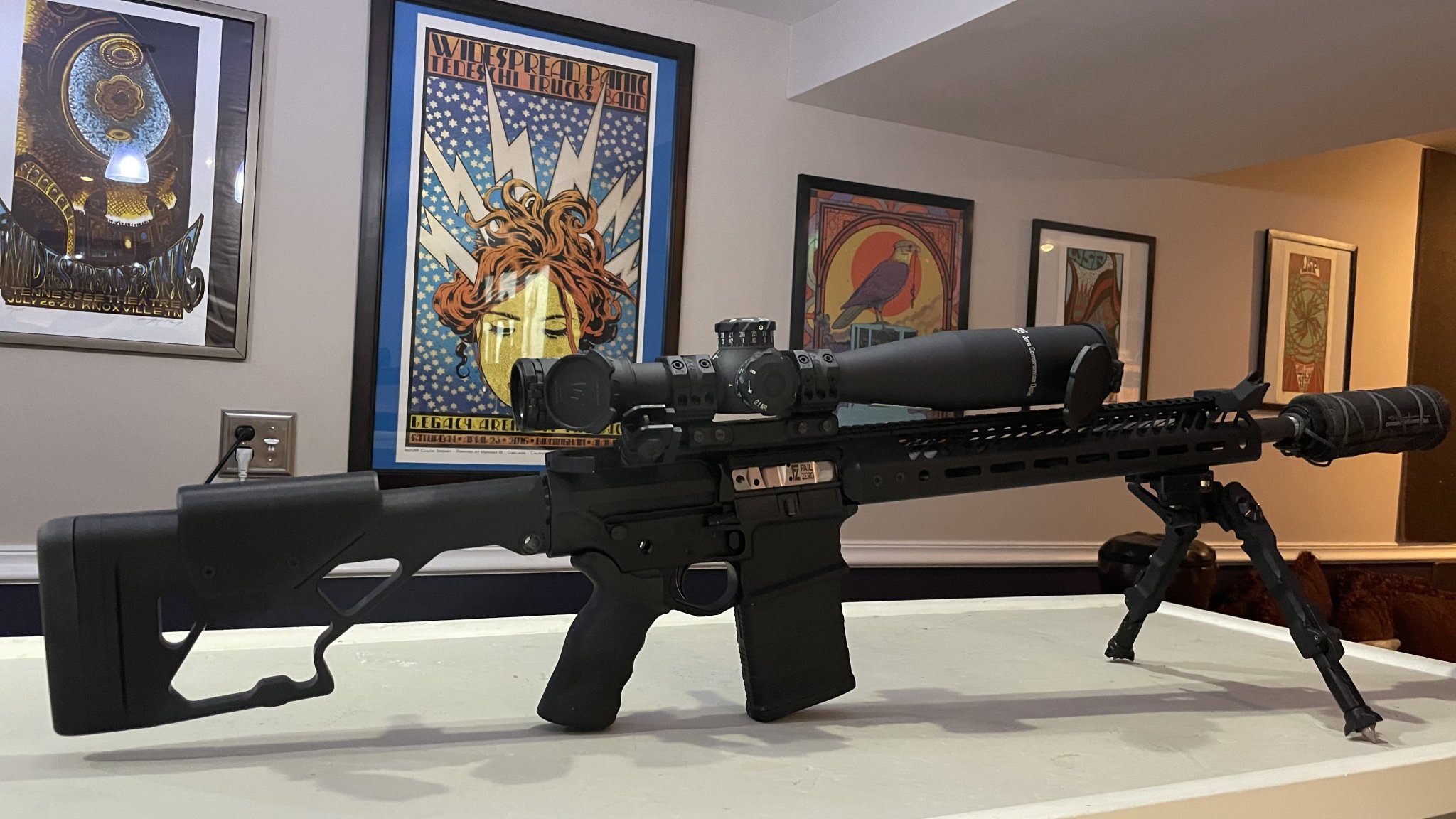

This is what I have from 360 Precision on here. It’s incredibly accurate. 2500 fps with 185 Juggs and Varget. Most importantly, looks sexy AF 😜
