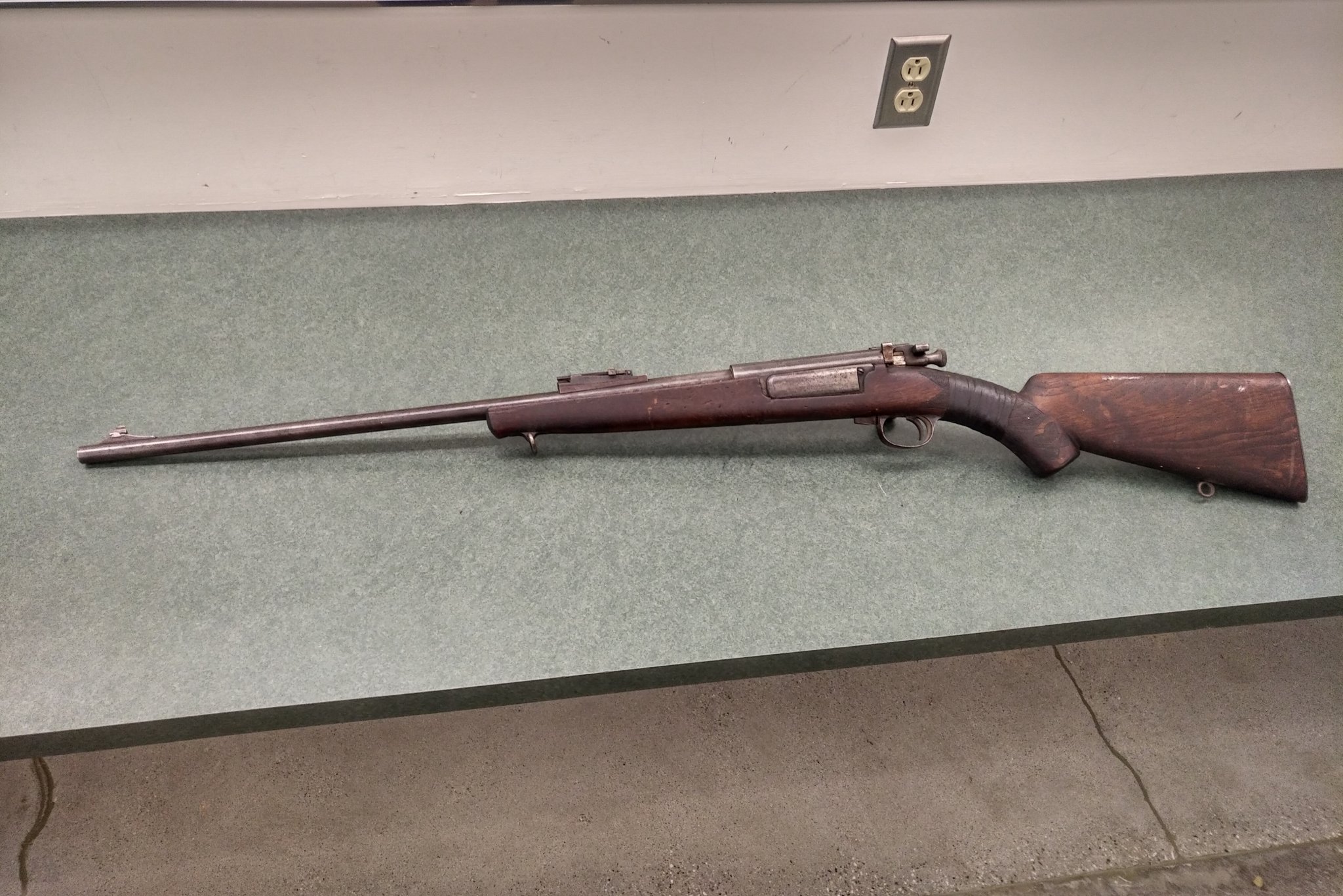

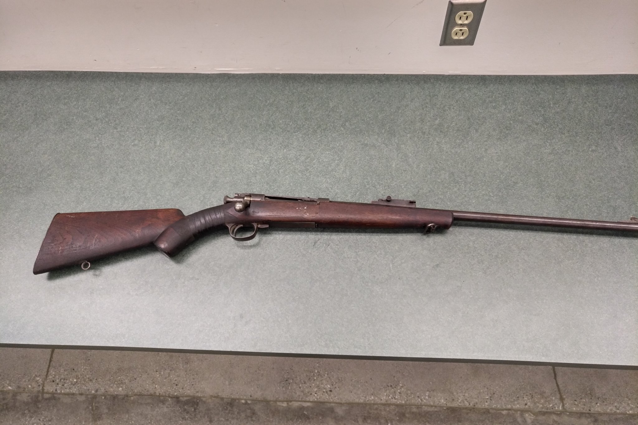

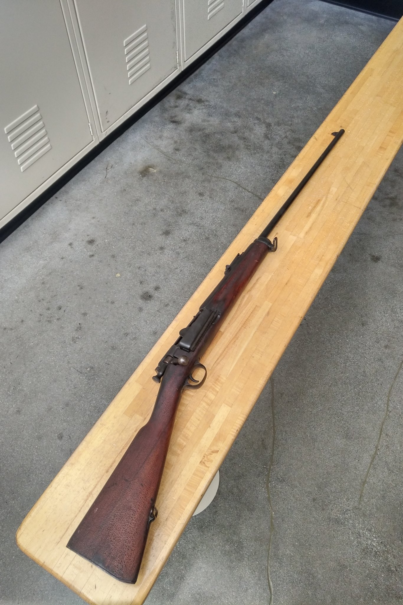

    Not a "sniper rifle" but, some vintage rifffle gunporn.

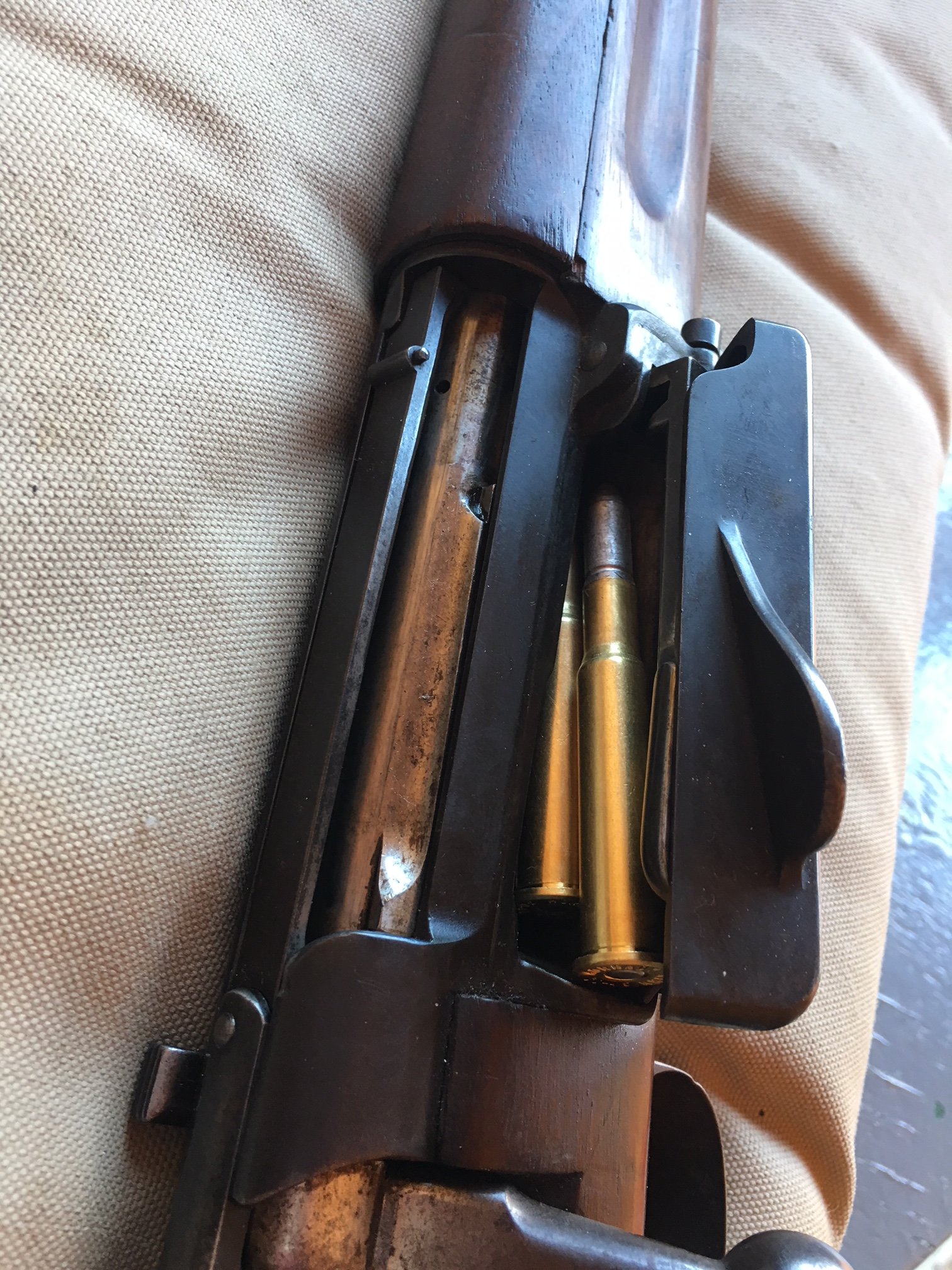

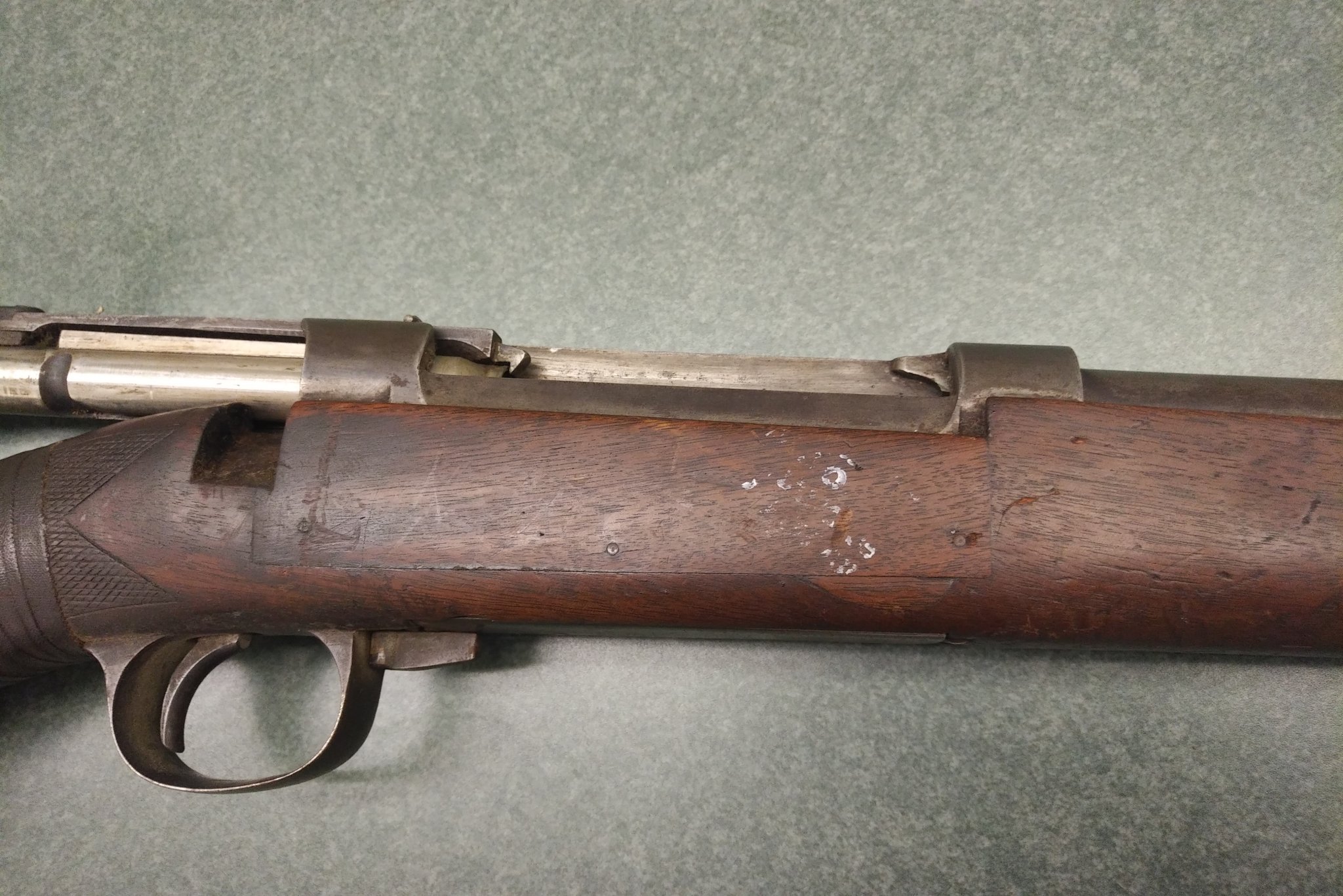

    My buddy wanted me to look over a 30-40 Krag he recently acquired... Looks like one of the "sporterized" cut-down versions after the Army dumped them in favor of the 1903...
    This one had the side-loading box magazine removed. The action is so gummed up with years of dust and whatever that when you pull the trigger the striker just kind of moves forward sluggishly like an entitled millennial looking for an entry-level job.
    My first course of action is going to be to remove the barreled action from the stock then de-funkify as best as I can. Serial number puts it made in 1902 from what the Power of The Internet tells me.
    Unique piece:

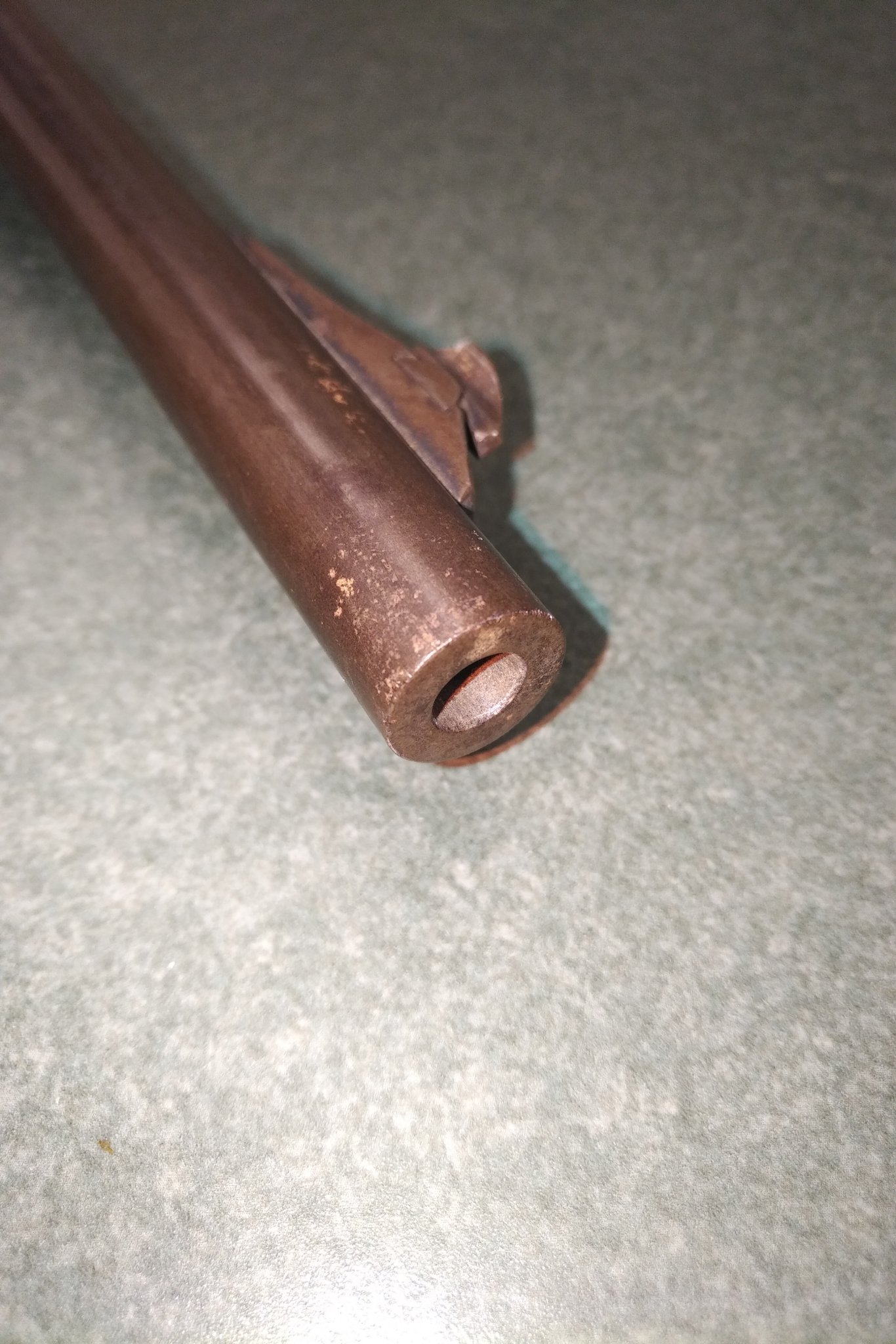

    Super-precision muzzle crown:

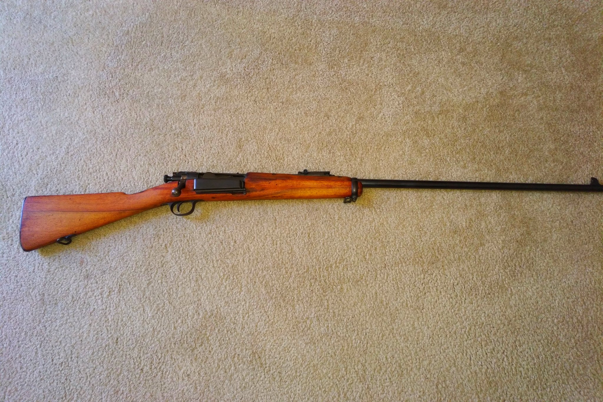

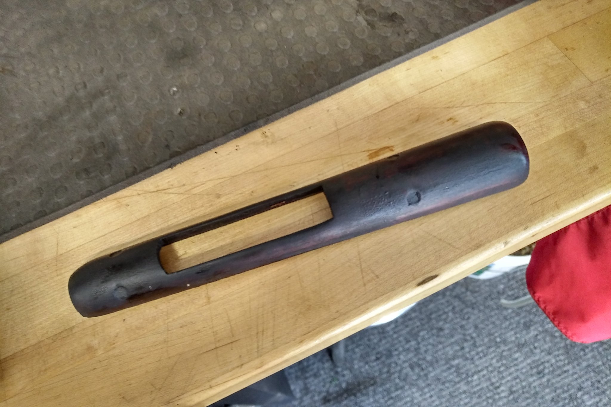

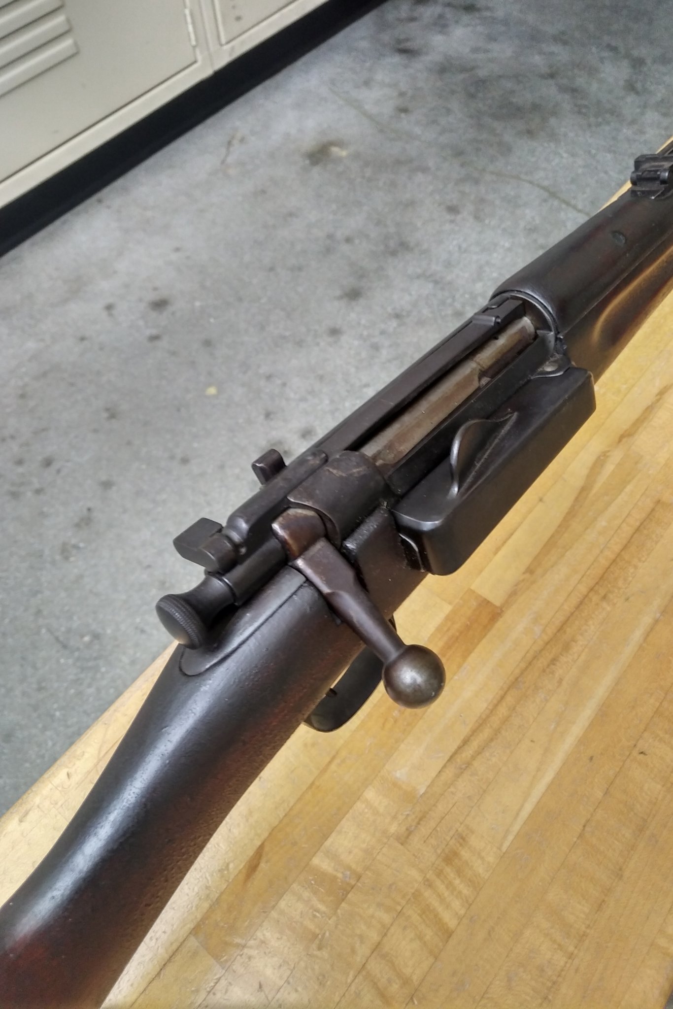

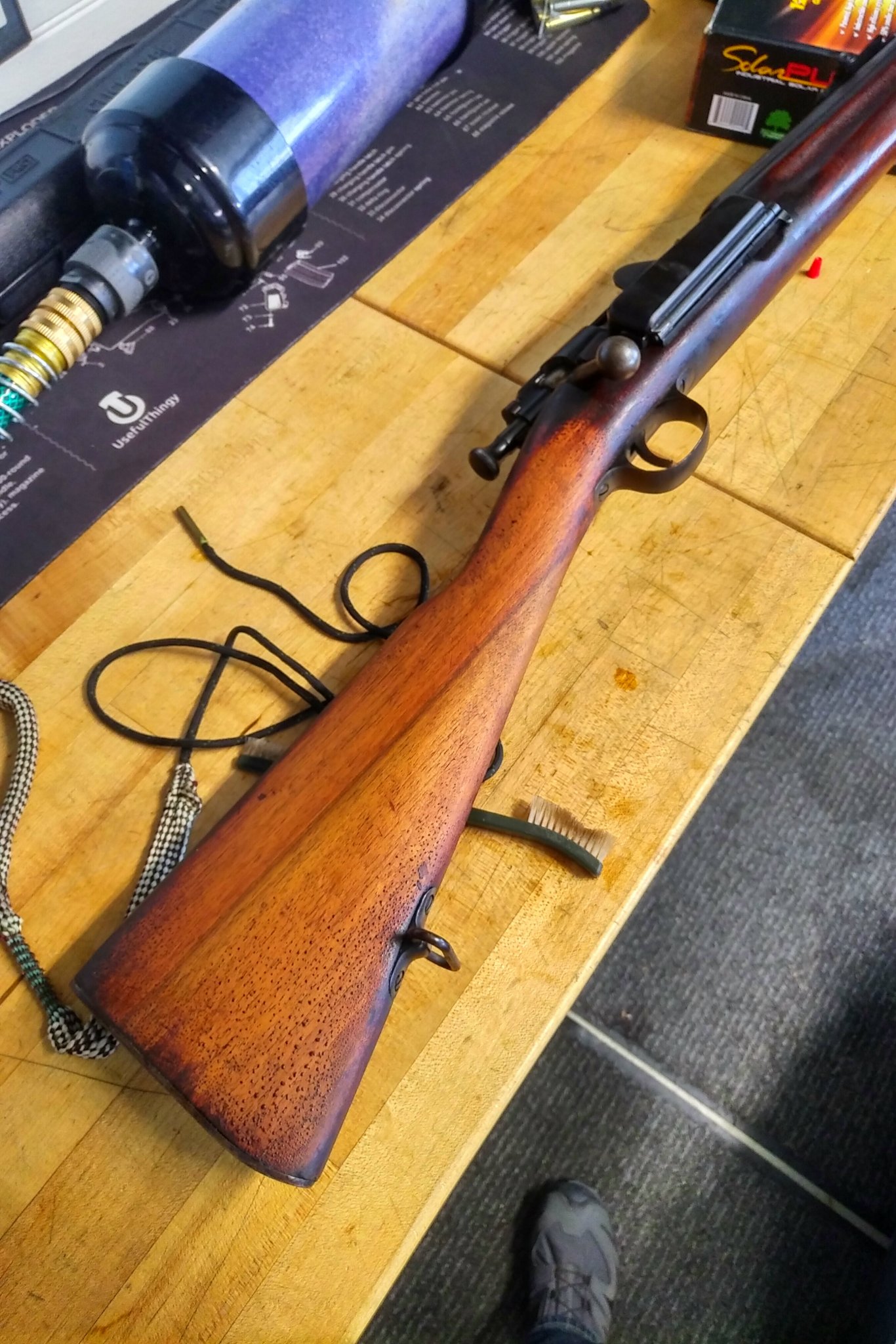

    He also showed me pretty fair condition Krag:

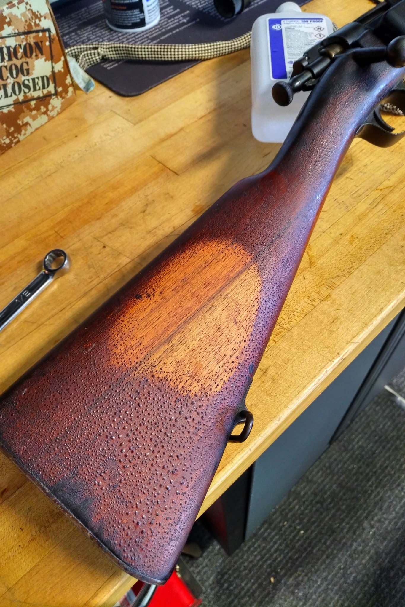

    Looks like the linseed oil in the stock has bubbled up and hardened as a texture... indicates to me the rifle was exposed to some kind of heat?? Maybe a house fire at some point? The wood would burn before the level of heat would endanger the heat treatment of the metal, right?

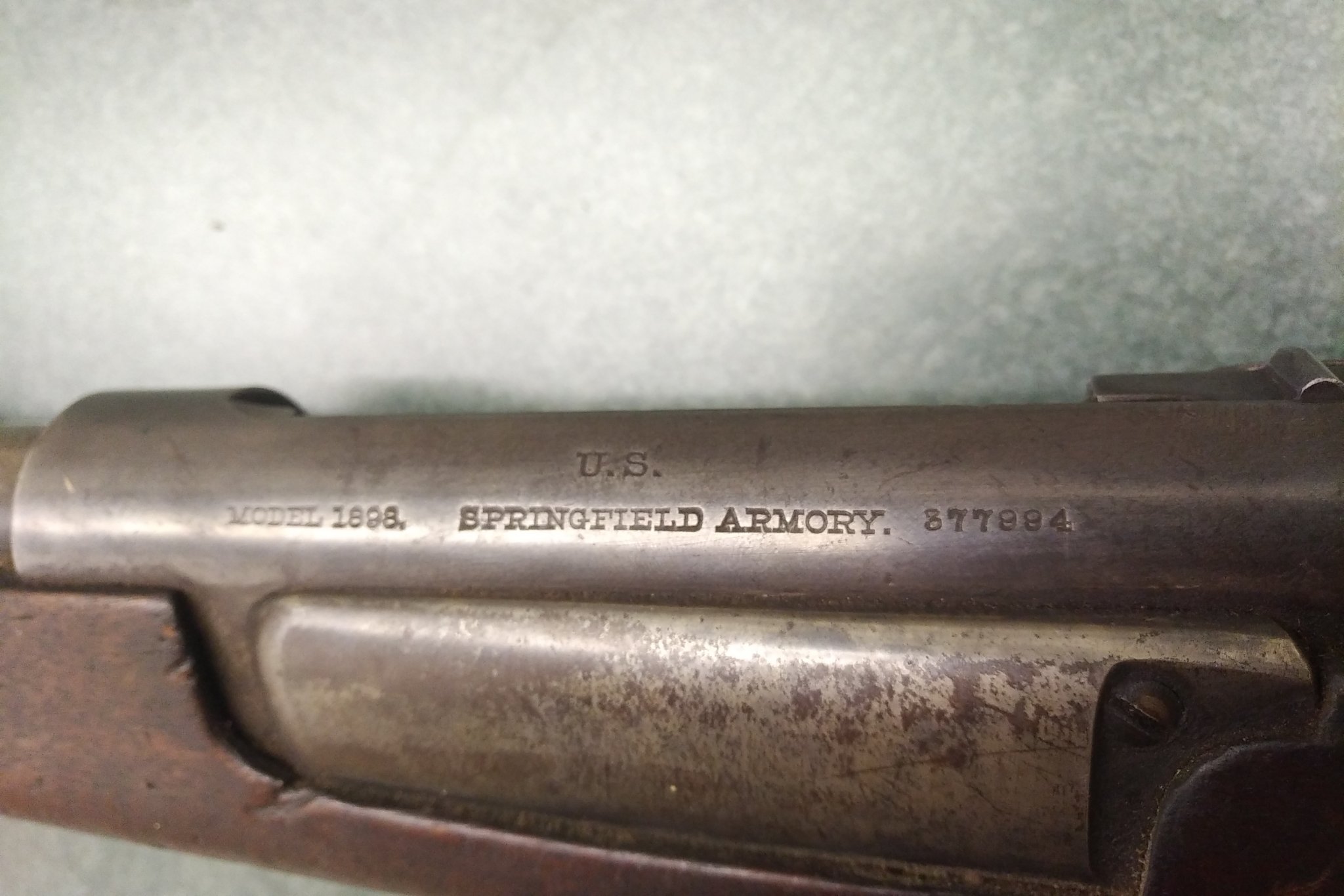

    I am not tracking you on that...stocks were never serialized. The final acceptance stamp JSA over the year (J. Sumner Adams) will be on the left side of the stock and a script P in a circle on the bottom of the wrist. Occasionally stocks are stamped with rack numbers.
    Sorry, confused the two rifles depicted.

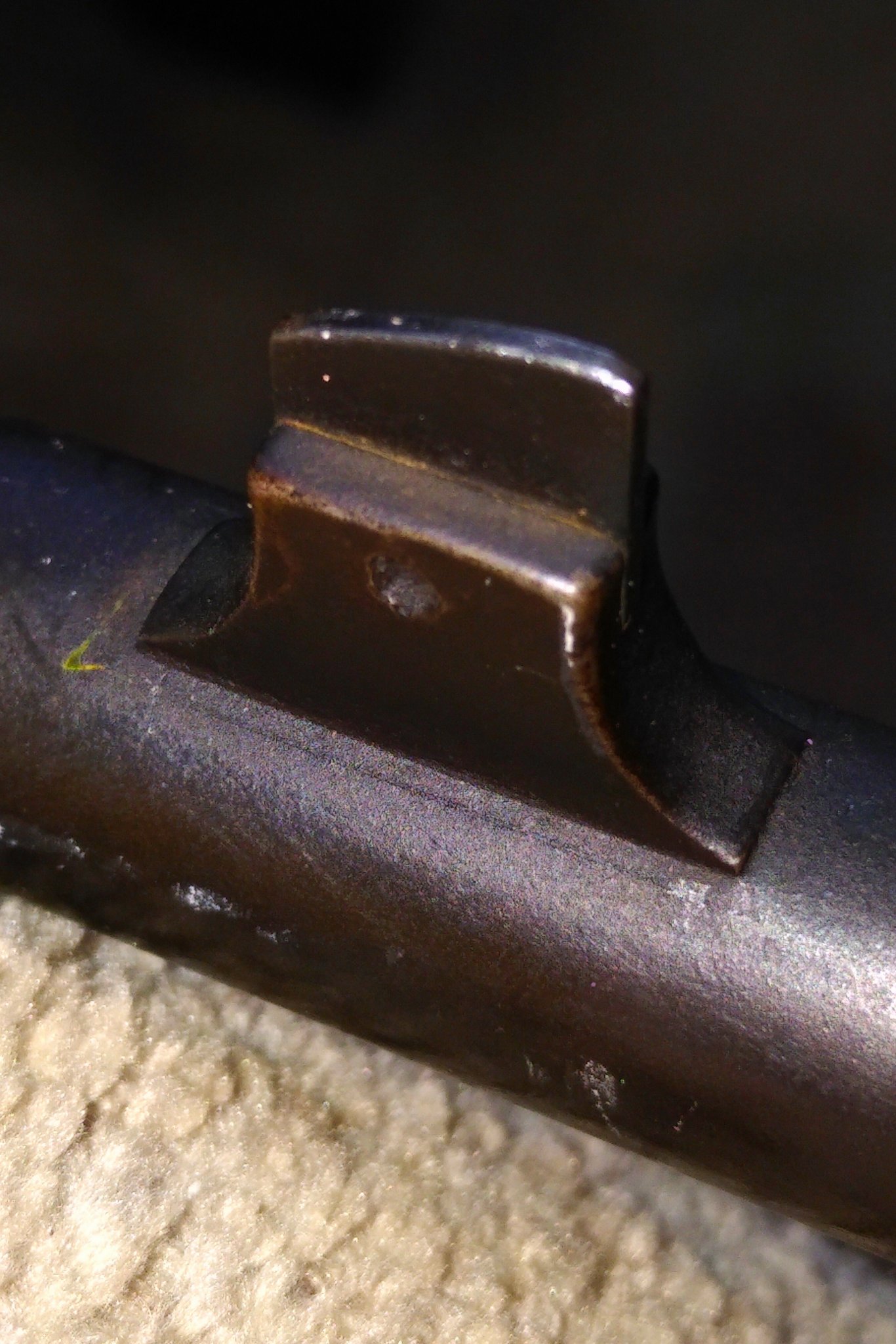

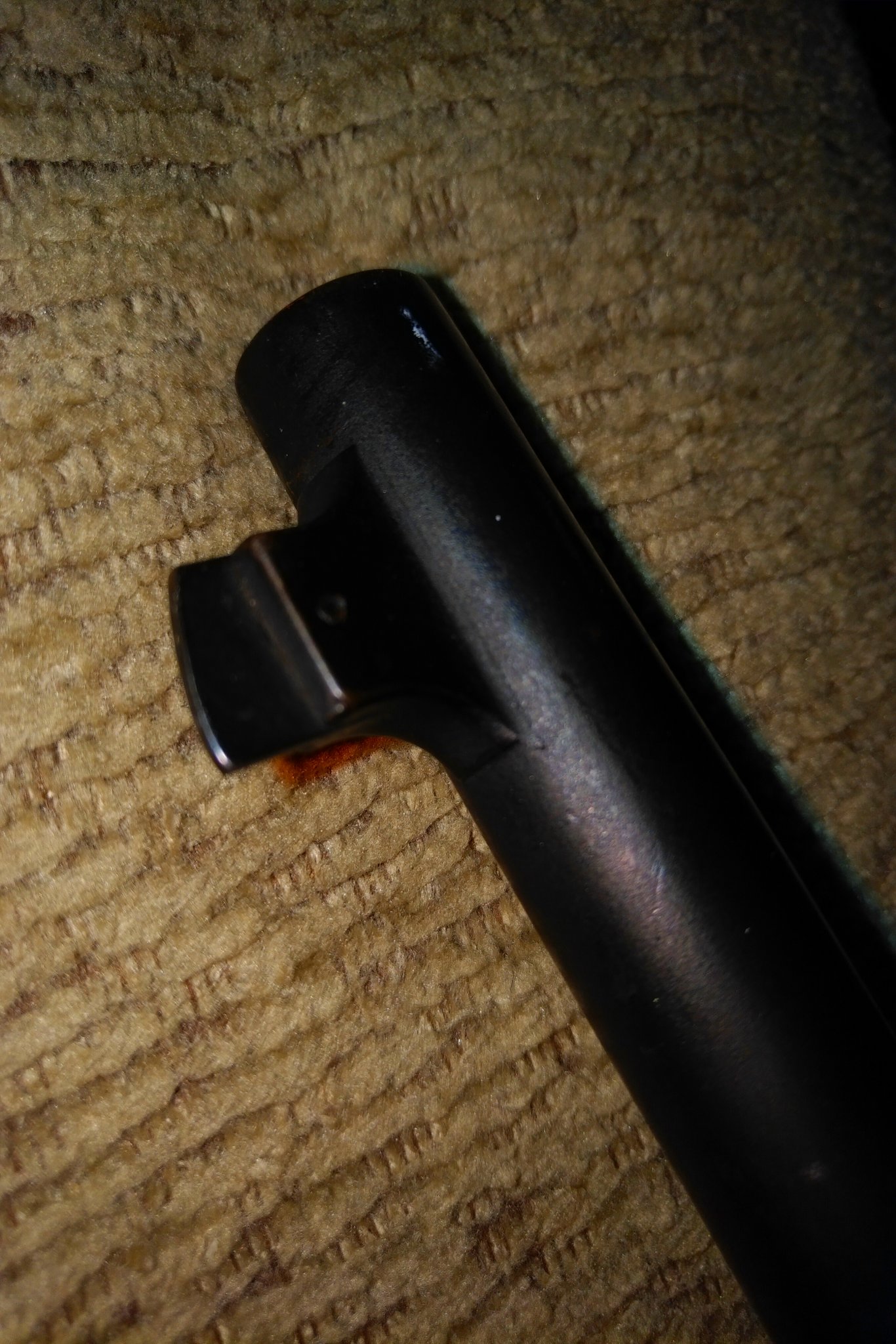

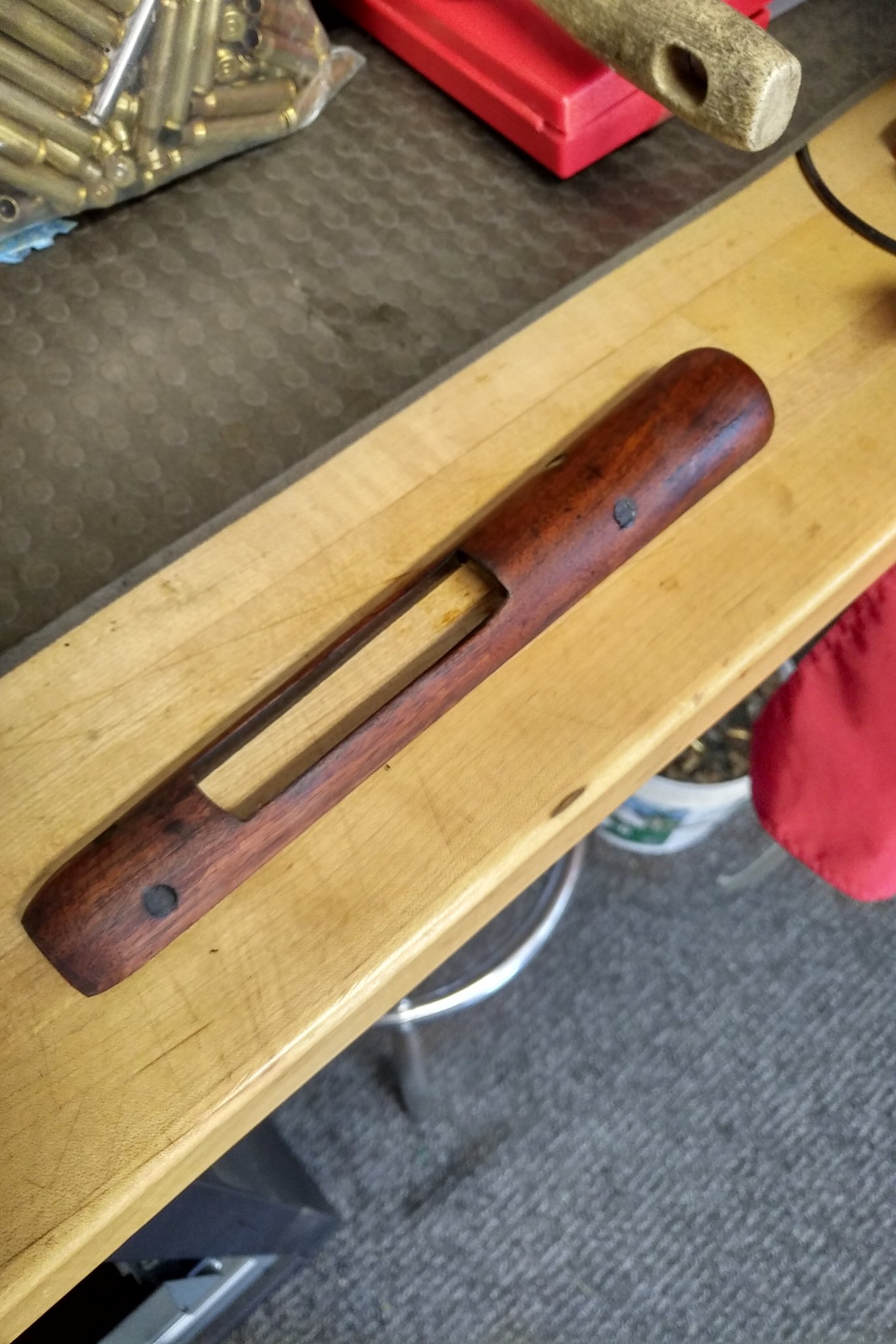

    Model 1892 US krag rifles weren’t marked with the word model, just a date. The Model 1901 rear sight and correct handguard shows the rifle was modified. How long is the barrel? Model 1892s originally had a flat muzzle crown, and were fitted with a cleaning rod under the barrel.
    30" barrel, rounded crown, likely the original dovetail front Sight:

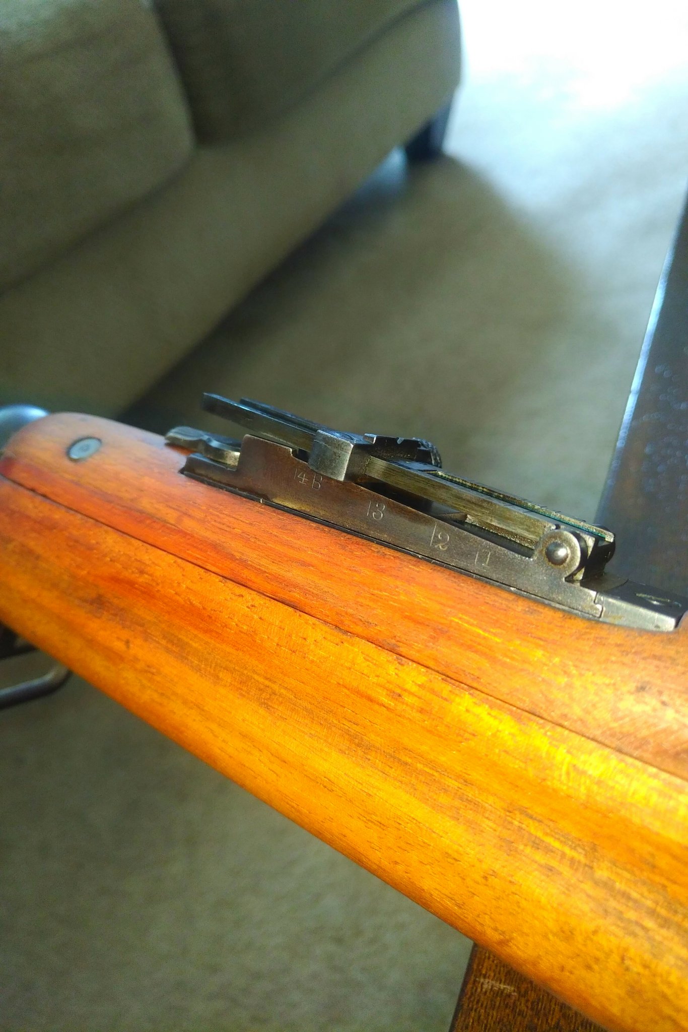

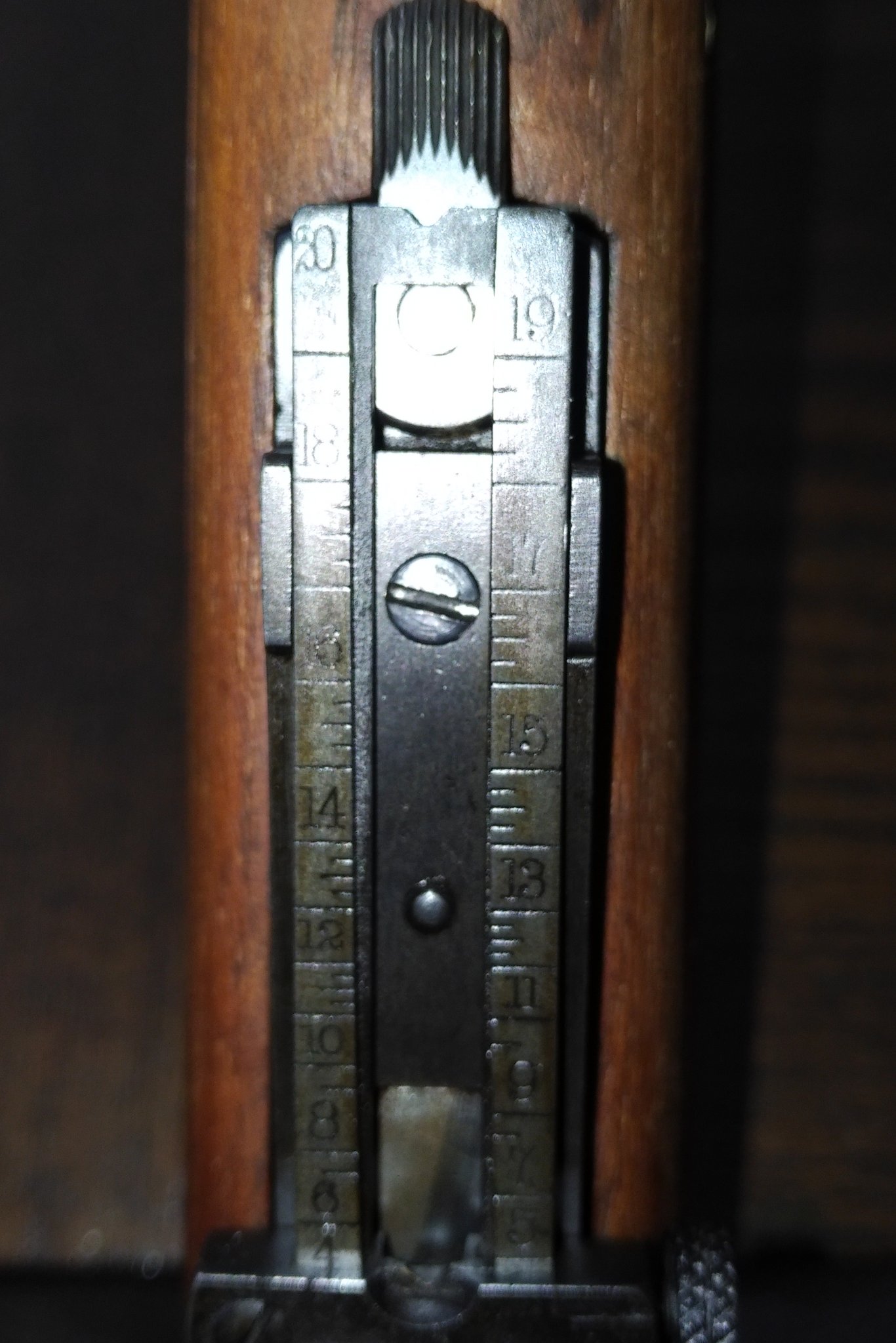

    Rear sight:

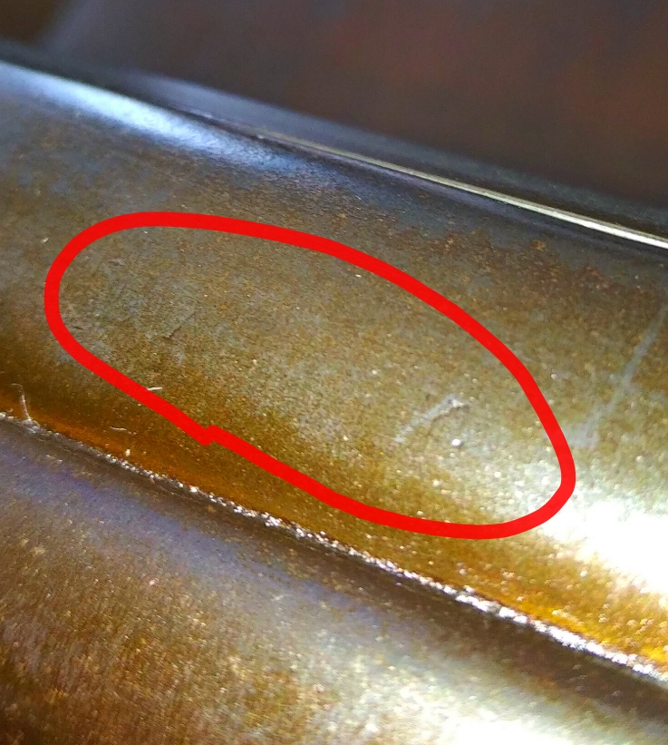

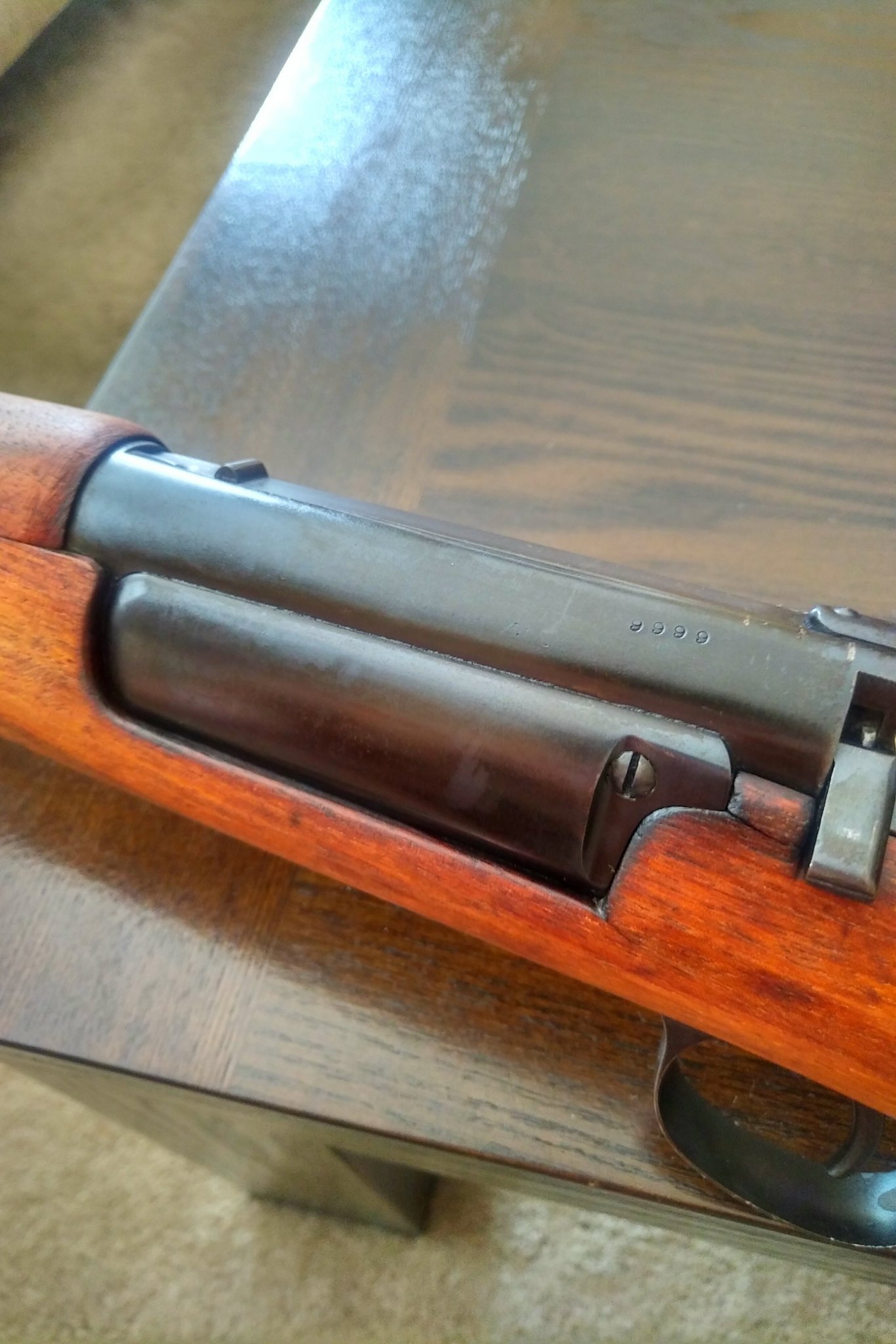

    Receiver:

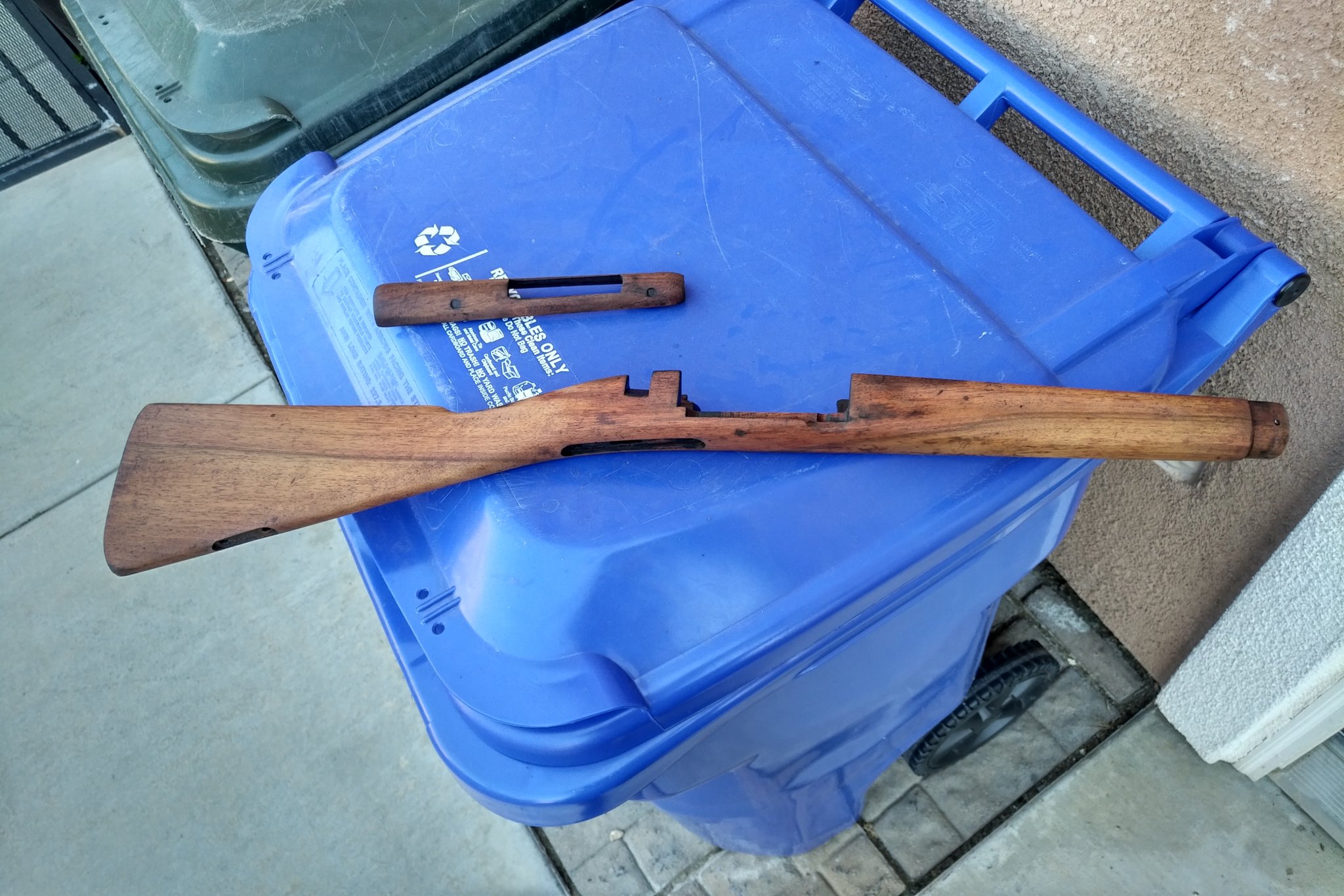

    When I had the stock apart, it had "99" stamped somewhere in the barrel channel area.

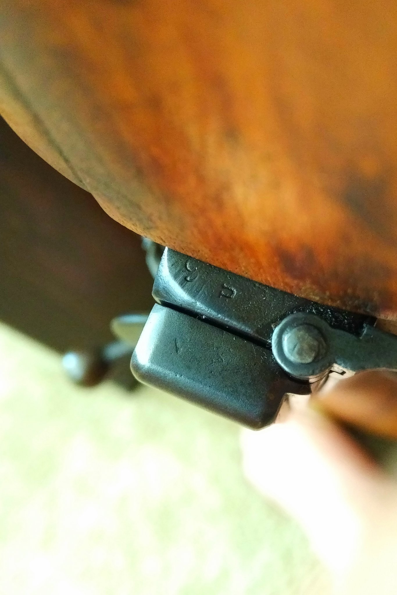

    Front of magazine door there's a "9" and either a "U" or the lower half of an "S"
    Reactions: sandwarrior

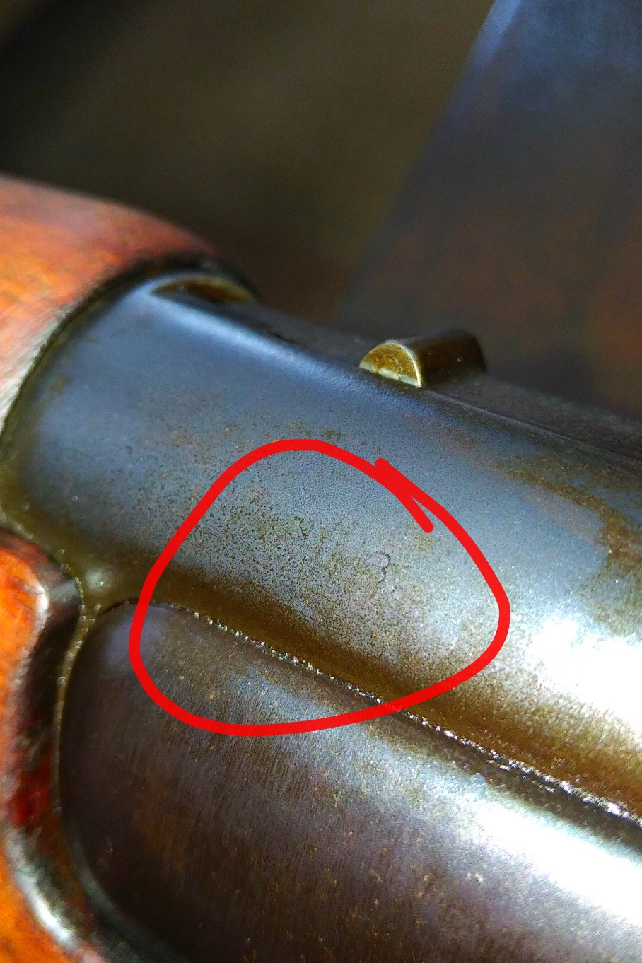

    Not an original s/n. Receiver markings have been polished out. You may be able to see vestiges of the original markings using strong light and looking at the receiver at an oblique angle.
    That's what I was beginning to think as well....
    Looks like a "3" ??
    The "A" and "Y" for "Armory"
    Could be marked 1894, 1895. 1896 or 1898...looking at pics on my iPhone..makes it harder to evaluate images vs monitor

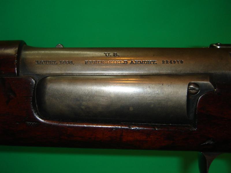

    its an 8. On my clearly marked 1898, the distance from the right edge of the 8 in 1898 to the right edge of the Y in Armory is 1.875". On the one in question, the distance between the two visible "8" and "Y" markings is the same.
