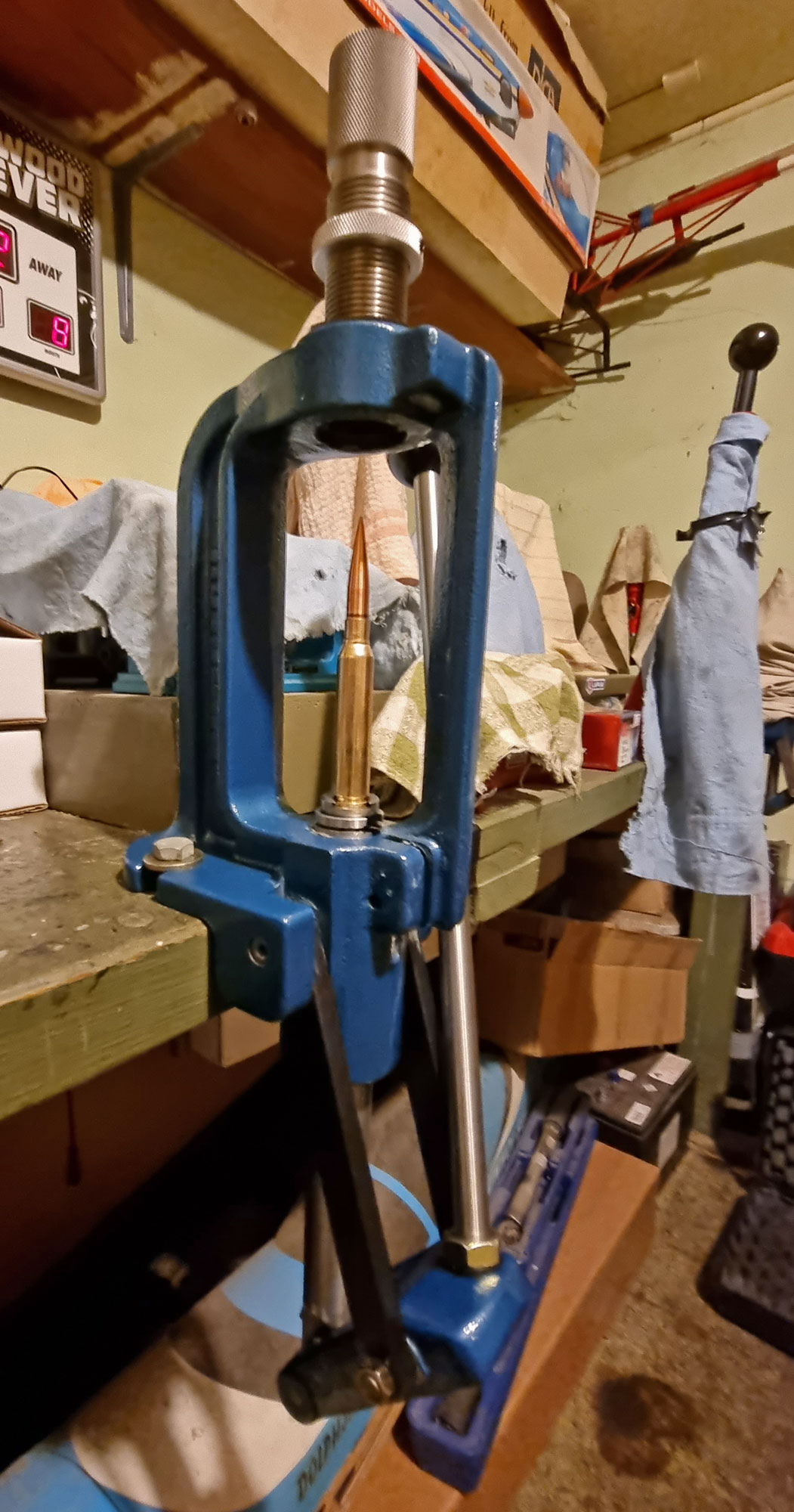

Not sure about the 375. I have the above press just in case I want to start playing with the 50. I have sized cases only with Imperial sizing wax, and it's not that big of a deal. I have done 338 LM, and they're easy, plenty of space.
It's so beefy, that I tend to use it for sizing vs my other presses.
As far as table clearance, my 550 takes up more space.

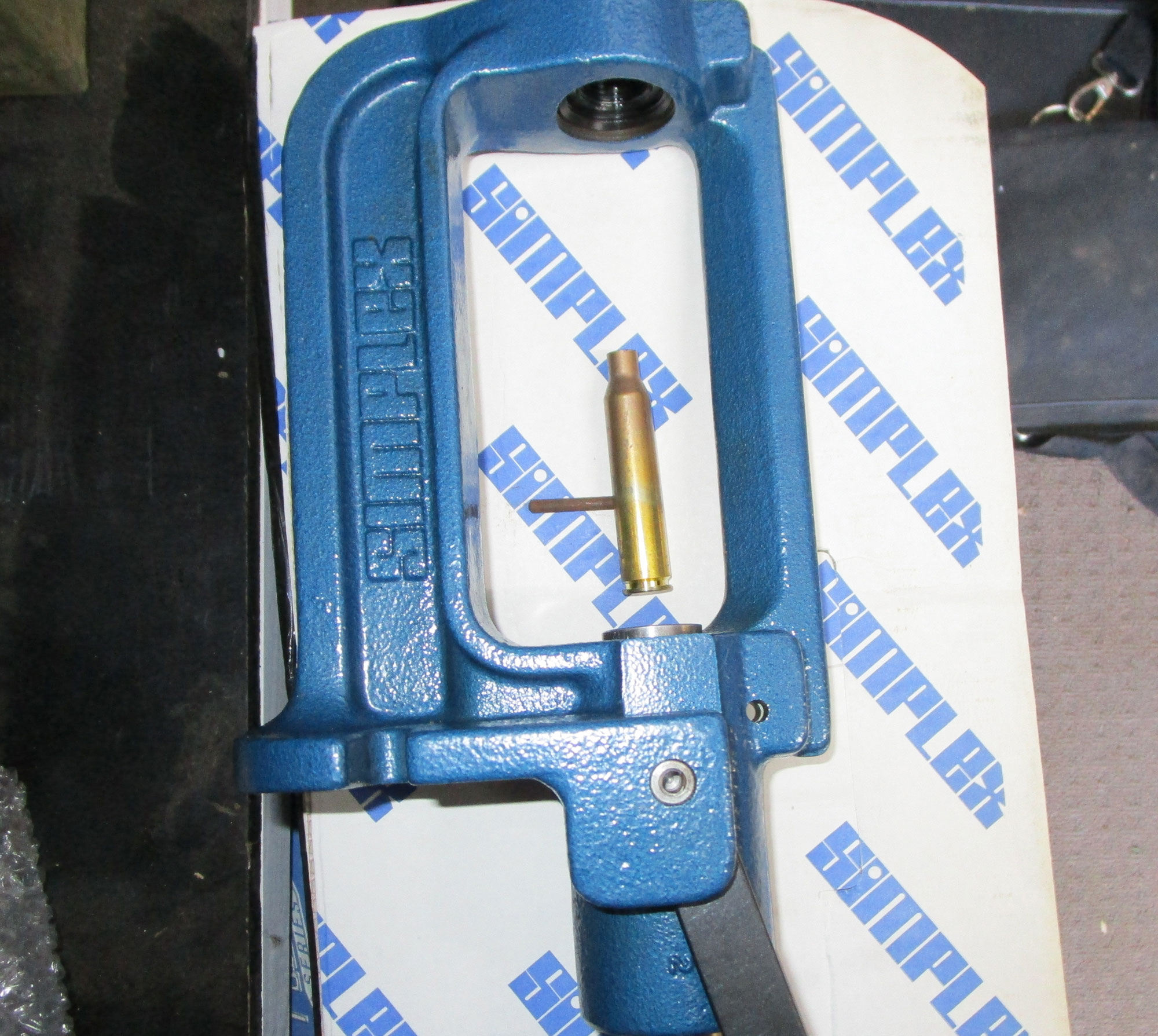

Simplex Magnum Press...158mm stroke.. 375CT with 407 Berger VLD in pic..
