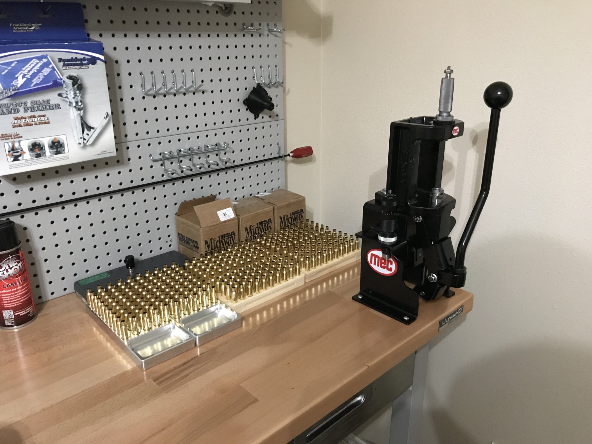

It's tough to argue with. 400 pieces of Dasher brass sized in under a half hour, headspace +/- a half thou, runout < 1 thou. :)
