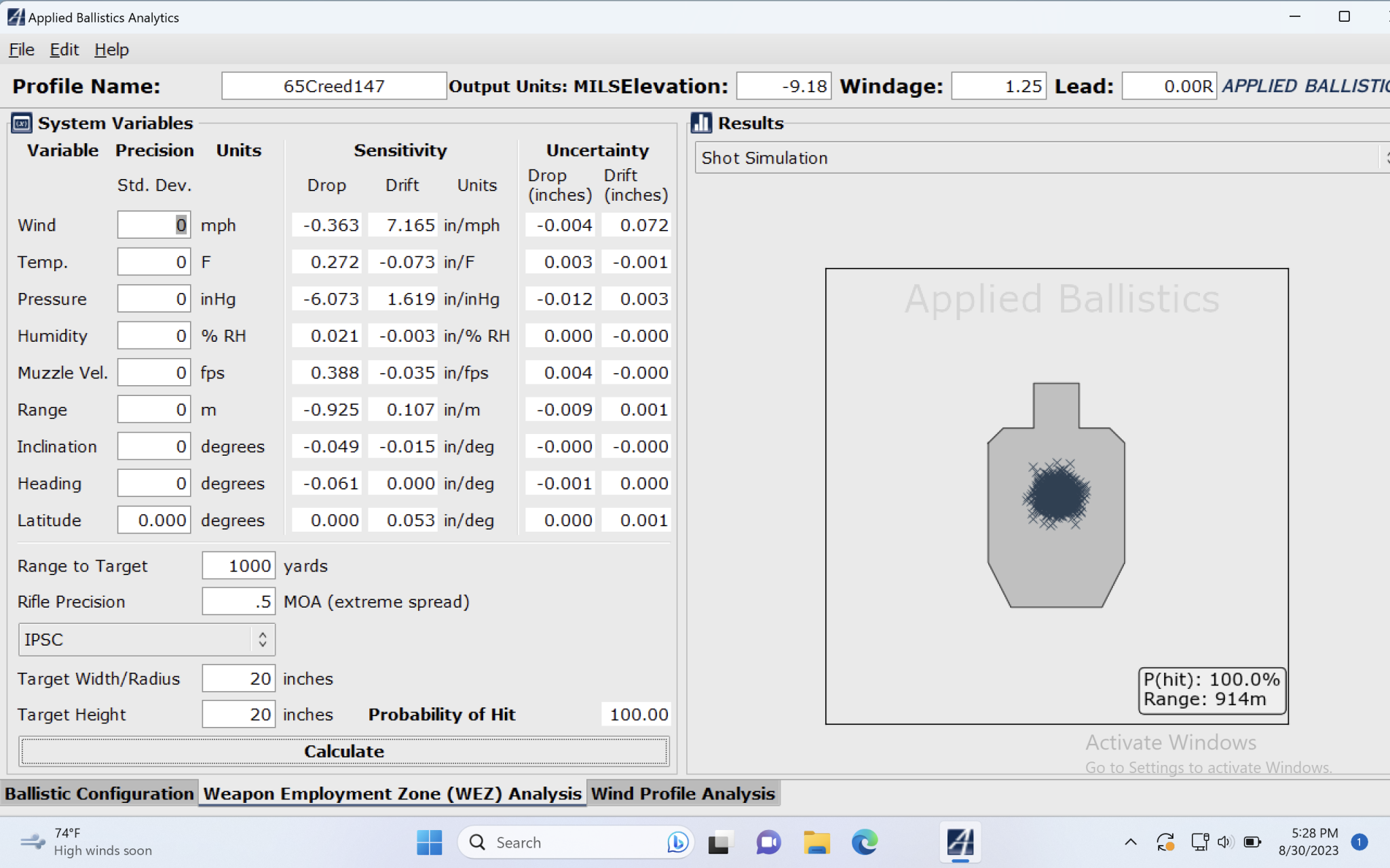

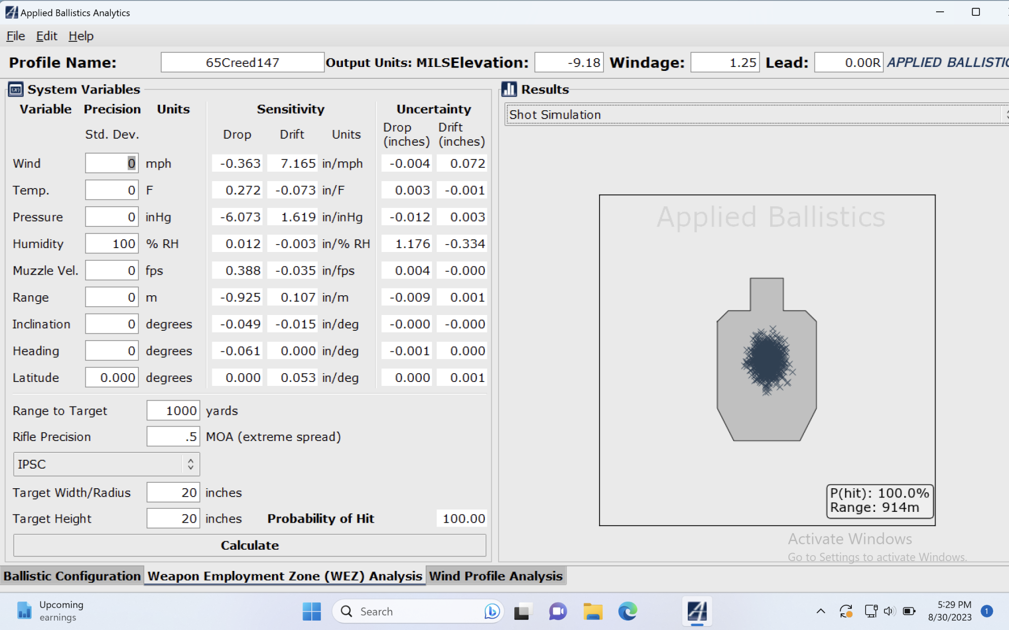

I was playing around with the AB Analytics software and noticed that pressure uncertainty makes a big difference at distance. Is it just that as pressure decreases, aerodynamic drag decreases or is there another factor at play?
Thanks in advance!
The first is 100% RH, and the second is 0% RH. I wonder why RH makes a difference if temperature and pressure stay constant.
