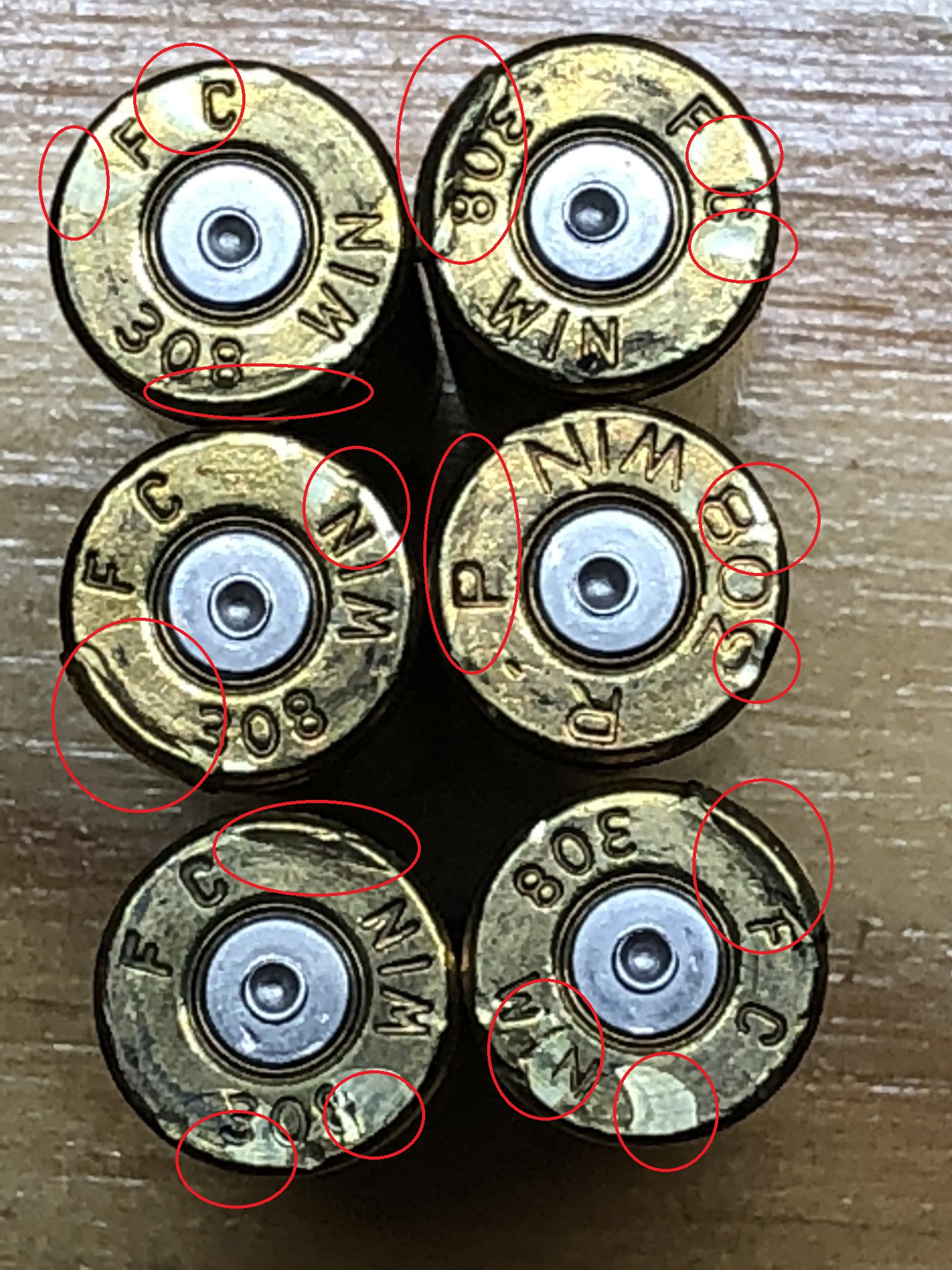

Pressure Signs?
03psd
May 27, 2006
567
33
Oklahoma
Can someone please take a look at these primers / headstamp and give me an opinion on possible pressure issues, please.
Load is 38.7 gr of 10x with 300gr Sierra Game King fired out of my .375 Raptor SBR. 38.5gr is the suggested starting charge with 40.5gr being the max charge. Bolt is dual ejectors and seemed to cycle fine although brass ejection location was inconsistent.
Pic added
Pic added
I'd back off. Those bent rim/extractor marks look nasty and ejector marks are the signs of high pressure. If you have an adjustable gas block, you can try slowing down the unlock timing by reducing gas flow or increasing the buffer weight, which may help.
I do have an superlative arms adjustable gas block so I can slow down the gas. It’s pretty much wide open right now. These cases are from my inaugural range trip with this trifle so there is definite tuning needed.
You have virtually every pressure indicator there is short of your gun exploding.
Well thank goodness I wasnt batting 1.000 that day!
Considering I was at the starting point of the published load data and encountered the above pictured issues. By how much would it be advisable to reduce? 2.0gr?

The cratered primers and ejector marks are reasons to step down the powder charge. The rims are a reason to restrict gas flow. I'm thinking that damage is done before your buffer tube comes into play.
I had one brand of ammo that the piece of rim sheared right off it was so overgassed with no other signs of pressure. Until I throw an adjustable gas block on it, I have ten boxes that make pretty cool paperweights. If I hadn't had a cleaning rod with me, it would have been a very brief range session. Later while swapping out the trigger, a little piece of that rim tumbled out of the trigger housing. That could also have shut me down.

Something is not right here. You did your part. You read the book and started at the low end of the range but you got results more like the top end. You should try to figure out why it is doing this. For example, you might chrono the bullets and see what kind of velocities you are getting. For example, if you are getting low end velocities but high end pressure signs, that points to soft brass. On the other hand if you are getting high-end velocities and high-end pressure signs then that load data does not match up with your gun. According to the Alliant site 10X is for "Light varmint/light bullet loads". Maybe I am wrong but I'm thinking that 300 grain bullets in a 375 is not "Light varmint/light bullet loads". I have a 375 H&H and when I put 300 grain bullets in that case, I use a lot of slow-burning powder. On the 375raptor.com site I see 10x loads all over the place but its your face 3 inches from the chamber. You should do what you think is best but if I was in your place, I would back off until I figured this out.
I, personally, would drop down a grain since you know what you’re at right now doesn’t detonate, crank that gas closed and shoot 10 incrementally opening the gas one click at a time until the bolt locks back. Watch for those pressure signs and if they are still nasty with the gas closed then you need to drop further or evaluate what you’re doing so far as jamming bullets, powder choice, crimping whatever. Actually you should be doing that throughout the entire process but you know what I mean.

The gas adjustment will correct some of the mangled case rim/bent rim issues as well as the ejection pattern issue. What's your current reloading setup and process? Calibrated scale? Powder measure throwing accurately? Reducing a couple of grains may solve the issue of the over pressure (ejector marks, cratered primer). RL-10X if I remember correctly is really temp sensitive so you may need to go reduce even further than 2.0gr depending on temp.

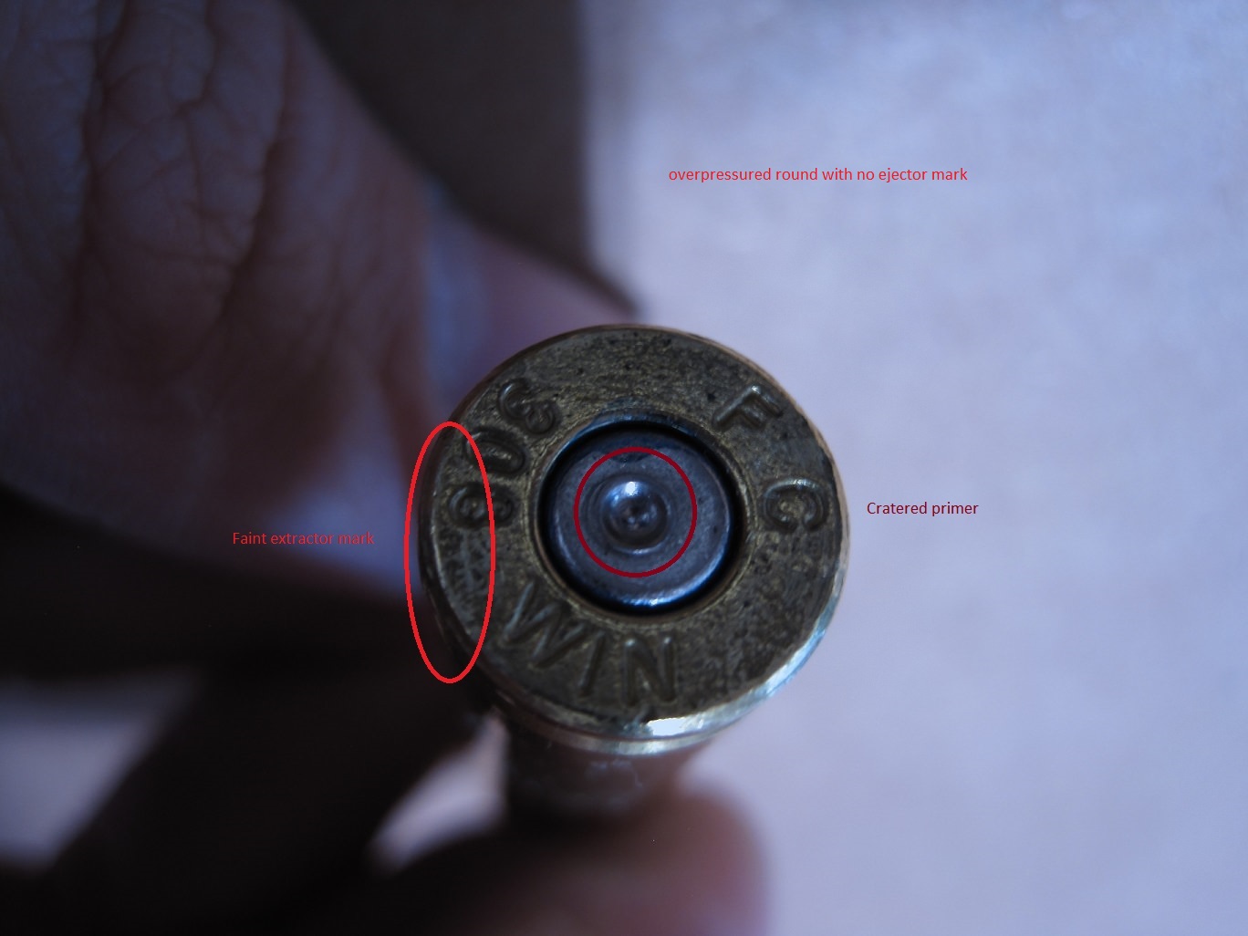

Here's an example pic of one round reaching overpressure limits but with a properly adjusted gas block (from my 308 AR).

I purchased a 375 Raptor barrel from X-Caliber (LR 308 project), along with a X-Terminator muzzle break. Unfortunately, the barrel they sent me had no freebore, a condition they blamed on a defective reamer. X-Caliber believed they had tracked down all of the "freebore free" barrels prior to leaving their shop. Nope. And on top of that, I had ordered 5R rifling, but the same chamber cast that revealed the freebore issue also displayed traditional 6 land and groove rifling. I've read that the shop is experiencing some turnover of a few key people. If that's true, that could explain the lack of quality control concerning the barrel they shipped me. I have no doubts that they're capable of producing a quality product at a reasonable price, but given that I have to wait another 10-12 weeks for a new barrel due to their negligence, I'm not real happy with X-Caliber at the moment.
Reactions: CJS-6.5
OK, so I called X-Caliber this morning and spoke to Pat. As I described the issues, he seemed to know exactly what I was talking about as if I wasnt the first time he had heard of this. He almost immediately offered to have a return authorization sent so they could figure it out. I pressed him about the issue and he said a number of barrels had left the factory after only being "rough reamed" and that they never got "finished reamed". Not being a gunsmith I dont know what this means or if its plausible or an over simplifacation designed to just shut me up. Whatever it is, it sounds bad. If I get the authorization today as promised I will ship the barrel back tomorrow. I have already disassembled the upper. I know any company can make mistakes since they all employ humans. The test will be how they respond and treat customers once they are aware of the problem. I will update this thread as I have news. stay tuned.
Reactions: Evintos and KZP
You figured it out. You didn't blow up the gun or hurt yourself. Consider it good education. If they fix it then you lost some time so what - worse things will happen to you. Write down your diagnosis procedure, you should check every new weapon and barrel using about the same steps. If you pull and replace a barrel, you should do the quick version just to make sure. Changing the bolt was not a good thing but you got that.
FWIW, I have a $1000 barrel where the lands are .180 longer than SAAMI. I wouldn't let those people touch that barrel again no matter what. Reputations can go both ways.
