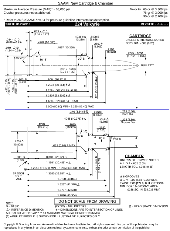

Your 224 Valkyrie is intended to have a MAP of 55 KSI, but try to remember that it may want less in a semi-auto. You may find an adjustable gas port is an advantage, maybe not.
In addition to the lengths, watch this 0.4207 diameter and the 0.4031 diameter before and after firing. Do your "paper clip" inspections every time on a small set of brass that you run several times and learn when to retire the case well ahead of case head separations.
