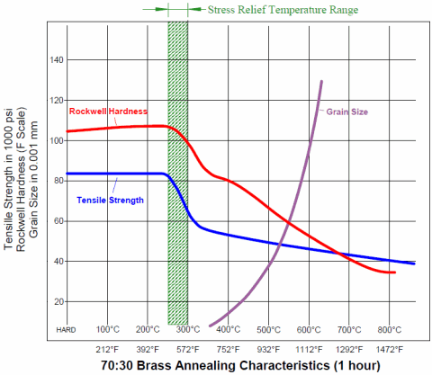

Interesting, seems like it gets a little harder first:
1616331477614-gif.7586967
Probably not enough to cause the OP's issue though.
No. As already stated, brass can only harden via working.
