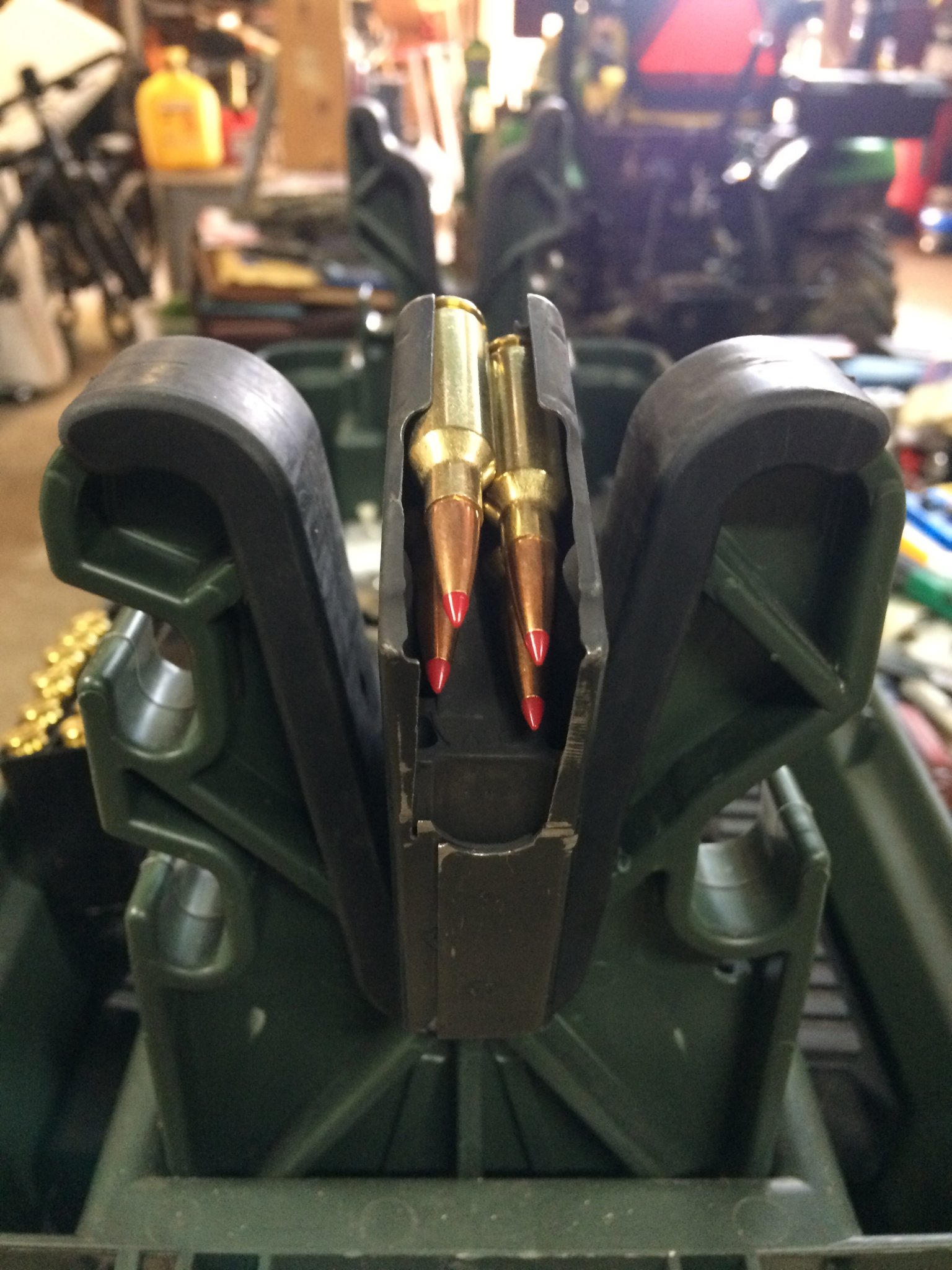

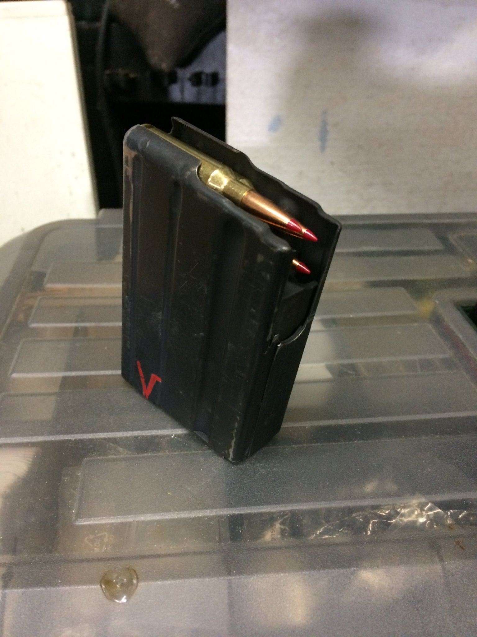

I made my own cavity back mags.
I drilled a 5/8” hole in the front of a Valkyrie magazine, then cut the edges down to blend into the hole. I can load 6-7 rounds in a mag, but I can load as long as I like.
My 95 grain loads don’t stick out to far.
Take a spare steel mag and give it a try.
Pic? I can't envision what yer describing....

Into the uncut ASC's? I got 75ELD's in there but the case mouth was slightly over the ogive. Didn't matter though as the 75's wouldn't shoot that far from the lands.
But some of the mag friendly heavies benefit from longer loading. The 77 TMK, 73 ELD and 77 RDF are all pretty long and the extra .05" the ASC mags gets helps free up room for powder. They are all pretty jump insensitive so accuracy wasn't noticeably improved. I can't remember what velocities were exactly but I know the extra powder I could fit in was always good for at least 50fps.
Cutting mags is when it gets interesting. 75 ELD's can happen. Then filing magwells gets you into 80 ELD or 85 RDF territory. I'll be testing both in the future.
