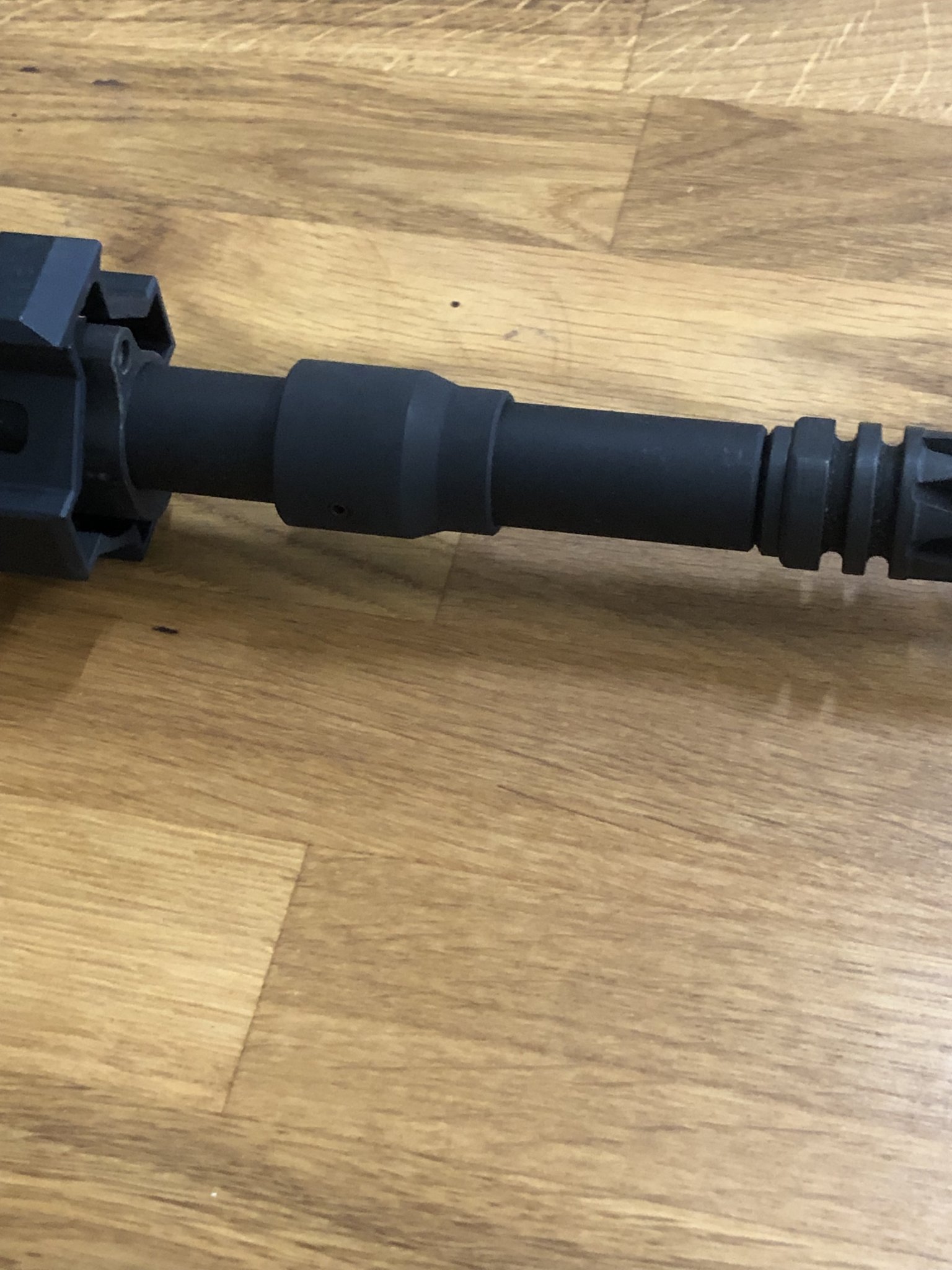

White oak still makes that 16" spr ops barrel it's 295$. I recently bought a green mountain 18" spr barrel off their website and it seems nice. Put it together and shot it the other day to ~700 was 4.5il drops with 69s so faster than my 16" which is 5mil same ammo. This one right here:
Finish is a dull phosphate sorta color not black shiny like in that pic, the bore, gas port, crown all looked really good/clean nothing weird like crap in the bore or whatever like you see with some other cheaper companies:
still might need to have it slightly recontoured though won't know for sure for a little while yet
Reactions: dogman
