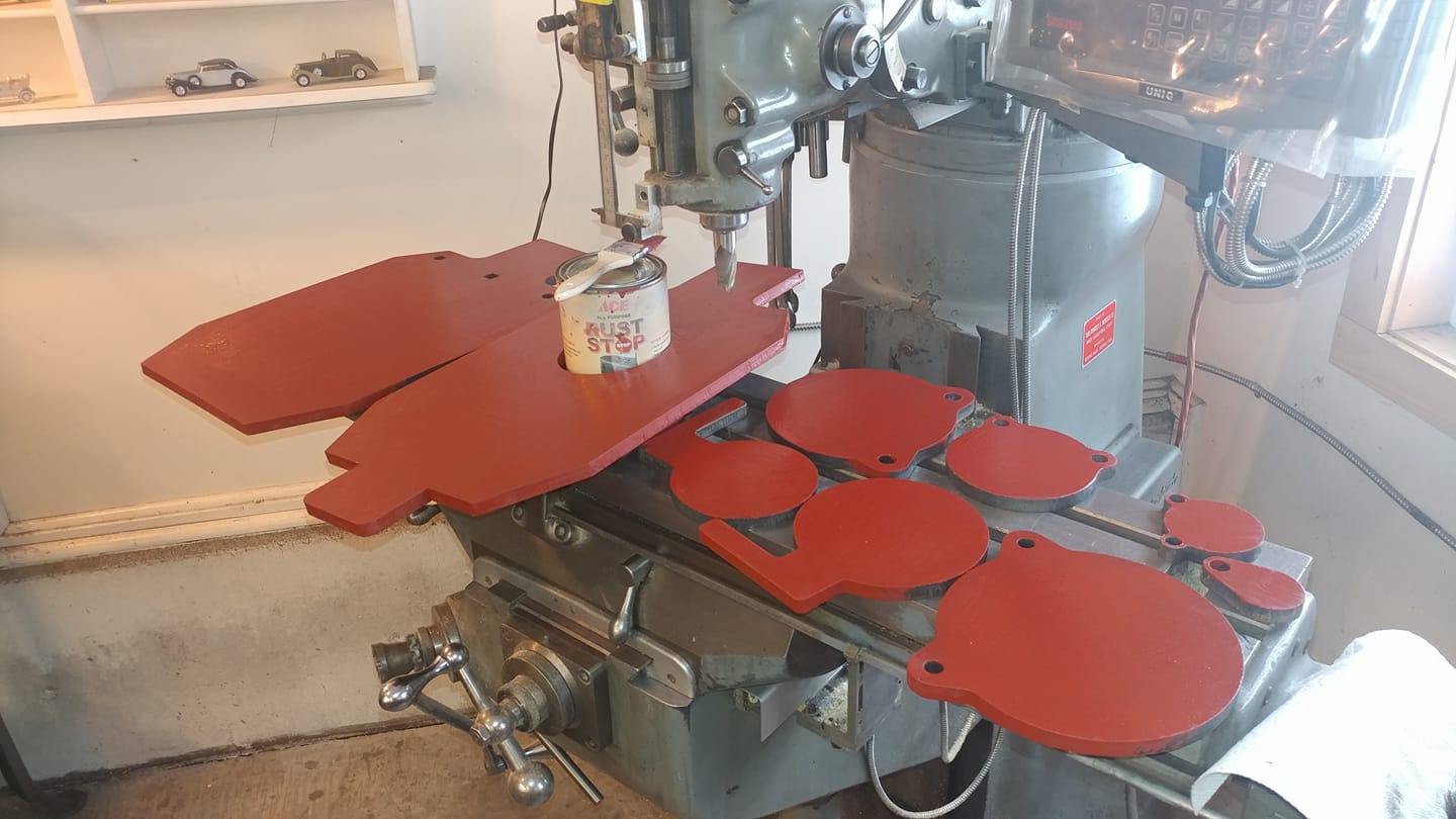

This is about half the targets that Busenhalter-6 got me last Christmas off eBay.... for about $300. She is so cheap, that when she spends a nickel, Jefferson screams.... so hard to argue with the targets.
These along with a bunch of mil targets are all scattered around Schloss Nitrocellulose. I did weld on some posts... and make some stands.
But I could not have bought the consumables for a cutting torch for what this whole pile cost me.
Just 'sayin.
