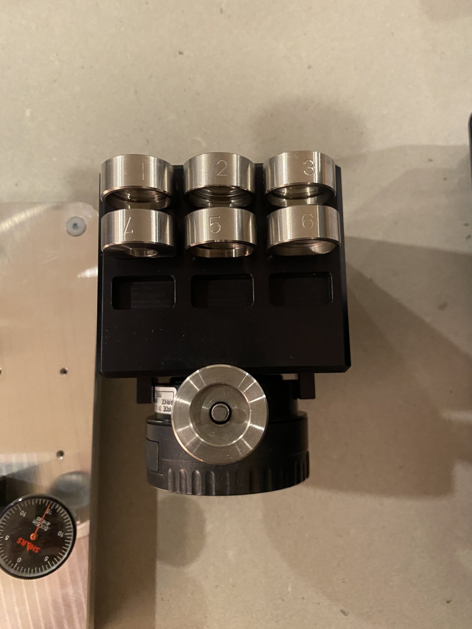

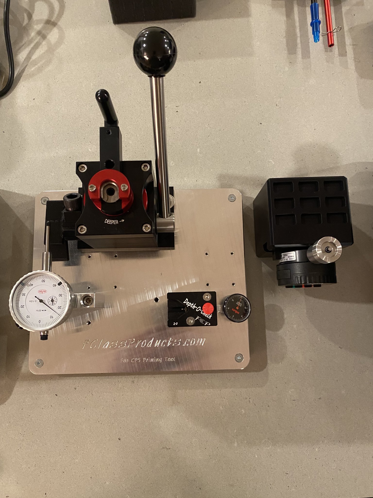

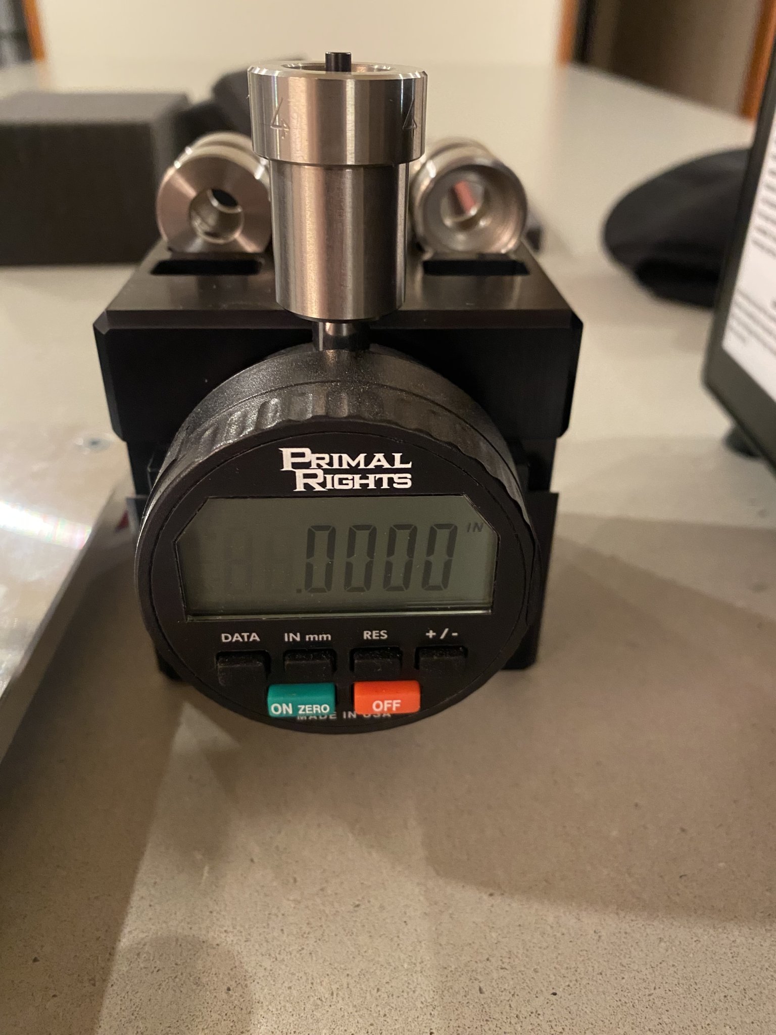

This is the Greg’s evolution of the CPS primer seater system that we all love so much
The Primal Rights PrimeWhere measures 4 parameters to the 1/10 of thousandth (.0001)
- Primer pocket depth
- Primer height (how tall your primer is)
- Seated primer depth (depth below case head)
- Amount of primer “crush”
And it does it rapidly making OCD level loading time efficient
For example let’s say your primer pocket depth is .131
You measure your primer and it’s .129
You seat .002 below flush and your primer is just kissing the bottom of the pocket
Or you seat .004 below flush to achieve .002 “crush”
Ok fine
Next case measures .129
You grab a primer and it measures .132
Then what? You put this specific primer to the side in a pile that says .132
You grab a different primer that can achieve the amount crush you desire when seated
This scenario of dimensional discrepancy occurs on the regular, right in front of the hand loader, without it ever crossing their mind
