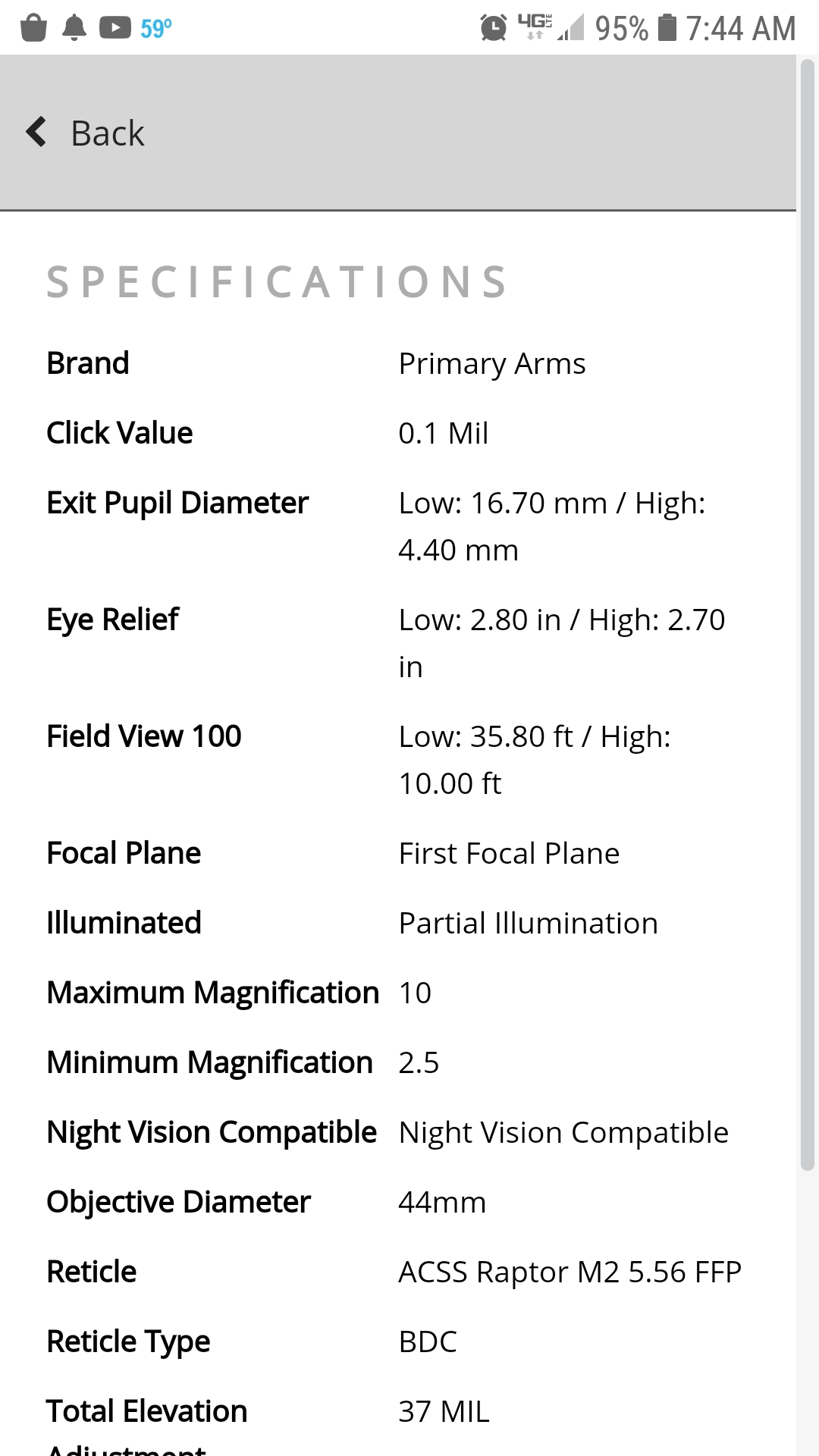

He does specifically say 2.7-2.8 inch eye relief. That is rather short, but it seems they are geared towards SPR type rifles, shouldn't need a cantilever mount.
This is a screen shot from the scope's spec sheet.

Weight is decent (lighter than their 1-8x!) but no "length" in their specs, looks fairly short. I'm hung up on the reticle though. They put it what appears to be really nice turrets only to handicap it with a reticle that cannot be used for dialing elevation and holding wind. Who dials wind in any dynamic sport? The BDC reticle they are currently offering also doesn't seem to match with the philosophy of the upgraded turrets.
