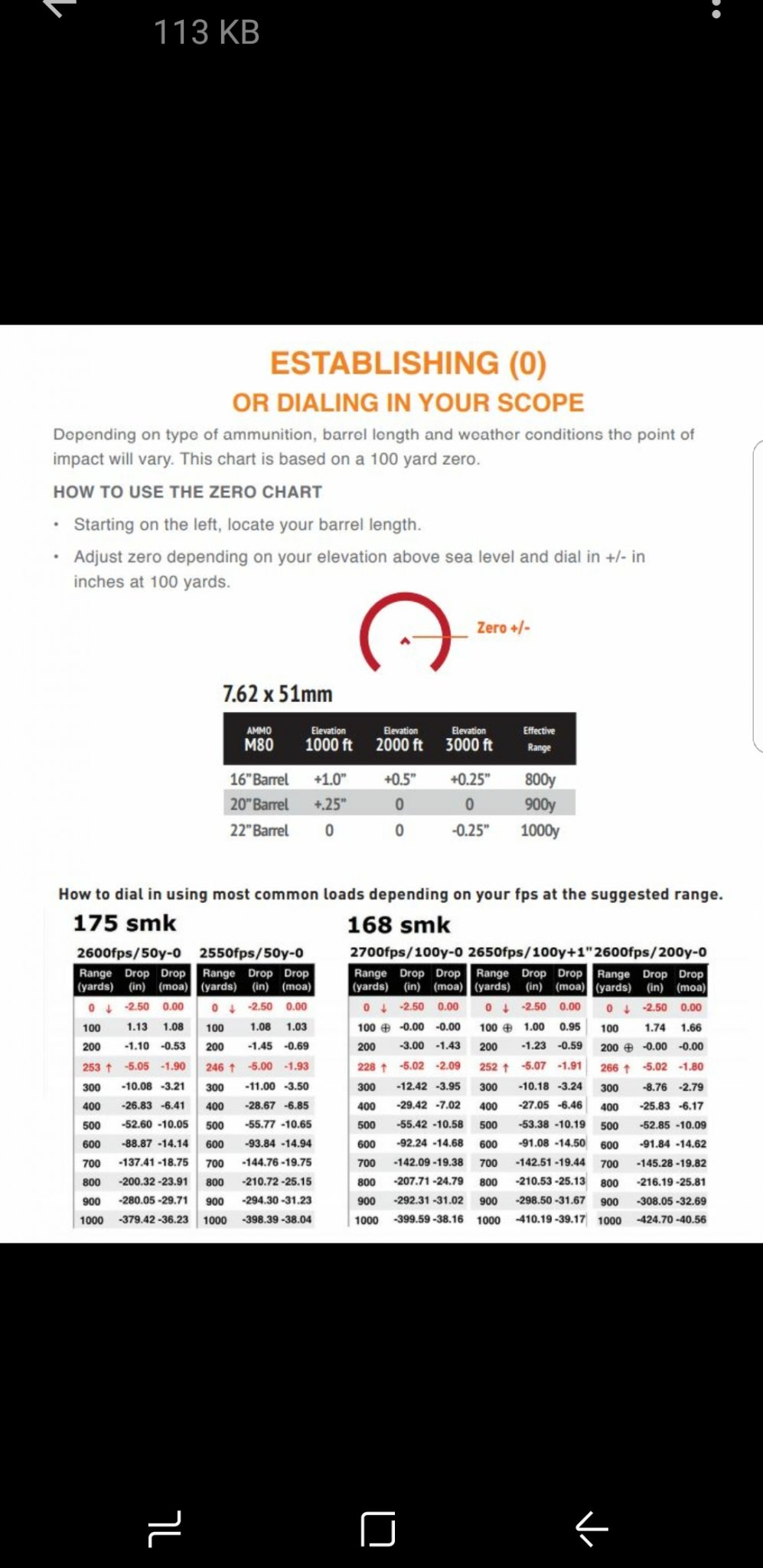

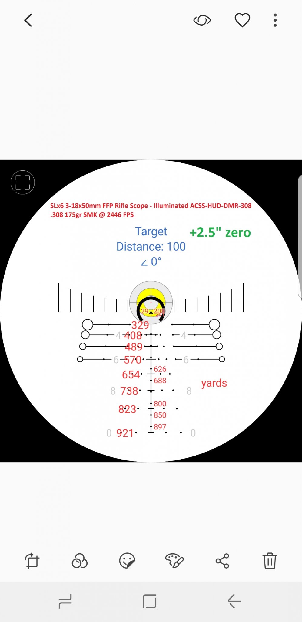

Ok I know I'm going to get hit with the don't buy bdc reticle. I wanted a small fast compact DMR rifle in 308. I have a dpms g2 with ranier ultra match barrel in it. This rifle runs like a champ! Not 1 ff or eject. Sub moa with no effort and is not picky with ammo. I bought the new primary arms glx 6x24 hud dmr reticle. The scope is sooo clear and I have no complaints with any part of it except this. Right now I'm running 175gr smk over 43.5 rl15 fps 2446 10 shot average. So first range day I zero at 100. I then proceed to stretch it out. WTF!!!!! ITS NOT EVEN CLOSE!!!! So I start reading everything that came with the scope and going back over vids from rex, country mash, and gotaboy32. Next I email primary arms. Darrel is AWRSOME!!! he got right back to me sooo fast!!!! What CS!!! If I sight in at 100yrds 2.5" high at 100 that's the best the scope will match up. Darrel sent a pdf with what all the drops would be. I was shocked at how far off it is. I asked PA what fps and bullet grain was this scope made for? So for a 175gr smk you need 2700fps to match up!! Why is this not up on there web site right under the scope? I would NEVER have gotten this scope!! He'll federal gmm lists there fps at 2600fps out of a 20 barrel if I remeber correctly. My loads show no presure signs now but there is no way I can get a 16in bbl to go 2700fps without a BIG BUDDA BOOM!!! this scope is a great scope but why would they not configure the reticle to what the majority of 175gr ammo is shooting? Anyone got any ideas? I love all the ranging features of the hud dmr reticle but now its totaly useless to me and anyone not running a 24 or 26 inch bb and hot loads. I guess my idea of a dmr rifle is different than primary arms. Anyone got any ideas that don't include me losing a bunch of cash. Ok I'm ready for the beating to start!! Flame away!!!!

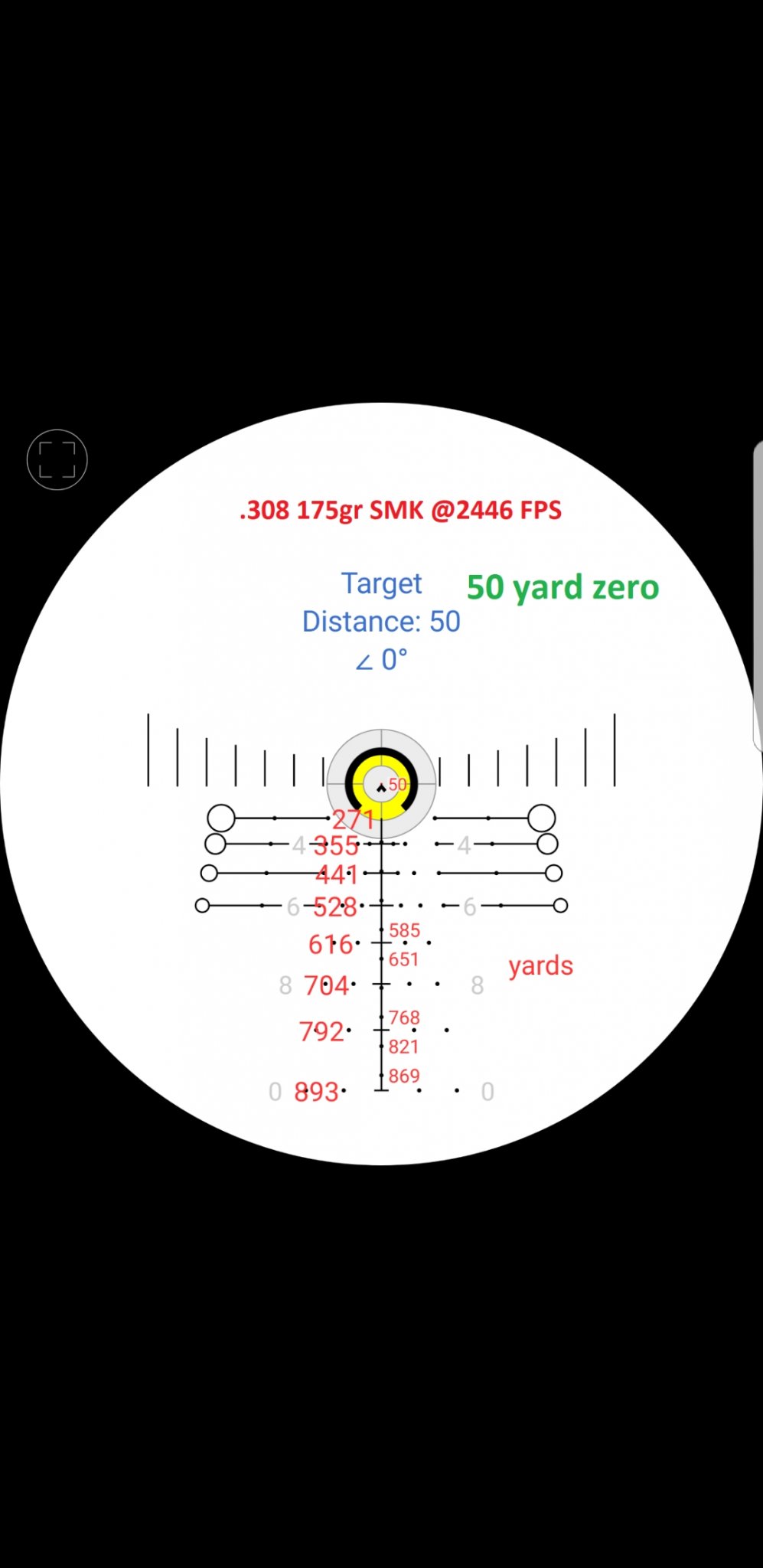

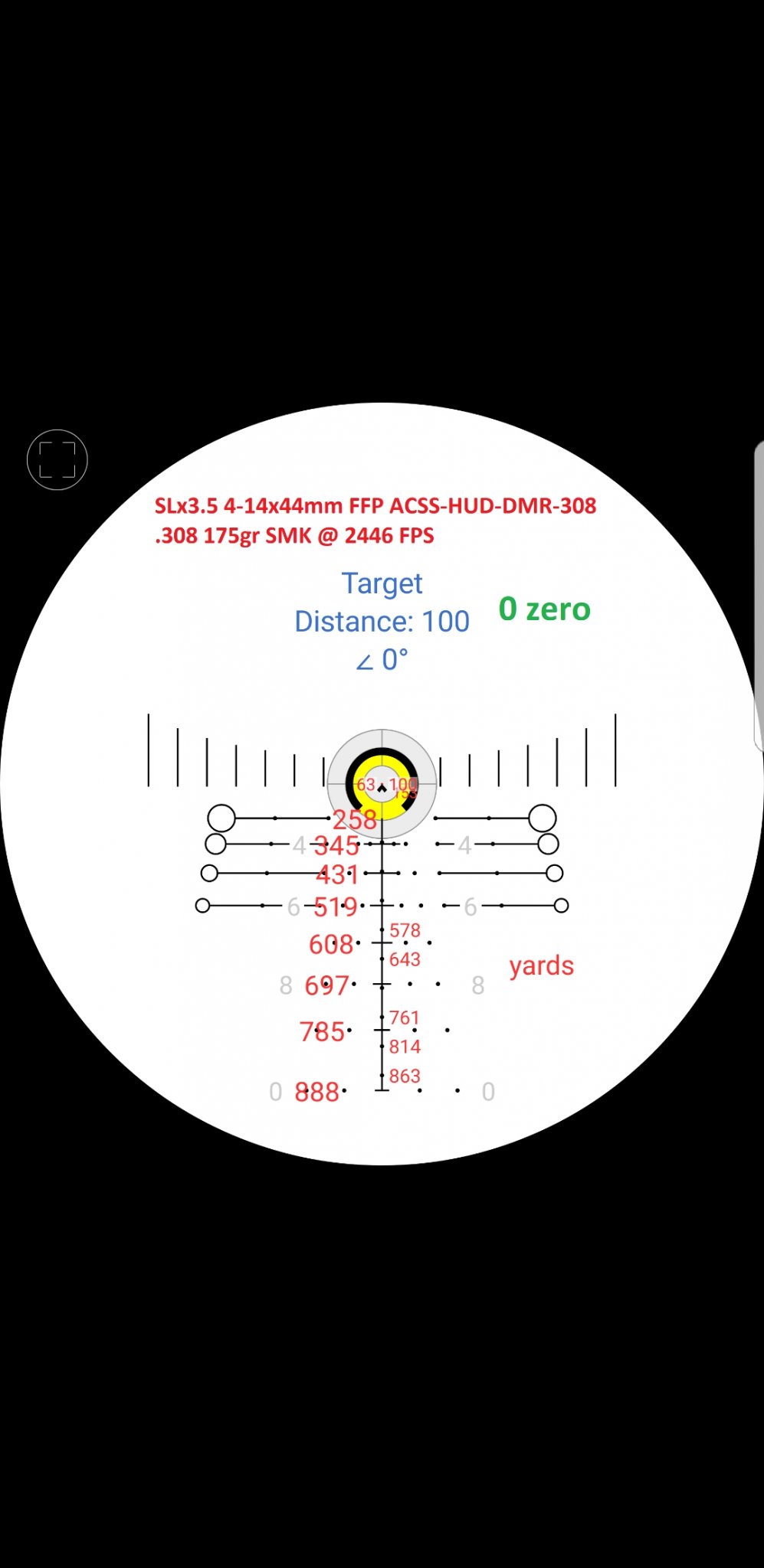

It doesn't need to match up. As pictured above, it doesnt need to be on 100 yard increments. That's unrealistic, and it pigeon holes you into trying to match ammo to a reticle, which is silly instead of shooting the best ammo for the rifle and knowing your holds.
Each subtension of your reticle has a corresponding holdover in moa or mils. Simply match your dope to you reticle. If the first subtension down is 1.2 mils, and 1.2 mils is your 320 yard dope, then that's what the first subtension equals.
It's really quite easy.. You'll get used to it in no time.
Reactions: GLD1980 and rhsc
If I wanted to do all of that work I would have chosen a different reticle. The reason I chose that reticle was for Speed. And the fact that an inexperienced user could pick up the rifle and with very little practice achieve hits out to distance

But you're really missing the point here if you think those lines need to correspond to every hundred yards. We can thank the military for dumbing the ammo and reticle down to this point so even inexperienced shooters can easily adapt. People erroneously think all BDCs are supposed to be that way, and idiotic optic manufactures even promote it this way, and then multitudes of fellas like you come on here upset that it doesnt all line up. Well it very rarely lines up. Luckily, you dont need it to. In fact, it works much better if you dont even try.
I shoot 3 Gun with BDC reticles, most everyone I know uses them. None of them line up at 100 yard increments. No one is dumb enough to waste all that time tinkering their ammo to make that happen. You shoot the right load for the rifle and learn your dope. And I've yet to see a shooting sport that utilizes a BDC for speed at multiple ranges like 3 Gun does.
Even if you get it lined up at 100 yards, it doesnt stay that way. Velocity will vary based on lots of variables, if you always expect it to be spot on, you'll be disappointed. Whereas if you check your velocity, run a new dope on your ballistic solver and adjust accordingly, it will always be right.
Trust me, dope the reticle to your rifle. Not the other way around.
Reactions: Rob Hamilton
It's impossible to set a reticle to match all rifles in general when all rifles in general are so different. Different barrel lengths, different actions, different wear on the barrels, shooting different loads, different bullet weights, different MV, different powder charges, etc. It is stupid silly to think you can just buy a BDC reticle scope and expect it to match directly to your shooting.
I was not expecting the reticle to match up exactly pinpoint accurately. I was looking for minute of man. I was expecting the BCD reticle to at least be able to hit a uspsa Target not head shots. 18" x 30". A simple disclaimer on their website under the scope stating that for this reticle to line up perfectly your 175 grain smk must be going 2700fps would have been very helpful.
1. Shoot the rifle over a chrono, magnetospeed, Labrador, etc.
2. Plug that into you ballistic solver of choice.
3. Determine the subtension of the graduations in your scope- in mil or moa.
4. Match those numbers to your dope.
5. Write those yardages on one of those "dope discs" that fit into an eyepiece scope cap.
6. Put the dope disc in your eye piece scope cap.
And, don't buy scopes with BDC reticles.

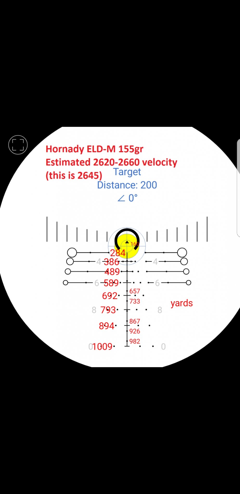

BTW... Not sure what your definition of 'DMR Rifle' includes but a 175 at 2400fps ain't it, your BC is for shit at that velocity.
If you're going to run a barrel that short I'd work up a load with 155 Palmas and that'll get your MV back up where you've got some lead in your pencil.

I only lied to women about my penis size! Never about guns! LOL

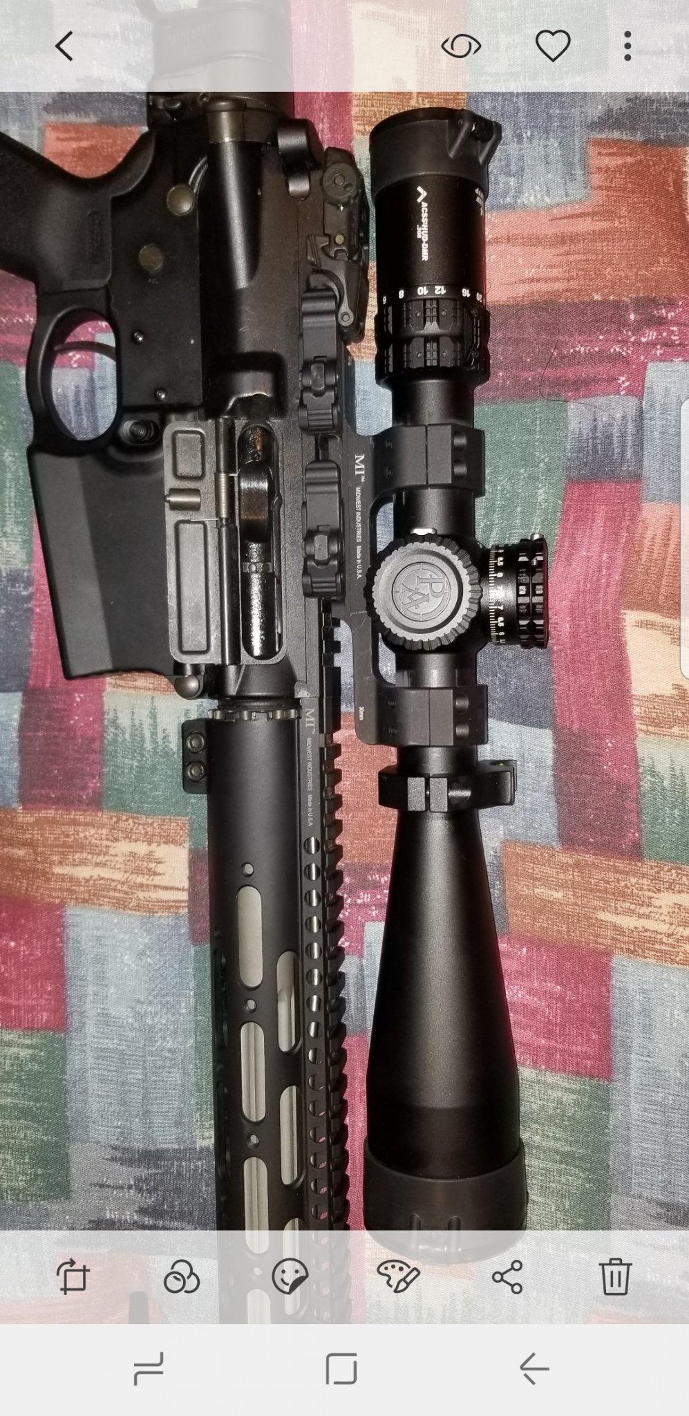

I just got an email from primary arms apologizing for giving me wrong information. It is not 2700 feet per second it's 2600 feet per second and yes the Hornady eld-m 155 grain matches up better. Only problem is Hornady ELD m-155 requires a 1 in 12 twist. I have 1 in 10. I've called proof research and hopefully they have a carbon fiber Barrel for my G2 . I'm sure they will get back to me tomorrow. I will be looking for a 18 in Carbon Fiber barrel. According to the chart if I get the 18-inch barrel ill easily Attain the FPS that will correlate to the reticle much better. Or at least good enough for what I want. Once again thank you primary arms for all of the effort and follow through! What fantastic customer service!!!!! I told the service rep if you ever take a trip to Hawaii give me a call and I will hook that gentleman up!
Your 1-10 twist will handle a 150 grain just fine.
The problem is you have a primary arms scope, swapping barrels wont fix that.

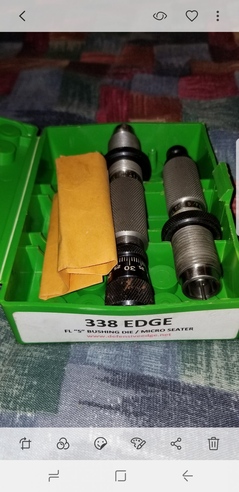

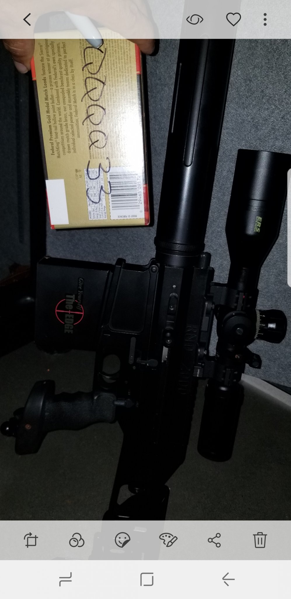

I now have multiple options thanks to the many knowledgeable people here. I have money to burn! you never know I might just buy two barrels one for 155 grain ELD match and one for 175 grain Sierra matchking with an 18-inch barrel letting me push the FPS much higher and closer to 2600 feet per second. Time will tell! this will be a very fun project! It's not like my life depends on it! LOL im just another Joe six-pack trying to have a good time playing around with my hobby! Aloha from hawaii!!!!
You can get the 2600 easily with the 168 ELD M which matches very nicely with the BC of the 175 SMK.
It's not just velocity, you also have to consider BC.
You'll easily be able to exceed 2600 with a 150 or 155, which, in light of the lower BC, may still match up.
Reactions: GLD1980 and qqqq33
168 eldm out of a 16"bbl will get to 2600fps? I'm asking because I have absolutely no experience with 168 grain Hornady Eld ammo. Thank you for your time brother I really appreciate it! I've been a member here for a long time but I hardly ever post. I don't feel like I have enough knowledge to add anything constructive.
All right I have given up on the 16 inch barrel. Ill call up Craddock Precision and have them spin me up a 18 inch barrel. As per the advice of experts from snipers hide I will be switching to the 168 Hornady eld-m. Just ordered 500 heads from Powder Valley. Thanks everybody for all your help I really appreciate it! Once I get everything going I'll post some pictures of groups and velocity from the Magneto speed. Thank you and aloha!
45 grains of either varget or imr 4064 will get you very close. both are known as accuracy powders.
