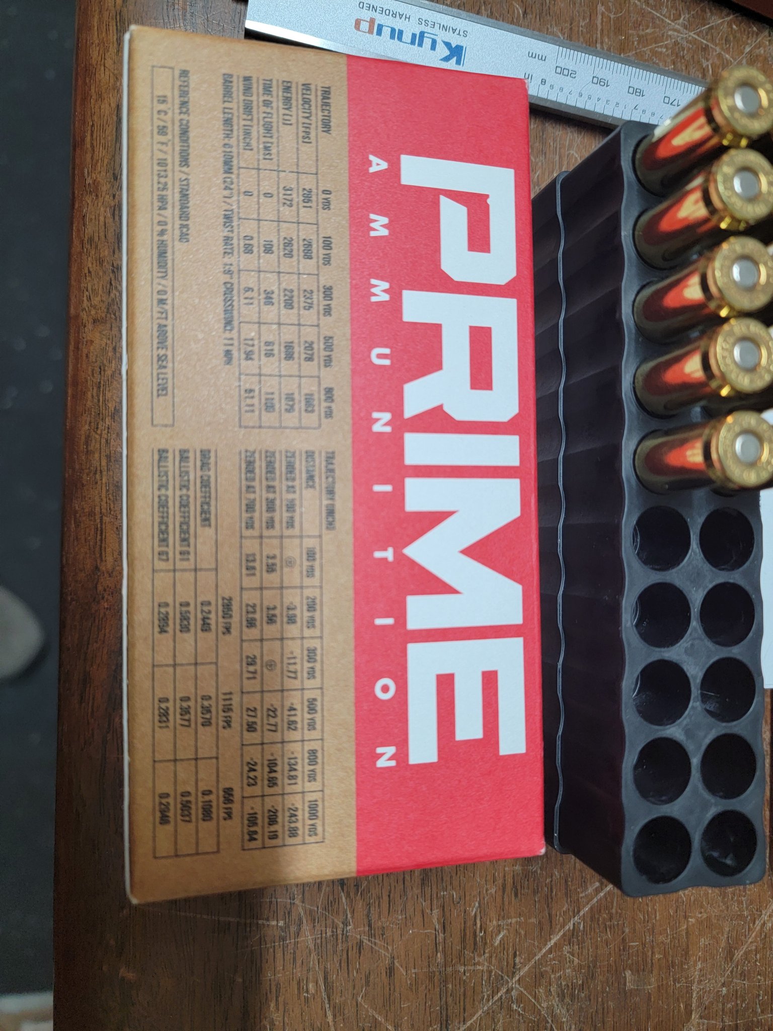

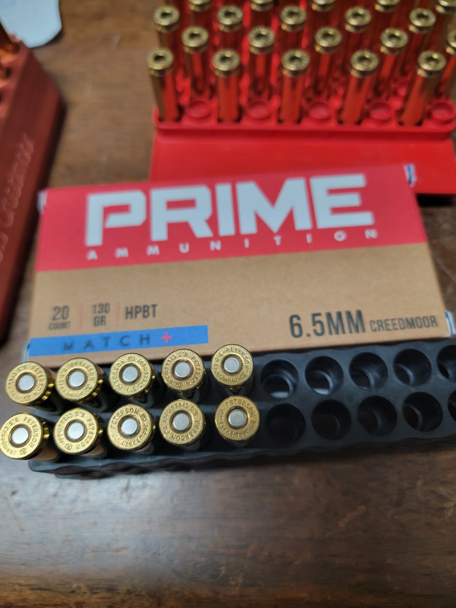

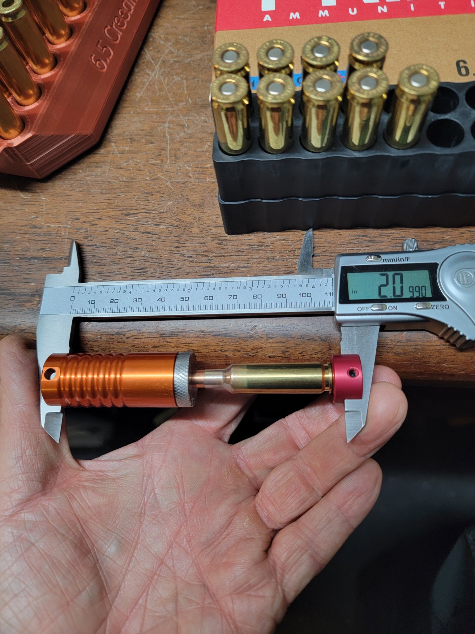

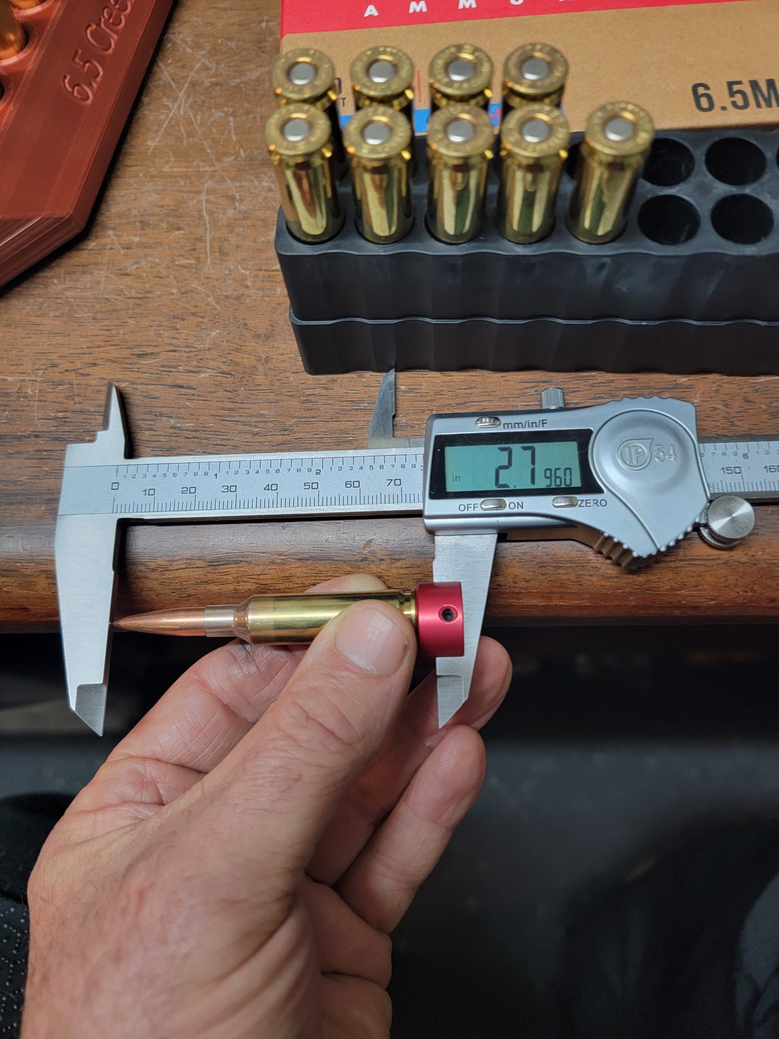

    I have a few boxes of the post norma prime 130 - here are a couple quick measurements - peterson brass but I don't know the bullet manufacturer
