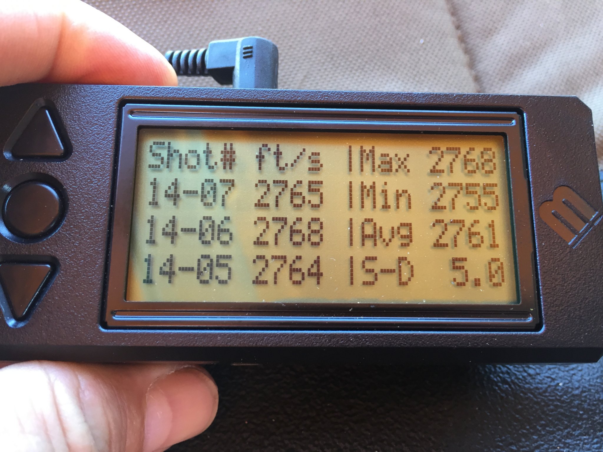

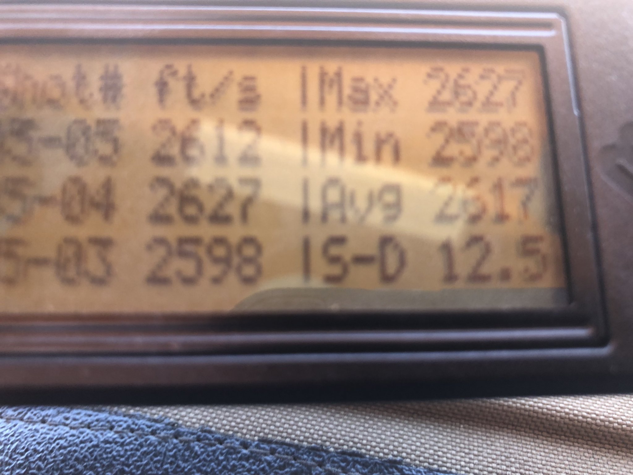

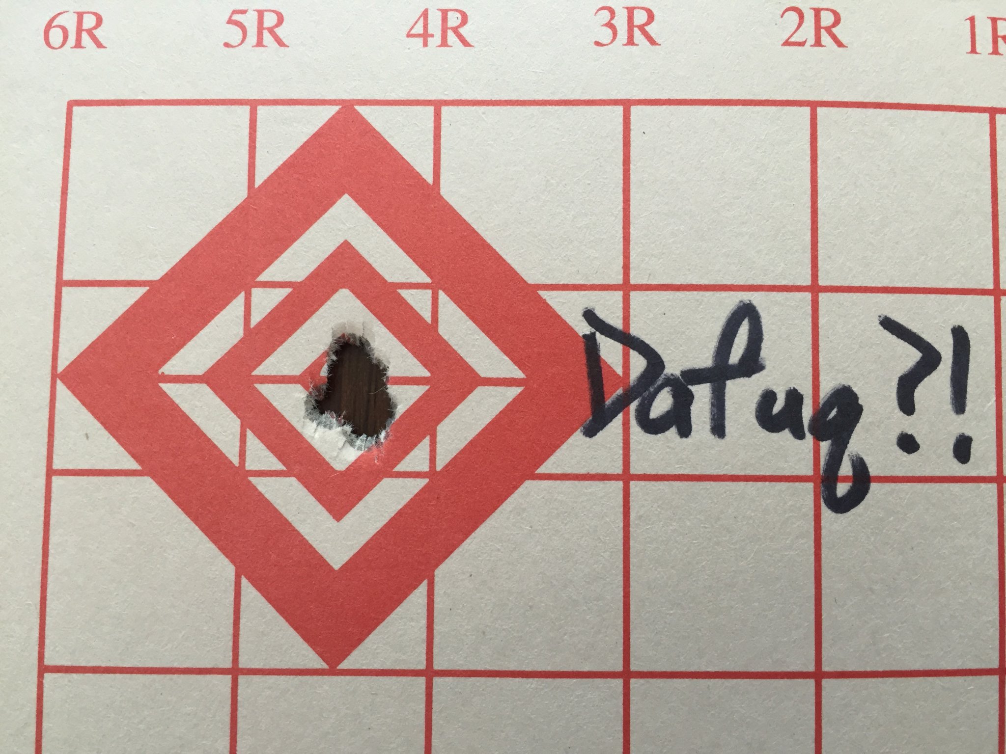

I took a class this last weekend and due to circumstances wasn’t able to hand load enough rounds for the class so I bought 200 rounds of Prime 130gr 6.5 Creedmoor. At the class we verified zero then went straight to a target at 1073 to true the Kestrels, my windage at 1073 was dead on but my elevation was almost perfectly bracketing the target but very few hits, lots of long and short. Not knowing WTF was going on I took out my Magnetospeed V3 and threw it on the rifle and after 10 rounds my SD was 25.3! I had a box of Prime from a different lot of ammo that I kept separate so I chronoed 10 rounds from that box and the SD was 27.2! Thank God I brought a backup rifle and ammo and proceeded to hit 5/5 on a torso sized plate at 800 with a RRA Predator Pursuit and 73gr ELDMs.

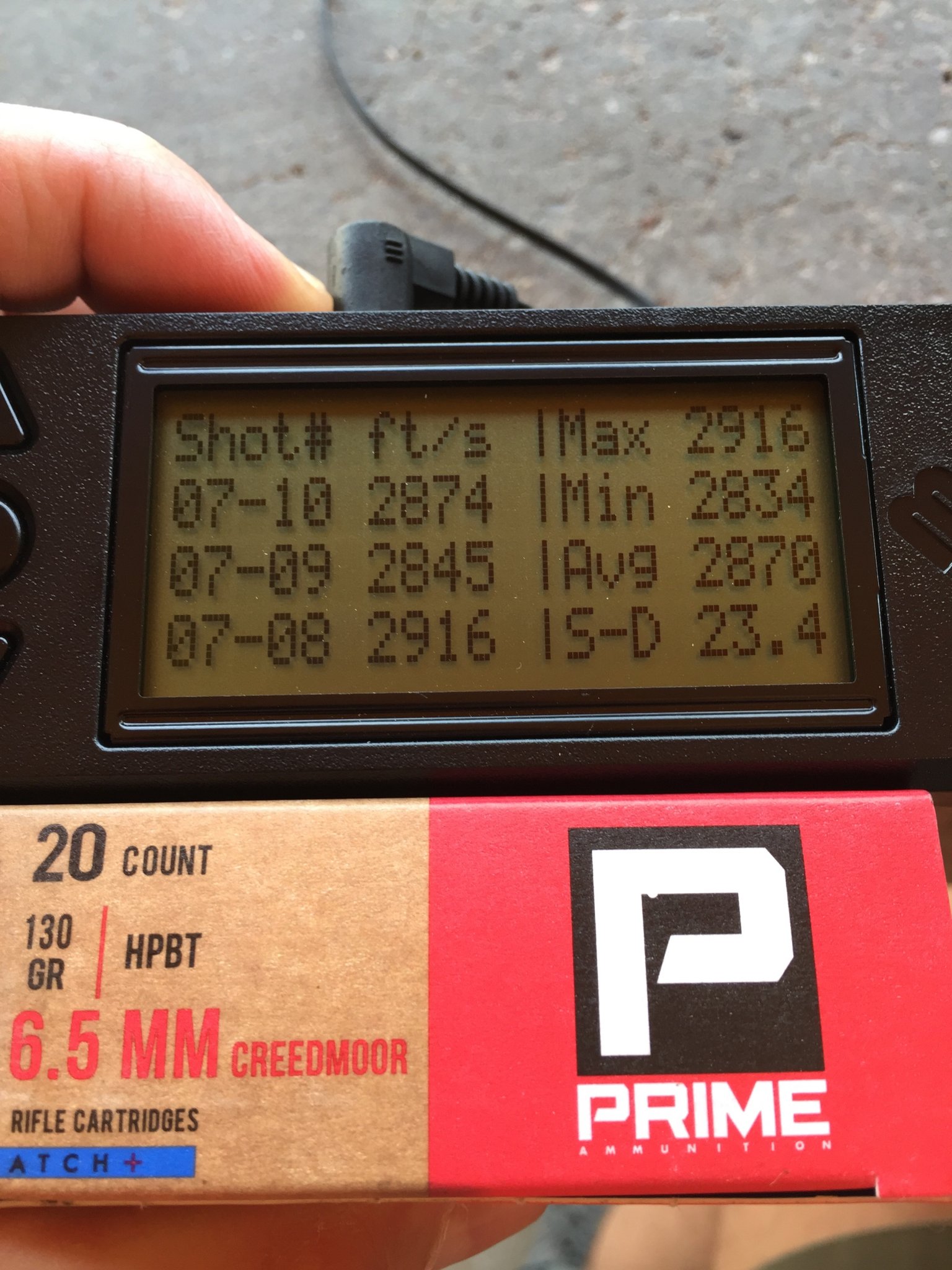

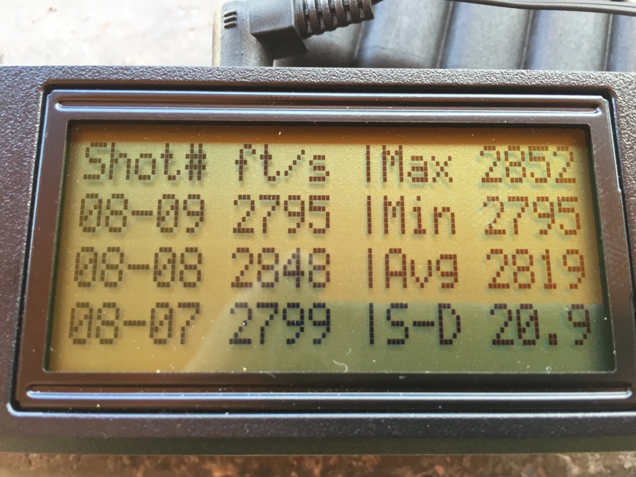

I took another box from the same lot out today and got this.
To say that I am disappointed is an understatement.
One thing that I do want to mention is that LowLight repeatedly has said that you need to shoot much farther than 100 to know what your rifle and ammo are actually doing and I can’t agree more. With an SD in the 22s (which is bullshit) I shot this group at 100 but with that variation in muzzle velocity couldn’t hit a cow at 1000.

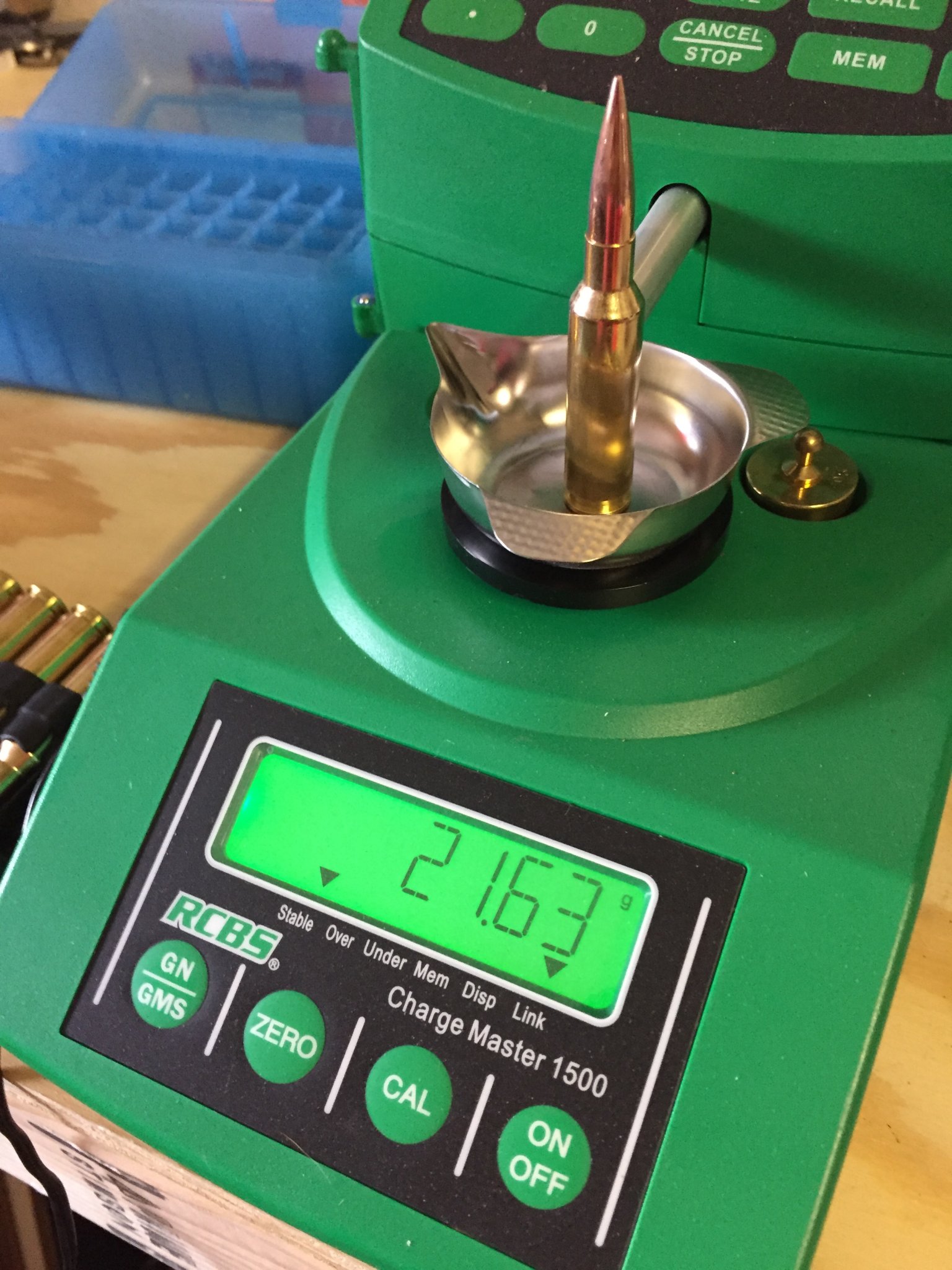

I came back to the house and decided to do a post mortem on 10 of my remaining rounds.
All weighing was done on an RCBS Chargemaster, cases and powder were centered on the tray before weights were recorded.

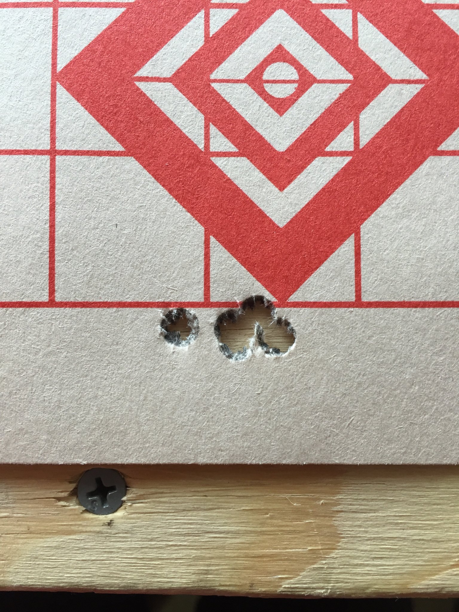

I loaded 9 of the pulled cases to 42.5gr to the individual kernels of powder and re seated the bullets to the same length and shot them today from the same bench in the exact same seated position with the same rear bag making every effort to duplicate the recoil management of the chrono results above. I even fired 5 rounds before I chronoed because the first group was from the middle of my original shooting string. The results are better but I’m still not satisfied.
And to reiterate what @Lowlight has told us repeatedly, shooting a 100 yard group doesn’t tell you much at all about what your rounds are doing past 1k. This group is from the same lot that was giving me an SD of 22 and change from the same barrel, looks great at 100 but still lands 8-10’ short or long at 1073.

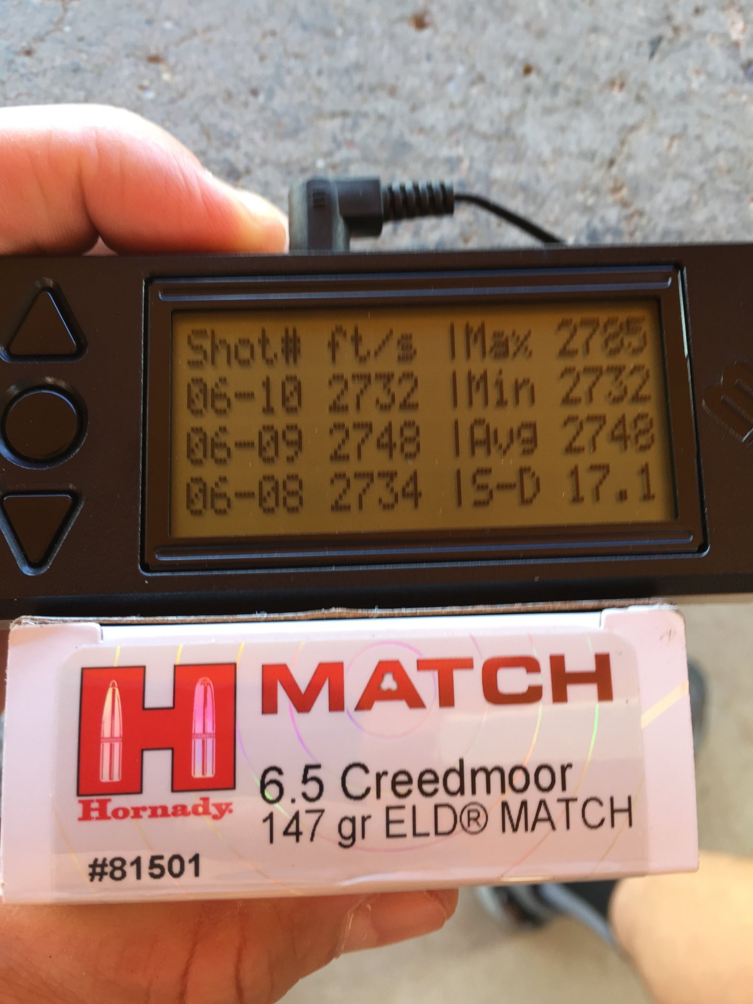

Resurrecting an old topic, todays results were from a box of Hornady 140gr ELD-M, I’ll get my booger hooks on a box of Prime this fall and see what results I get now that they aren’t using Norma as their manufacturer.
