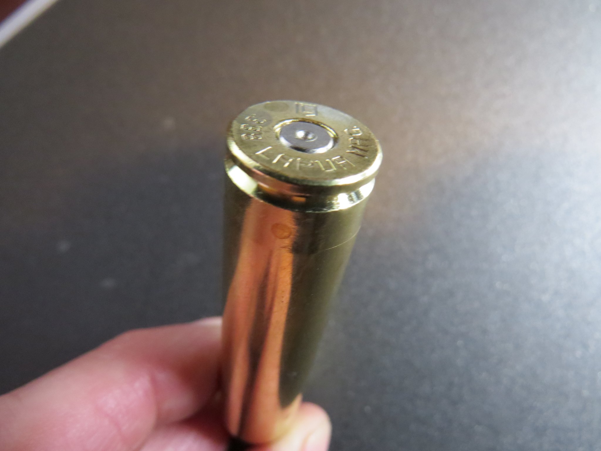

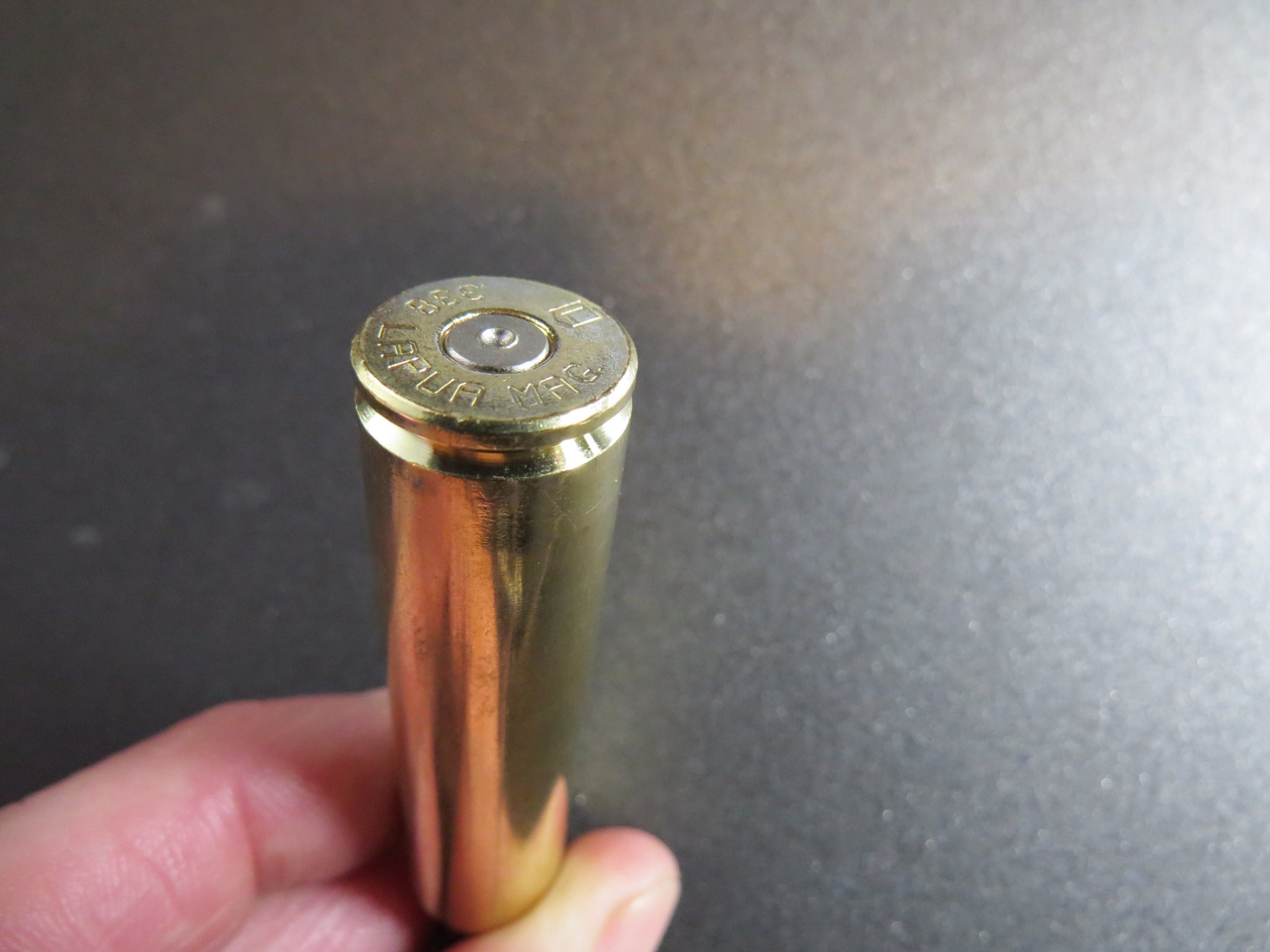

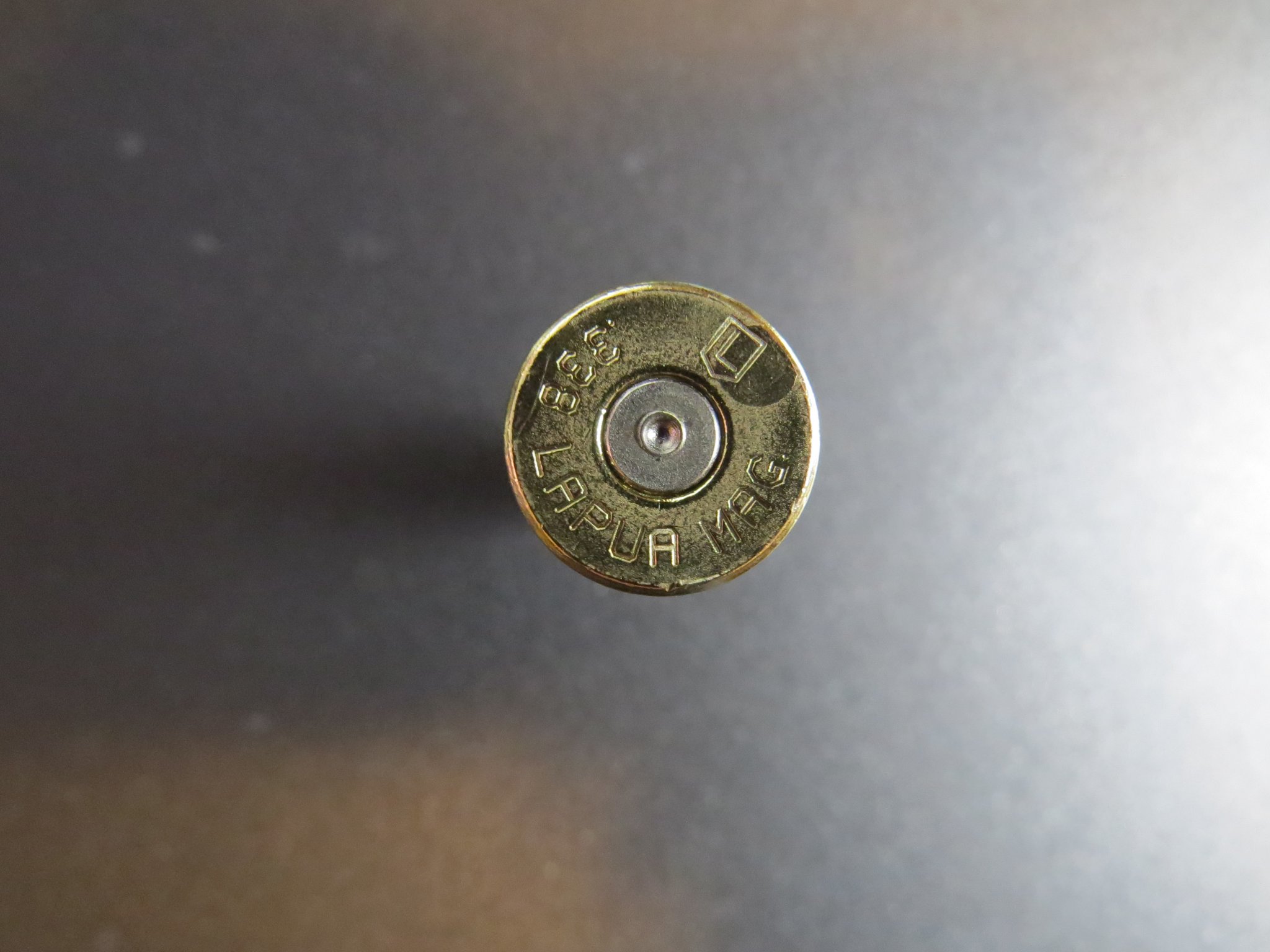

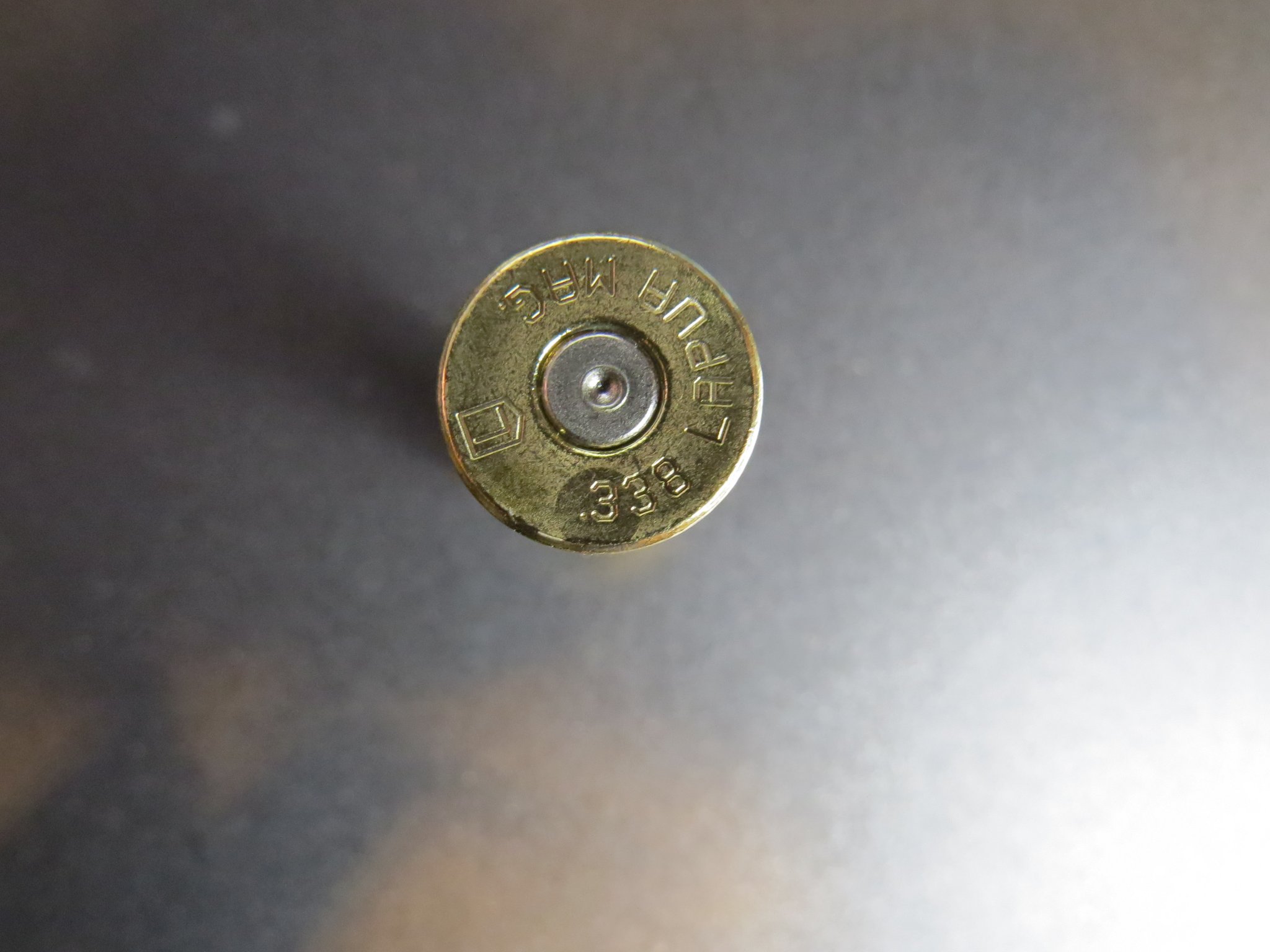

    There's 4 (four) hi-res pictures attached. The first two show Case #1 in which there appears to be some cratering but the primer itself feels flat/smooth to the touch. The next two pics show Case #2 which definitely looks like cratering and there is a distinct edge that you can feel. I'm trying to figure out if Case #1 is considered cratering or just a heavy firing pin strike?

    Yes, that would be considered cratering. Don’t worry about it. Worry about the case head separation case #1 will have the next time you fire it.
    May just be your bolt face finish, but to you always get ejector marks, regardless of pressure?
    I saw the same thing as suoersubes. Are these once fired? There appears to be two ejector marks on this particular case … one just left of the Lapua trademark, and one somewhat centered over the “3”. Although they look different size. Did you perhaps buy once fired brass from another rifle or fire it in different rifles?

    The other mark you see is the cutout in the bolt face for the extractor. The shape looks very AXMC to me. But wait, he’s a lefty....

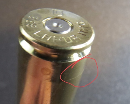

    It's brand new brass, never fired. The part circled above is a variation in the color of the brass from shiny to somewhat dull, it is uniform on every case. Yes, I looked at some other brass fired yesterday at lower charges and I can see the ejector mark on pretty much every case.
    Correction; that was a line, but it appeared to be just a scratch on the surface. I was able to wipe it smooth with just finger pressure.
    I bet its that its new brass that isnt tight in the chamber so when it gets fired it has a bit of a running start to slam back into the bolt face which is causing the ejector and extractor marks. How far forward did the shoulders blow from virgin brass?
    That said.. they are still pretty hot loads to leave the marks.
    If you are getting marks you are over pressure even if you arent catastrophically so yet.
    The shoulders measured virgin at 2.2695" and fired at 2.2735" (+.004"). I tend to be ultra conservative, if that's cratering (I think the consensus is definitely "yes") then I will be backing way down and crawling back up very slowly.

    That line around the case head is more than likely from sticking the case back into your ammo box primer side up. It taps back and forth in the square and puts a ring around the case. I get a ring like that around my larger brass if I leave it in my ammo box for awhile. I about freaked out thinking a ton of lapua brass was about to fall on the 3rd firing but as you saw it wipes off.
