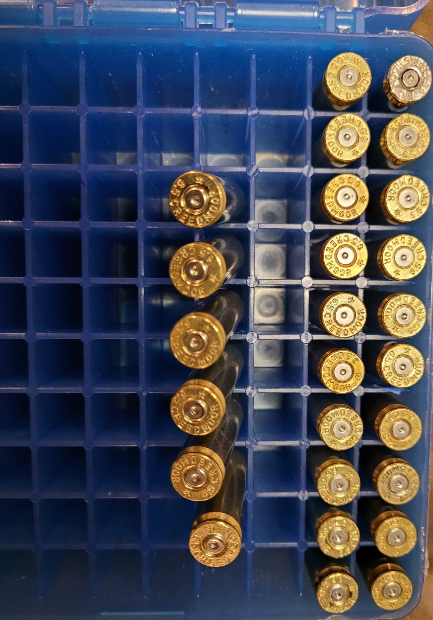

    So, I just got back from @CR2 SS low light class (which was awesome, definitely would recommend, and I will definitely post about it in another thread), and I had a total of 6 primers out of right at 200 rounds that didn't go bang.
    Main Question 1- I've never had a primer not go bang on hand loads, and only a handful of times with factory center fire loads over many many years. How is it that I had so many this time and how likely is it that this issue has infected my whole 1000 pack? Can I do anything about this going forward? Will manufacturer do anything?
    Main Question 2- how risky is it for me to use an inertia puller to take the rounds apart and get my brass and maybe bullet back?
    I have a really good firing pin mark on all of them, it's definitely not a light strike. These are not cheap primers or anything either (as if that even exists now days)
    This is a bolt action if that matters in this situation. I can post pics of said rounds if need be also.
    Thanks.

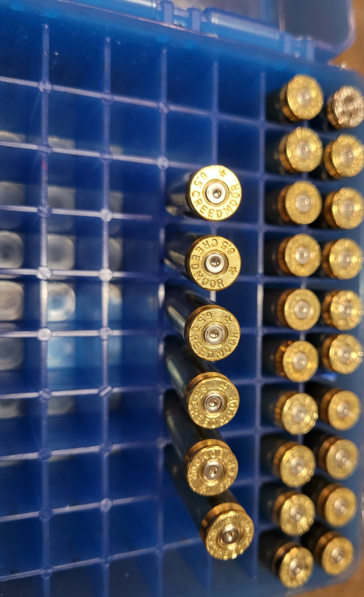

    This is 5x fired brass. Primers seated well and normal tension. I did note that one out of the 200 was a little easier to seat but not to point where it was like a loose pocket
    Here's some pics of the troublesome 6 as well as some other rounds that shot normally for comparison. You can see the difference in how the primer looks on those compared to the other normal rounds

    That's interesting , the bad ones look like a primer from undercharged loads . I am puzzled on this one . My first thought was excessive headspace with new brass but 5x fired rules that out.

    It's moisture. Im kind if shocked actually. So I went home to check this out since I was close by anyway and I pulled the bullet. The powder is all clumped up and it looks like some of it may have actually burned. Not sure how it didn't move the bullet though. It's not very much that burned and I guess since it was wet it didn't ignite as much as smolder or something. I can't belive that moisture was in there! I'm wondering if my kids opened up my drawer when I had all the cases in the loading tray and spilled some water in it or something???
    Anyway, mystery solved and it looks like the primers did do something. Once I missed a case when charging and I shot that one and the bullet moved enough to lodge it in the lands about half or a third of the way so, I don't think the primer fully ignited. Anyway, thanks for the input fellas.
    Oh also, I don't know why I didn't do it this way before but I did use my press to pull it. I extended the bullet through one of the empty holes that didn't have a die in it and used pliers. I guess before when I messed with it I didn't want to remove any dies to do it but I have an empty space right now so, no problem with that.
    Good to see you solved it . I commented early in the thread about the primers looked puffy like they had been shot in a reduced load . At least you know they went off and you don't have other issues.
