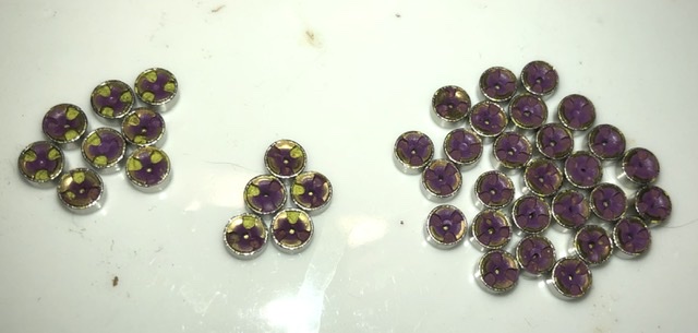

These are some Federal GM215M primers from the latest batch I purchased. I have seen the same irregular fill in their non magnum LE match primers. If this is what an experienced worker does I’d hate to see what the acceptable standard is for normal workers.
