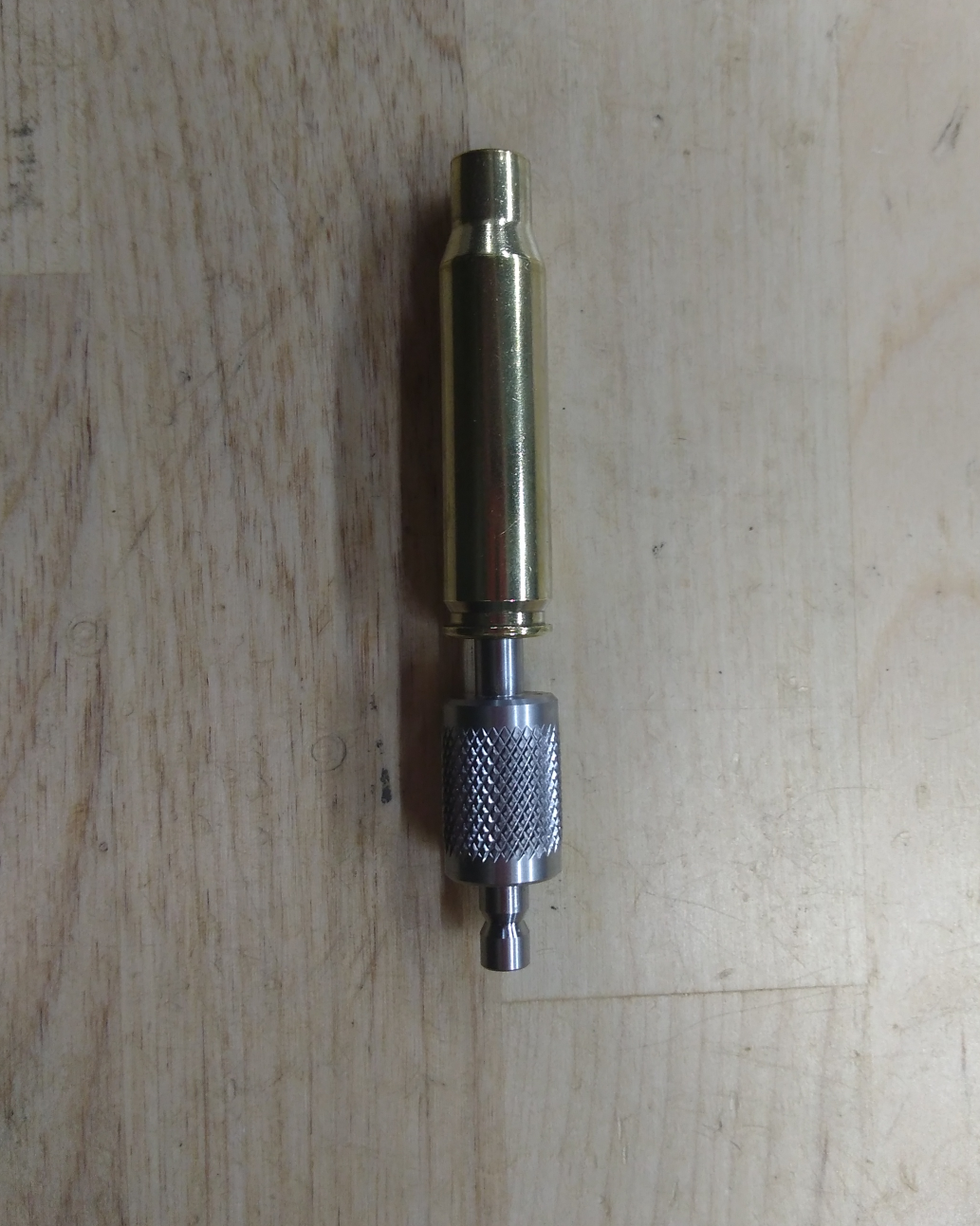

    Here is a Large Go gauge in a known good 308:
    Here is the same brass with a no-go gauge:
    If the tool was to go into the primer pocket, you know it is too large and brass needs to be tossed. This particular piece was very far away from being loose.

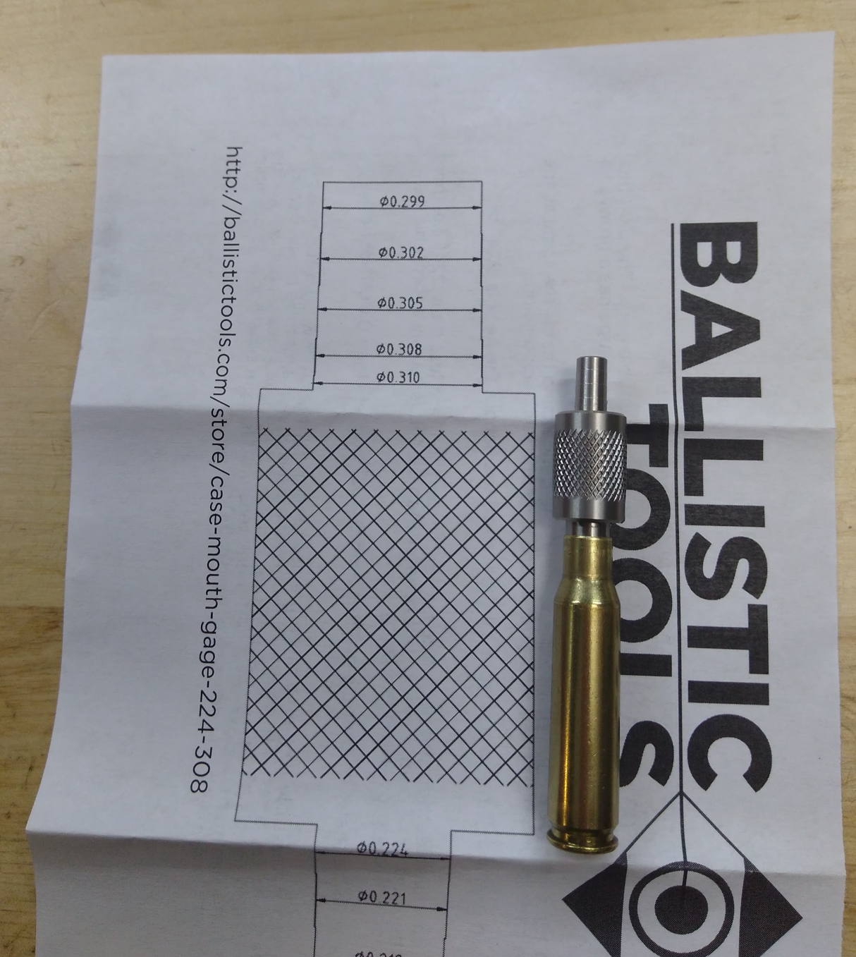

    Below is the case mouth gauge:
    As you can see, there are lines engraved on the the tool and they line up with the chart underneath telling you how large your case mouth opening is. I did check these with a mic and found them to be correct to 4 decimal places. One end is 30cal the other end is .22 cal.
    I bought all three tools for $29.99 bundled.....your price may vary upon when you see this. I think for the price it is an excellent tool. Since I shoot 300PRC and we are temporarily stuck with Hornady soft brass...it is a good tool to check upon every reload....after deprime...and well before I spend time and effort prepping the brass through the other stages. It is also great to check how much spring back you are experiencing when you size the necks...and when you may need to anneal.
