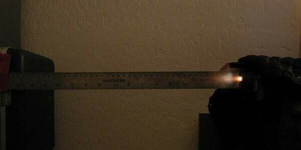

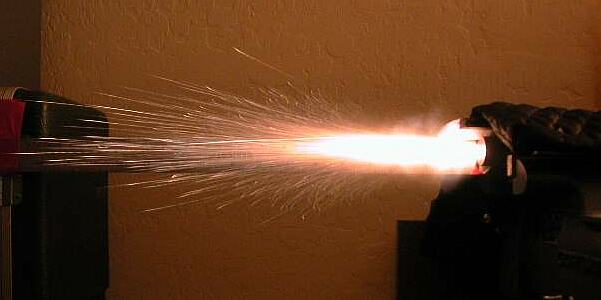

If the powder is going to ignite, I don't think there's any way isolate what the primer is doing from the ignition of the powder that happening close to the same time, especially where the powder is so close to the initial flash of the primer through the flash hole.
What we do know is that different brands of primers produce a different amount of flash through the flash hole to ignite the powder. How consistent that flash ignites the powder is going to affect SD's. That's where sorting primers and consistent seating depths come in. Like, you sure don't want to mix different primers brands in your batch of reloads. :eek: ;)
Remington 7.5's vs Federal 205M's:
