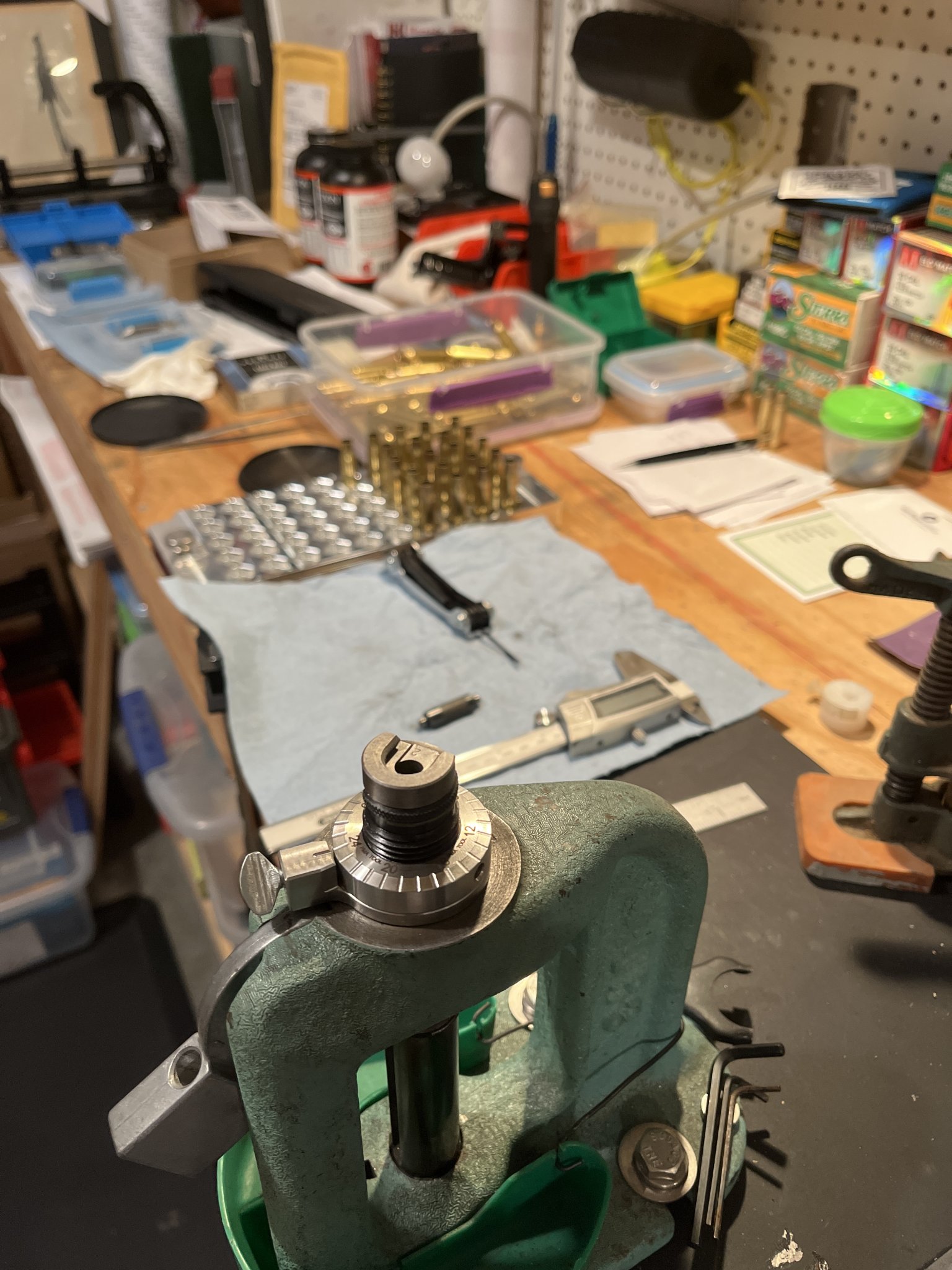

Thanks for all your advice. This is what I ended up doing. It’s an RCBS ram prime with a PMA tools micro die adjuster. It is super easy to dial in and very repeatable. No auto feed , so it’s slow. Easy on the wallet though.
I ended up getting the RCBS ram prime as well, but gave shims a try instead of the PMA micro adjust tool. So this solution costs about $60 ($33 for ram prime, and $25 for shims). Only done about 30 cases so far, but except for one that got seated a little deep (.0095), it's held within .0005". I think once I get technique down it will be just fine. How's your consistency with the PMA tool?
Pretty slick set up JC. I don't have a problem with consistency once the die is set up, while using the PMA die ring. Once it's adjusted and locked down, it provides very consistent results. The shims you're using will probably be a little faster to use for set up. The primers I have measured once the PMA die ring was adjusted and locked down were all within .0005" seated depth, so accurate enough for me! Once the die is locked down, it is pretty much out of the equation, so repeatability is all on the press, shell holders, and the ram prime die. Might have to give the shims a try though! Seems easy enough. Thanks for the tip, and great video!

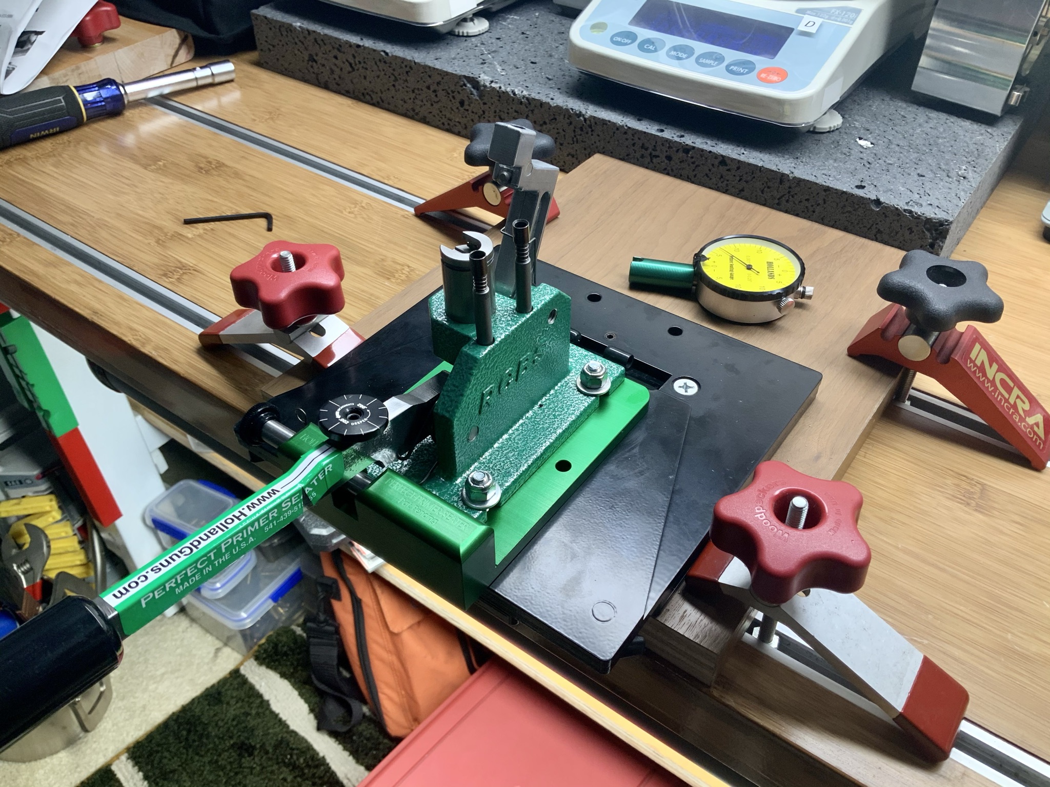

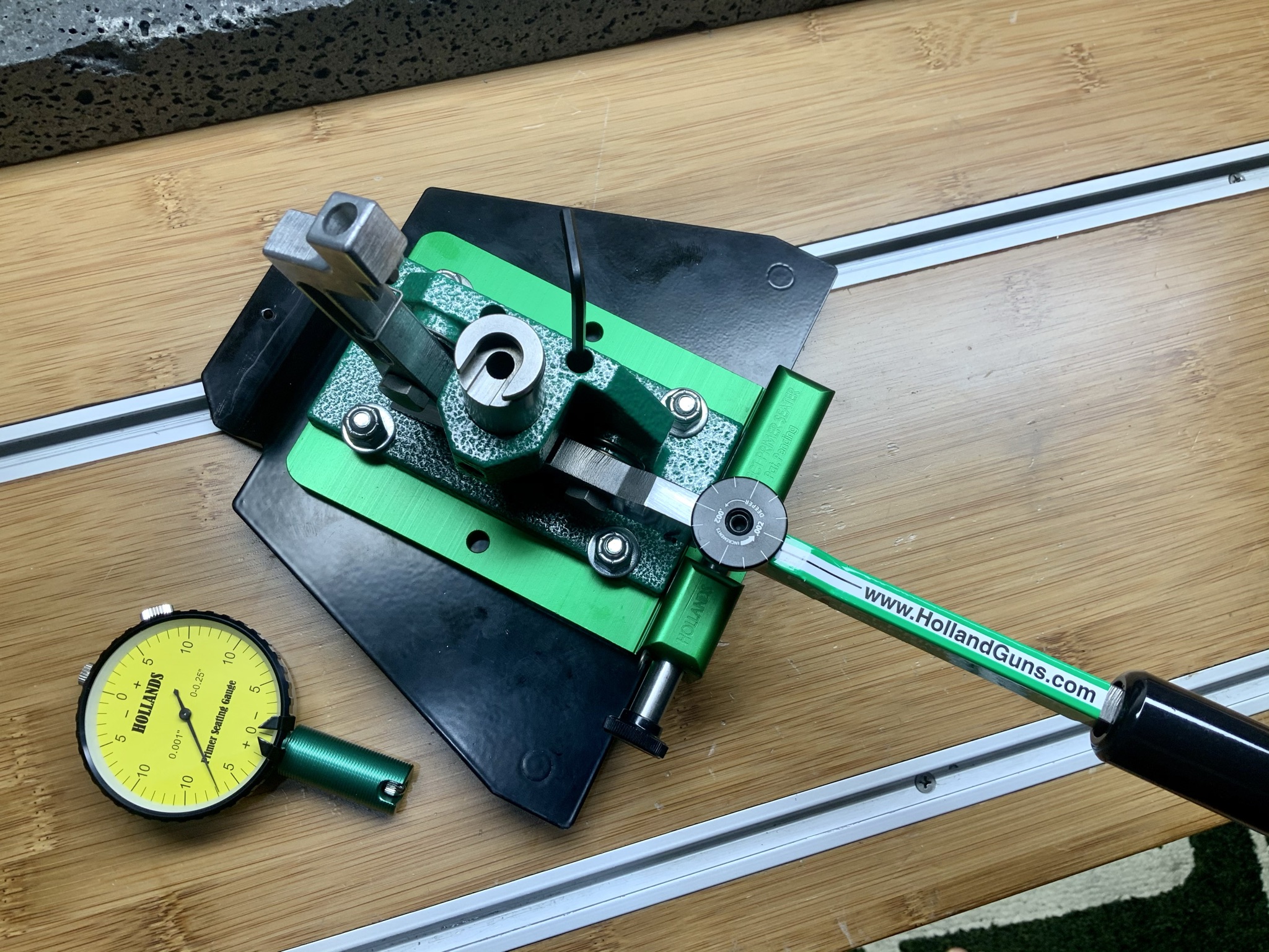

Only had the RCBS bench primer tool. Till I added the Hollands kit a few years ago. Been nothing but consistent depth seating. 24B4FE8F-49E2-4B41-B1CB-C90E9DDA5196.jpeg
