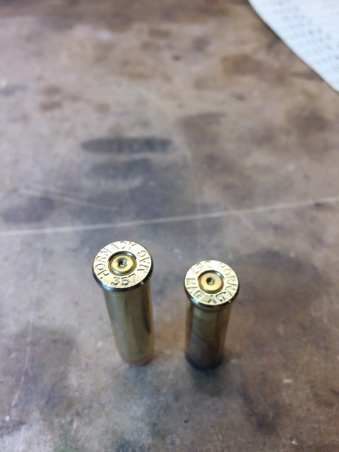

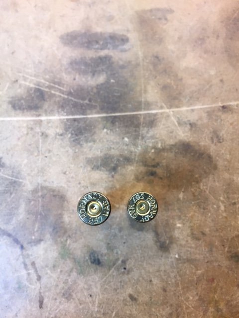

    Problem solved I think; I loaded 25 rounds today paying careful attention to making sure the primers were seated all the way to the bottom of the primer pocket. I then measured the depth of the primers and found that it varied between .002-.007. I separated them into groups of .002, .003, .004, .005, .006 and .007. All rounds fired perfectly regardless of seating depth.
    I’m thinking now I may have been going too fast the other day and “limp wristing” the primers creating an air pocket between the primer and the primer pocket which provided just enough cushion to cause them not to ignite. In the pictures below are one of the misfires (left) and a round that fired (right). I tried firing the misfires a few times so it looks pretty clear it’s wasn’t a light primer strike. For now I’m satisfied with that explanation and appreciate all the help!
