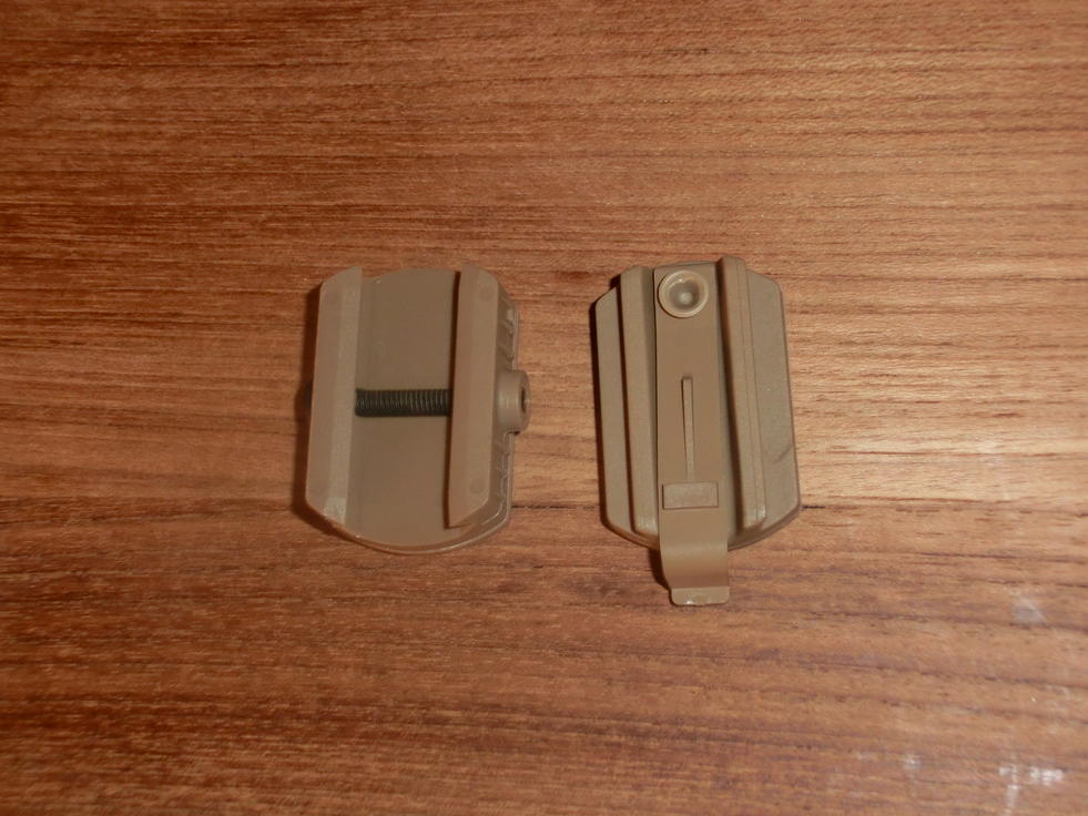

Just to add to this excellent record for the next person who finds it, princton tec has redesigned the picatinny rail mount and the ARC mount. These mounts no longer have the ability to rotate the body. The body when mounted is in a fixed position and light direction can only be changed using the light boom.
Both sides of the new pic and ARC mounts
