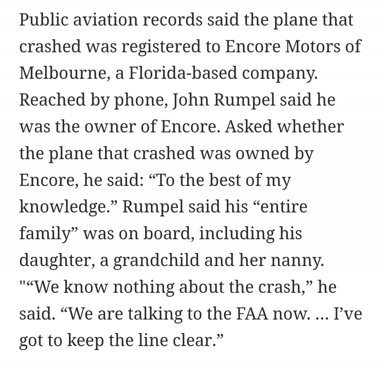

    So apparently a Cessna Citation deviated from flight plan and fighter jets scrambled. Plane crashed in rural Staunton VA. No info. on occupants but owner on board of NRA and was on Trump's 2A Coalition.
    Public government records say the aircraft was owned by Encore Motors of Melbourne, which company records say Barbara Rumpel is president of. It is not known who was on the aircraft at the time, however.
    A woman by the same name is also on the NRA board of directors for 2023 and served on Donald Trump’s 2nd Amendment Coalition – but it has not been confirmed they are the same person.

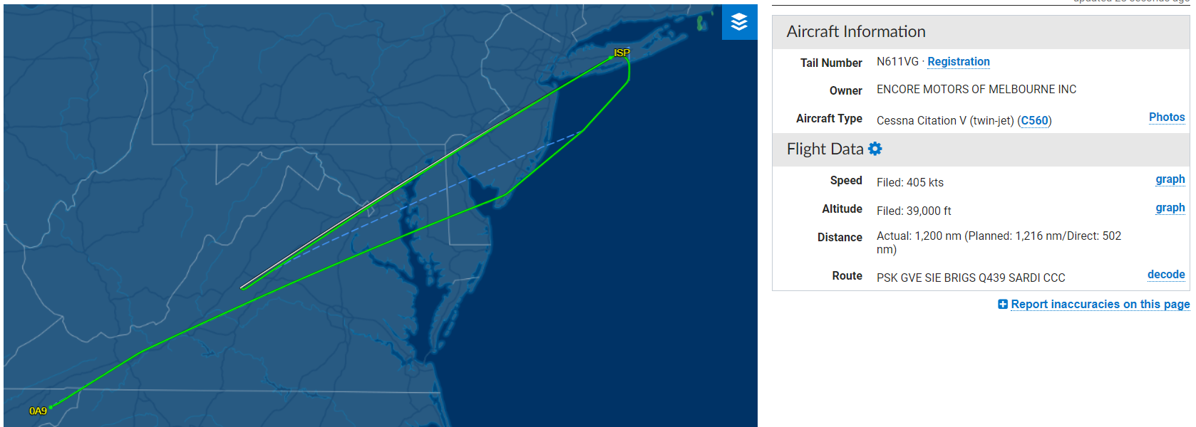

    Former 500-series Citation driver here....there have been some pressurization issues on various 560s before but on the whole with thousands of airframes flying millions of hours over the last four decades or so the aircraft and its pressurization system are quite reliable, and the plane had flown a 95 minute flight at altitude earlier Sunday. Could be a slow depress leading to hypoxia of all occupants like Payne Stewart, or perhaps a pilot incapacitation where passengers weren't aware. The CVR should tell the tale, wouldn't be surprised if that plane did not have a FDR.
    When you run out of fuel, one engine flames out then the other, the aircraft slows then stalls (with the autopilot disconnecting somewhere along the way), and it comes out of altitude rather quickly. The plane flew a constant heading/altitude southwesterly (likely ALT/HDG mode) after passing over KISP from CCC VOR and a rapid descent happened when the plane was just southwest of Charlottesville, going in not far from I-64.
    The owner was not onboard.

    Damn, that’s rough. ☹️ What an awful way to find out you just lost everything that matters to you (your entire family).
    “Hey, do you own this plane that just crashed?”
    “Uh… yeah…”

    From what the news said this morning, it flew to where it was to land, made a "U" turn and headed back. I don't remember if it flew over DC on the way there or the way back. The sonic boom was caused by the F-16. The news said the same thing about the people on the plane. My wife's first question was, what do we know about the nanny?

    Who can explain the coordinated 180 degree turn?
    The flight plan was SARDI -> CCC VOR -> KISP. You can see the predictive turn before CCC toward KISP. The plane overflew KISP, which was likely the last fix in its flight plan, and typically autoflight systems that encounter a 'discontunity' simply maintain altitude and heading after passing the last flight plan fix as a default.
