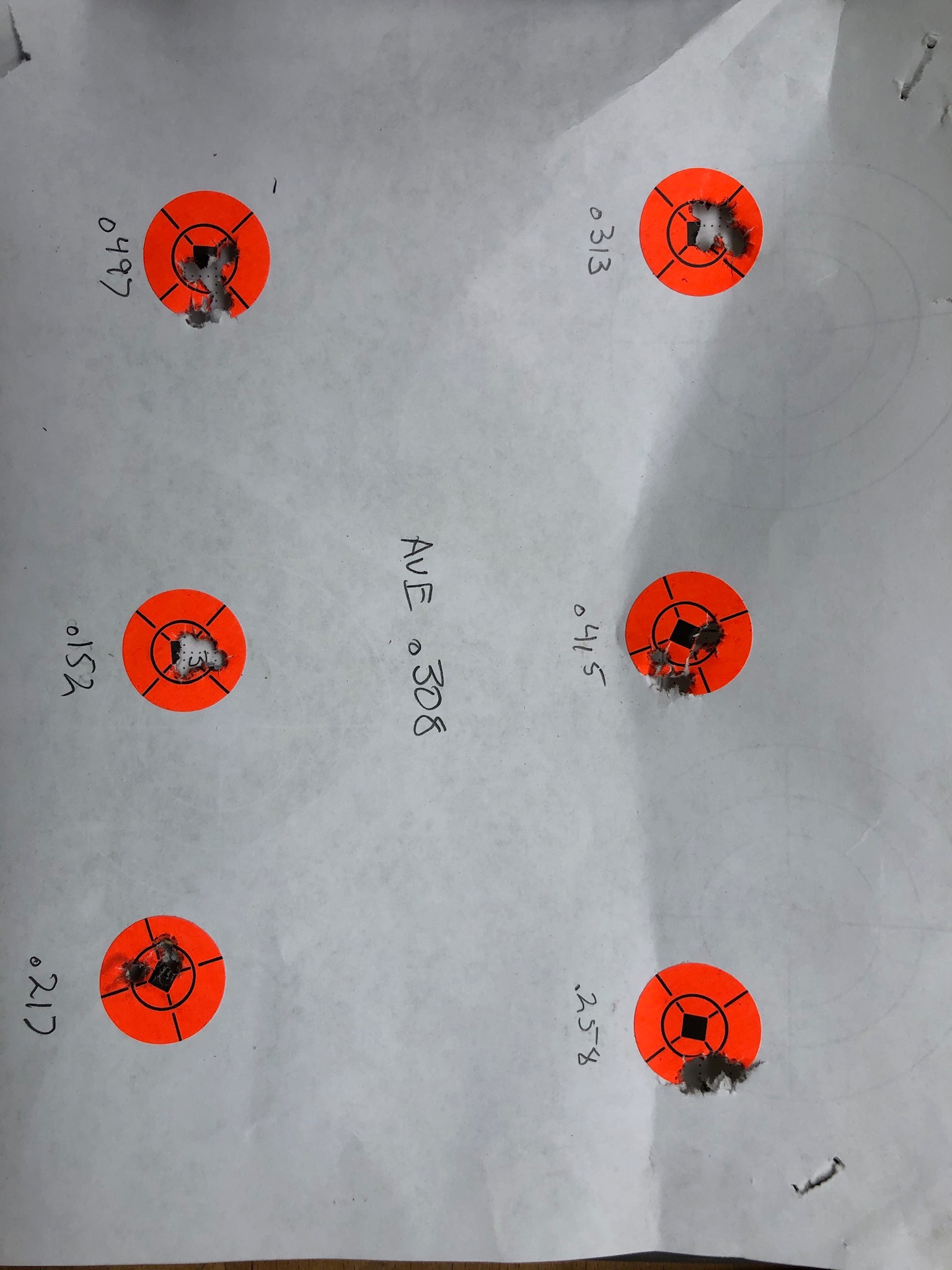

I have a stock Pro Varmint with the 16 1/2 barrel. Here is a 6x5 I shot with SK plus. I think it would probably shoot better with center x. I’ll Ben the first to admit I’m not a group shooter. I don’t take my time and crank of my shots way to fast so the two larger groups are no fault of the rifle I don’t think.
That's some pretty good groups there Sir !!! I'll say your rifle shoots 'Lights Out" !! Is that at 50 yards ?
Yes, that’s at 50 yards. Like I said though I honestly think the rifle is capable of shooting better. It shoots anything Lapua makes really well so far. I haven’t shot groups with rifle match or pistol match at 50 yards but they both seemed to shoot right around .75 at 100 yards. However the rifle does not seem to like Eley ammo. It still stays under 1/2” at 50 but it just isnt as consistent with eley ammo.
