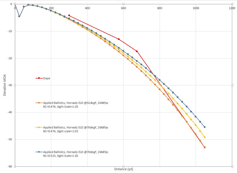

Almost any ballistics calculator tells me around 34MOA to get 1050yds at 70 degF.
Adjusting for conditions that day and sight scale factor with Applied Ballistics solver, I get a solution of at 44MOA.
The actual dial up was 53MOA! Verified with several shots.
It seems this combo of barrel and bullet results in a curve that goes exponential after 700yds. Well that ain't right I'm thinking.

Good points. I did a tracking test a couple times but only went up 24MOA rather than the full scale 60MOA. For the tests I did, it showed consistently a linear +3% error. I took that into account with Applied Ballistics calc using their 'sight scale factor' still WAY off at long distances.
I will try to find a way to do a full scale tracking test and see if it goes non-linear and can explain the results out at 1000 yards.
IF that is the case, how do I account for a non-linear scale factor? Applied Ballistics only has a single value so it assumes it is linear. Any suggested calculators that give 'trueing' at multiple points to capture a non-linear scope?

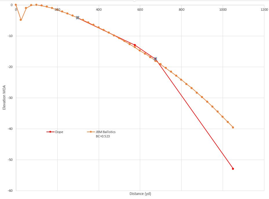

lowlight, thanks for the feedback. I'm wondering if we are talking about using a different JBM calculator. I have use this one:
Attached are the results using that tool with the correct environmental and bullet BC info. Again, beyond 600 yds, the calc deviates badly from the DOPE.
You mention adjusting MV and BC at different points. I don't see how to do that in the online calc I linked above. Makes sense and I have the variable BC data for the Hornday ELD bullet but can't find a way to do that. This calculator has a single MV and BC field so I can't vary it to match the actual data. That is exactly what I am looking for in terms of 'more variables to tweak'.
I mention the enviro and MV data above. DOPE marks were -4.25MOA@300yds, -13.0MOA@575yds, -17.5MOA@675yds and -53.0MOA@1050yds.
That is the correct JBM if that is off you have an issue
JBM Is almost always super close, forget that trajectory chart, I want to see drop data,

Let's put it this way, the curve should look like a curve, not a jagged line. Your plotted curve is obviously wrong. Now, WHY it's wrong is the question. If the scope is not totally calibrated to the limit of travel, you could be getting bad data in the first place, you say you needed 55 MOA, but that's reading off a dial, the actual travel in the scope may have been 44 MOA, we have no way to know. How precise and accurate are the ranges noted? Did you measure them, or are you taking someone else's word for it. I've been on ranges marked in meters but are actually yards for example. What's the terrain like over that 1050y shot. It's possible that 15mph 3 o'clock wind was a 15mph downdraft at some point you did not see.
