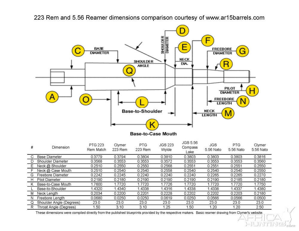

I recently decided to try making more accurate 556 ammo by sorting brass, measuring shoulder from cases fired in my rifle, using bushing and micrometer dies, etc. Unfortunately, unlike my other Sinclair bump gage inserts, the 556 #23 will not pass over the case mouth of brass from my AR. It works as it should on new or sized brass. I only have the full length bushing die. Did I get the wrong insert? It really does me no good if it doesn’t fit fired cases. I have inserts for 338 Lapua, 308, and 6.5 Grendel and all work on fired brass as they should.
23 degrees is the correct insert. Couple of things could be going on, but it sounds like your chamber (223 Wylde?) has a larger neck diameter than the gauge insert ID.
Can you measure the OD of the neck on undented fired brass?

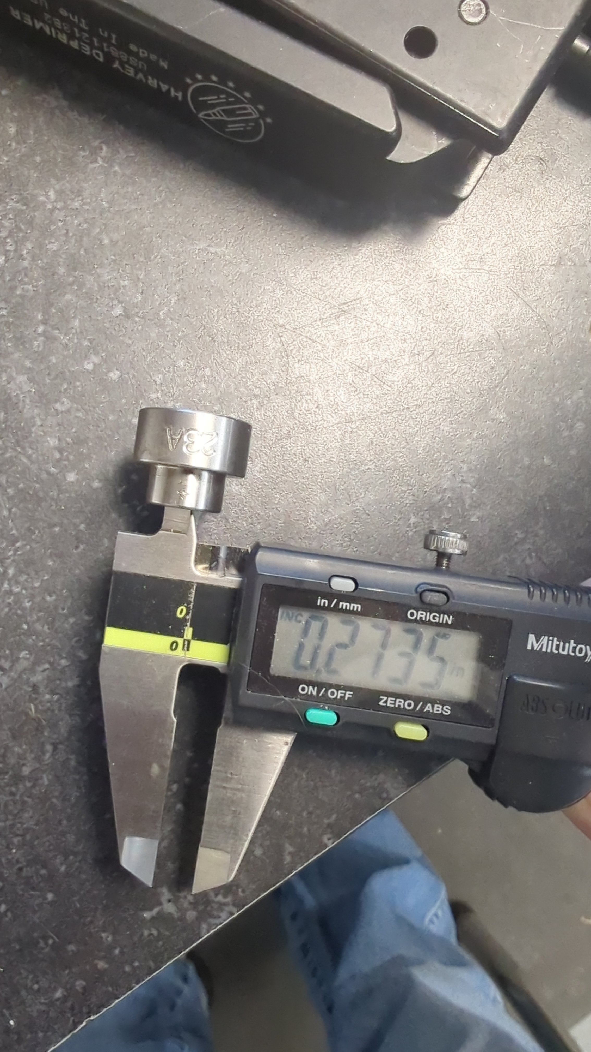

Take your calipers, and check the ID of the end of the gauge insert that goes into the 'body'. See what that measures.
I just walked out to the shop, and checked mine: it measures 0.274" inside - which should be *plenty* for any brass coming out of a .223 / 5.56 chamber.
Unless it's been dented or otherwise deformed. ARs do tend to be hard on the case mouths/necks to begin with, but sometimes brass gets flung into a concrete wall, or stepped on, and then all bets are off as far as it 'fitting' in anything until it's been through a sizing die. I'm assuming you're bright enough to not try to measure one of those, and then complain about it here ;)

I’ll do it as soon as I get home. It’s once fired Lake City 556. It came from a Criterion Hybrid so I’ll check to see what chamber they use. It is 223 Wylde.
I’ll check as soon as I get home. I also thought it could be a one off but I checked 30 pieces. Not a single one would fit without significant force which would likely jam it into the gage.
Lol! I was honestly hoping it was me being an idiot, but I can’t see how it’s operator error yet. Every piece I tried had a neck and mouth with no visible damage/abnormalities. I’d hate to have to buy a neck sizing die that I’ll never use just to get shoulder bump set for this rifle.

Inner diameter of the insert is .2545”. Outer diameter of fired case mouth is .2575”according to my mitotoyo calipers.
Inner case mouth .2325” and .2335”
I apologize.. all measurements are in inches
Ideas??
It should look like this:
Yes I know the insert in the pic says '23A', which Brownell's says is for 6.8SPC, not .223 Rem. Most of the inserts I have pre-date the 6.8 SPC, or Brownell's buying Sinclair Int'l.
Good that is exactly what I did. Bump gage insert measured .2545 inches inner diameter. Case mouth measured .2575 inches outer diameter, so clearly a problem. Is it possible to buy a bushing neck die and size only the mouth without bumping the shoulder? I’d rather not, but I’m not skilled with machining fittings.
