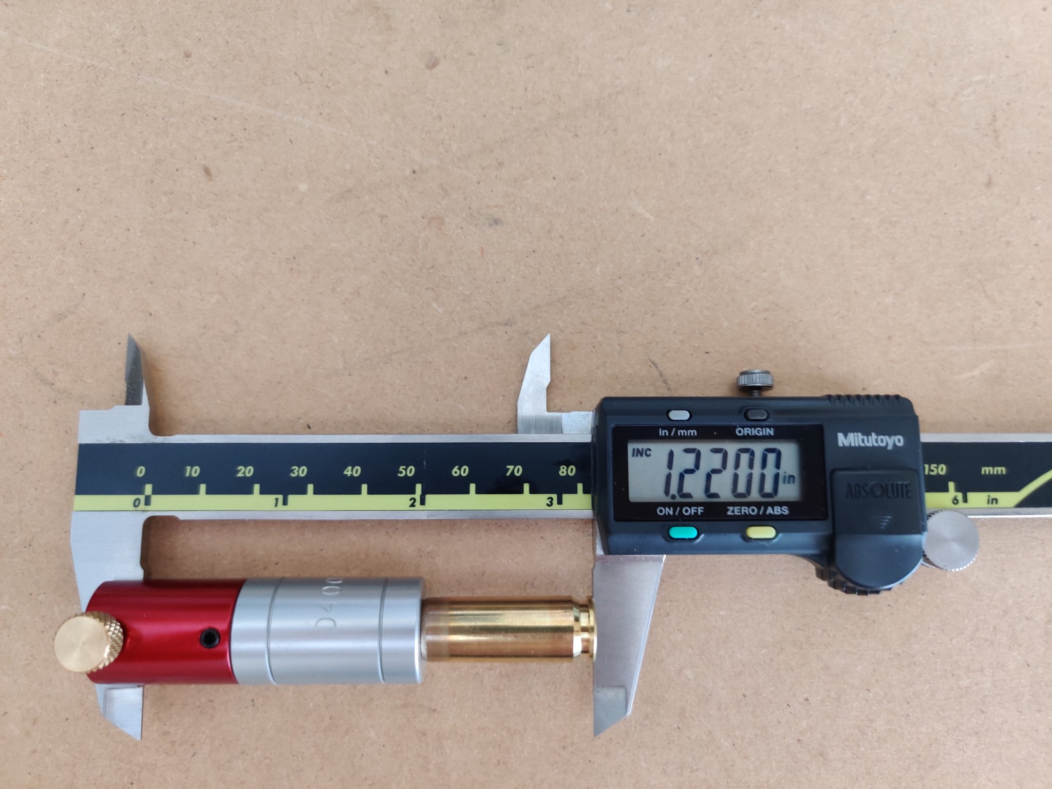

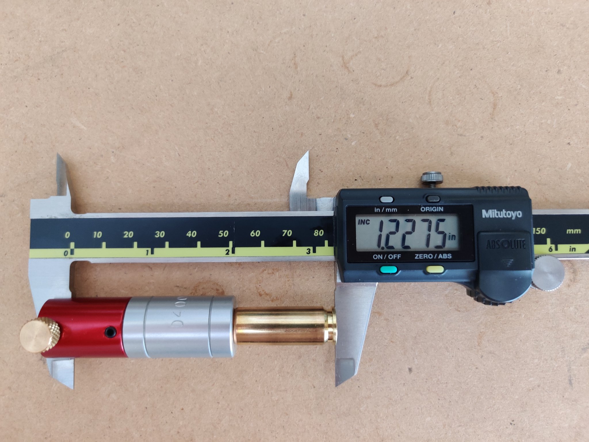

I just jumped into the dasher cave. But now I have jammed at the first step, the brass case.
This is a brand new Alpha 6 dasher OCD brass case. I am feeling very hard but I can still push the case by the bolt with the Hulk power.
I loaded 85 rounds (17 different load data * 5) without resizing the brand new case because these cases are brand new, and I am a newbie of 6 dasher. I think the case should be good and it must be my fault.
After 85 rounds, the best ES is 13, and the worst is 33. It is okay....but I am playing 6 dashers, right? It should be lower than 6.
I measured these cases after I go back home, the fired case has the same size as a brand new case. Usually, the fired case will have a little bigger than before, right? That means the case has no space for expansion if the size is the same, even a little space, right?
Maybe my rifle has a problem? Maybe, but I ordered Peterson 6 dasher cases, I want to try it again. I was shocked.
This is a brand new Peterson 6 dasher case. I can easy to push the case by the bolt with baby power.
I know the 6 dasher does not have the SAAMI standard, but which one is right? the Alpha or Peterson? of course I can resize the Alpha but I just want to confirm that before I do it.
Forget about what “should“ be happening just because it’s a dasher. Basic reloading concepts still apply. If the brass is a jam fit, it needs to be resized, bumped, whatever you want to call it. Based on your reported measurements, let’s start at 1.223” and see if the bolt closes without resistance, or shoot the Peterson and then measure the once fired case and use that minus 2-4 thousandths.
You will likely see the es come down a little with once fired brass (new brass rarely gets the best es/sd stats). However, getting an ES down around 6, over any number of shots that is even remotely representative (10?), is going to take absolutely expert+ level reloading skills and equipment…and like Dthomas said, might not even be realistic at all.

Yes, you are right. Nothing “should“ be happened.
Thank you for your idea. I will try it~~~

Thank you. Sure, I will resize the alpha case. Actually, I felt the case size is not good before I played the 1st round, but I think the "famous brand and brand new" should be right. I should trust real data, not the brand.
