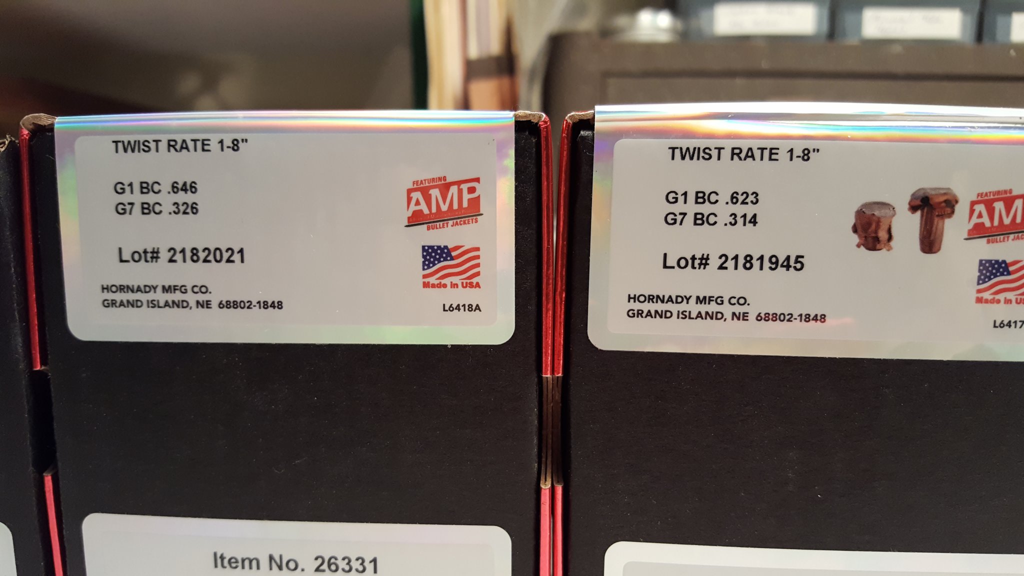

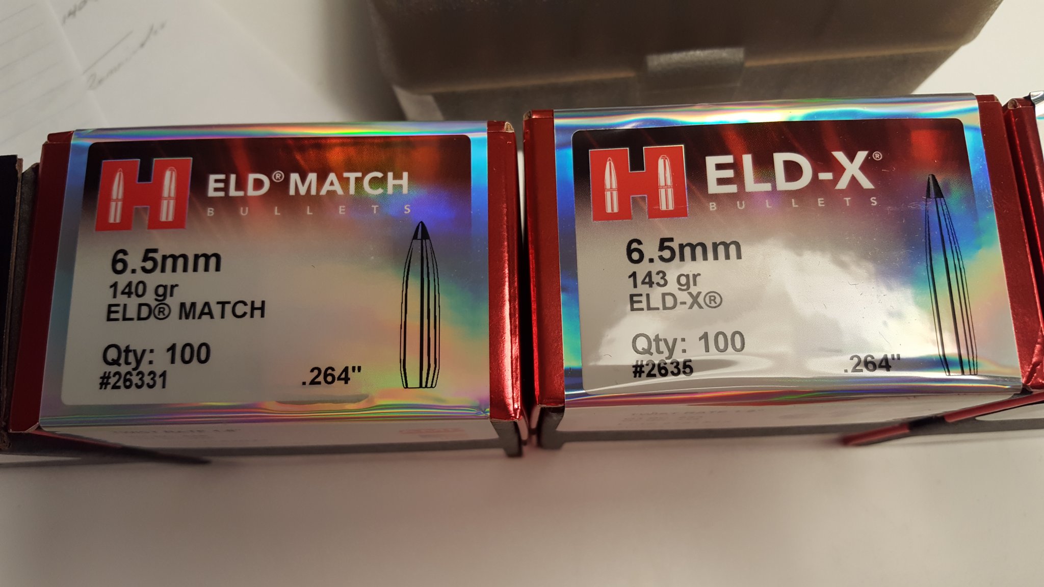

Got a lot number for the ones you have?
Is this a hornady packaged lot of bullets or one of the midway special boxes where they combine or split up into different sized packs? I thought I was getting a deal on my elds from midway with the pricing but turns out they were repackaged so who knows if I actually have all of the same lot or not. That two cents savings per bullet would have bought a lot of peace of mind.
Reactions: canezach
Midway does that on all there bullets. Just tried to order some 175 SMK's and they could not guarantee same lot #. I don't know how they sale any bullets. And these were in 100 count boxes.
Hence why I frequent Powder Valley; they give a shit, and are shooters themselves.
When ever I buy bulk bullets, brass, whatever, they take the time to either put the lot number on the invoice (recent addition) or (in the past) wrote on the box itself with a sharpie, the lot number. When ordering multiple 100rd boxes of bullets or brass, they take the time to make sure they're the same lot. Nothing but good things to say about the PV folks...
I'm in the same boat as Spife. The 140 ELDM is the only bullet I use for my 6.5 Creed match loads, so I thought I was getting a good deal when I ordered one of those bulk boxes of 2000 bullets. I thought I'd be getting four 500 round boxes, but no, all I got was a box with 2000 loose bullets, like someone took twenty 100 round boxes and just dumped them into a larger box. I may have ten different lot numbers in there. Who knows?
Edit: I would've been OK with twenty individual boxes, that way each box has bullets from the same lot number and should be fairly consistent to each other, but with 2000 loose bullets all mixed together in the box, I'm finding a lot of variation from one bullet to the next. I set my seater die to X" base to ogive. One bullet seats at X", the next is 0.05" shorter, the next is 0.10" longer, etc. It's more trouble than it's worth, since I now have to measure each individual round, set aside the ones that are short or long, readjust my die, re-seat, re-measure, etc. I didn't even care about the price difference between bulk and individual boxes. What I wanted was 2000 bullets from the same freaking lot.
Reactions: spife7980

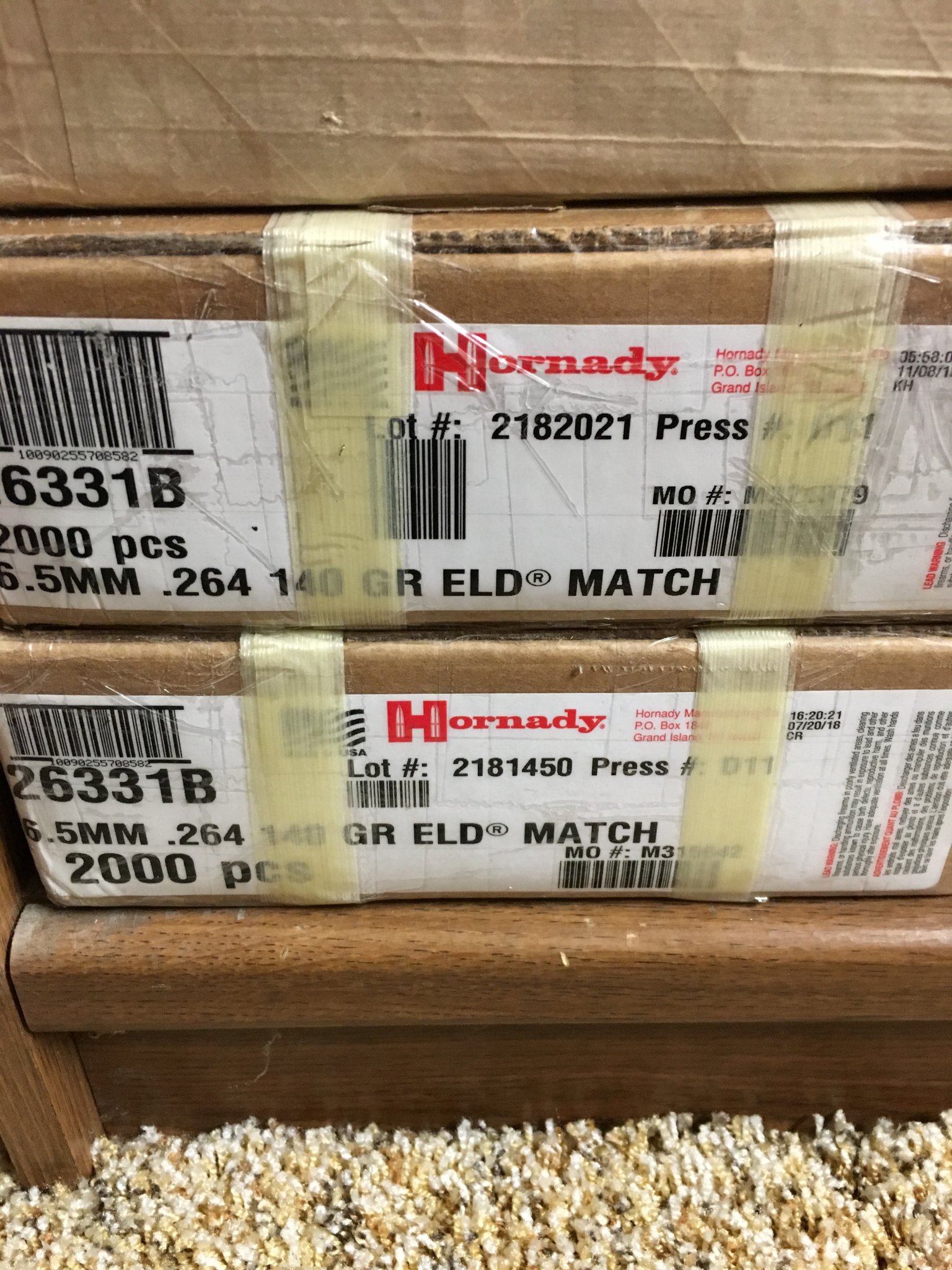

Were the problems your having with the 2182021 lot number? Looks like I have a whole case of 2,000 pieces from that lot. I haven’t opened and checked those but I’d be curious if that’s the lot number you’re having problems with.
Cracked my case open that’s the same lot number as the OP’s. I picked 20 random bullets throughout the box and measured the OGIVE with a set of Mitutoyo calipers and a Hornady comparator. I hade an ES of .001 between all of them. Just for shits and giggles I compared the difference in OGIVE between the other lot I have open and the ES between the 2 lots was .003
I can't speak for anyone else, but that (see mustang-cars picture) isn't how my bulk order arrived. There was no Hornady label or anything on the box, aside from the shipping label, so I have no idea how many lots my bullets came from. I will measure a random selection of my bullets when I get home and report back.
Make sure you peel some of the tape away on the sides where the label is supposed to be. The 2 cases I’ve purchased from Brownells they covered the label with brown packing tape. If you peel it away you can find the label though. The picture of the 2 cases I posted, I purchased those ones from Midsouth shooters supply.
