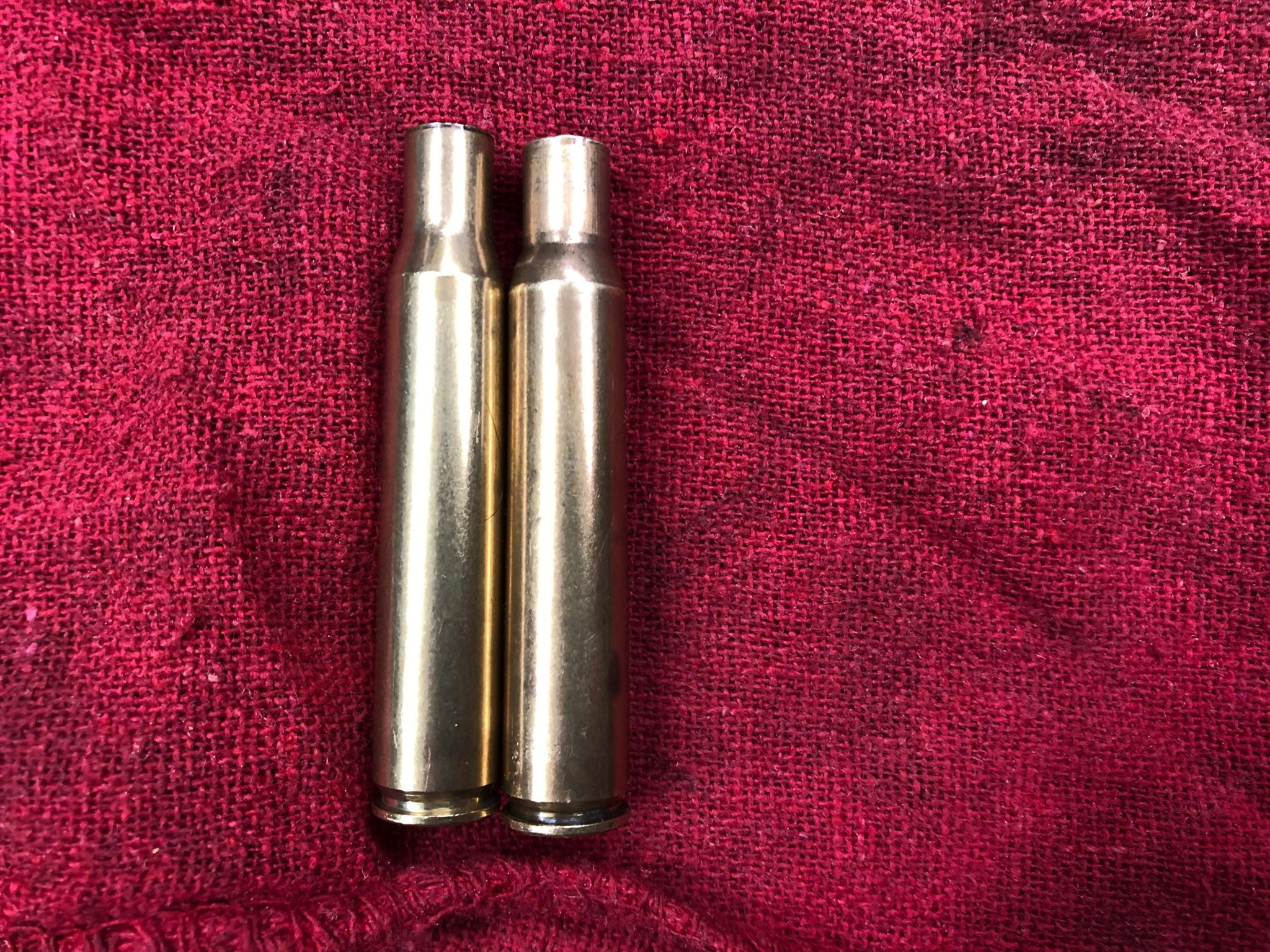

I'm using an RCBS full length die that's giving me problems resizing LC brass. It works perfectly fine with Winchester and other brands but with LC brass the shoulder is pushed further back. I'm assuming because of the extra thickness. Is there a die that's better suited for military brass?
Pic shows LC on the right

I've reloaded a lot of LC 30-06 using an RCBS full length die but I quit using Hornady One Shot because I was getting too many stuck cases in various calibers. I've been using Dillon Case Lube which is a lanolin lube for over 20 years now. Do your LC cases feel like they are taking a lot more force to resize or are they difficult on the downstroke to pull out of the die? That could indicate a lube issue and that your close to getting a case stuck. I would expect you to need to adjust the dies for shoulder bump because the LC cases will have a different amount of springback. Maybe call RCBS tech support and ask them?
LC 30-06 is usually way long. It looks to me like the case mouth is bottoming out on the inside of the die and buckling the shoulder before it touches the die.

It "appears" the shoulder is bulged yet the neck isn't sized all the way to the shoulder if you look at the ring just above the shoulder. "Appears" you're bottoming out, as stated above.

Now, a bulged shoulder as shown in your picture can be caused by more than one thing...
A. As stated, case mouth is hitting too soon bc case is too long. There are other ways to know this.
B. The size of mil case dimensions fired in a fat chamber, may move lubricant differently than slimmer cases... too much lube on a fat case neck and shoulder moves down under pressure, and in turn moves the shoulder in strange ways.
C. Bc the case is so fat, more force needed to compress the brass etc, the press flex may be great enough that the shoulder hasn't sized down yet because press flex gave added distance. Leaving the shoulder pressed fatter at that point in the process, where. 003" more sizing would resize the shoulder width to where it's not visibly fatter.
c-1. Another. 002" compression could then show the too much lube wrinkling of the shoulder...
There are several ways to find the culprit depicted in the picture.
If you have this problem (B), the A-J die setting method will show you excess lube movement to the shoulder and answer that as well as provide the other data.
