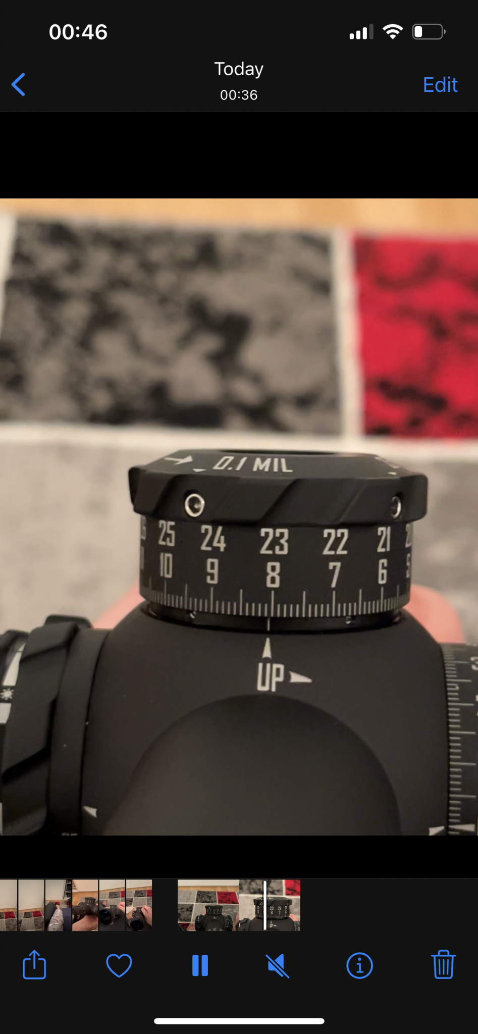

Hi everyone,
I just received my new zco 527
I set my zero many times but still having the same issue (followed the instructions)
My Turrets are not aligned… 😔
Am i doing something wrong?
Thanks in advance
I think i found the reason, actually when i zero my scope i can’t push it down directly aligned , it’s just like something is blocking and i don’t want to push it hard….if i move it slightly it goes down and that’s where i start already not aligned 😔😔

I really don’t know why you people are so upset that I made a video!
And yes i did followed the instructions and yes i responded to the PM…

Ok let me get this clear,
I did post it here because i did believe it was only me doing something wrong and i thought other people would have the same issue and that i can get the right instructions without bothering the ZCO guys who i believe are very talented people.
Now , i did followed the instructions end yet my problem is still here and I’m calling ZCO tomorrow to get more insights.
To make it short :
loosen the turret set screws then rotate the turret clockwise and align the zero mark with the reference line on the scope body. Second, lightly tighten the turret screws then push the turret inward to the locked position…at this step i can’t push it down aligned with the marking, it’s blocked halfway and i need to slightly move it left or right to push it all down.
Cheers
As far as I can tell, yeah....you absolutely just came looking for other's experience and never threw shade at ZCO or claimed it was a defective product.
Good luck, I'm sure they will get you squared away.
Cheers

So, you followed the instructions and you responded to the PM. What were the results ? Is the problem fixed ? Was it user error ? Was it a legitimate product problem ? Are you shipping it back to ZCO ?
