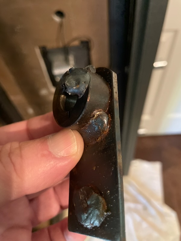

No help on getting it open, not exactly. Bet it is like my friend's safe recently. Same thing, had to get a lock smith and drill a hole. Wound up being the actual bracket that pushes and pulls the locking bolts. Real shitty weld and it finally broke. Five minutes to fix but a pain to open.
