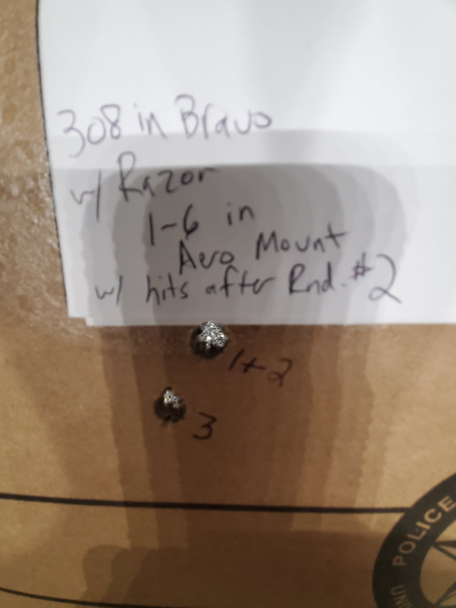

I threw on the only other optic I have, a 1-6x and it was still having the problem. I attached a picture of a 3 round "group." First two same hole. Bumped the gun around, shot the third round and it's low left. This is at 25 yards.

I threw on the only other optic I have, a 1-6x and it was still having the problem. I attached a picture of a 3 round "group." First two same hole. Bumped the gun around, shot the third round and it's low left. This is at 25 yards. View attachment 7365523
Did you do this a couple of times or just once? When chasing your tail you have to make sure to be thorough. I’d want to see this same thing happen at least 3 times in a row before eliminating the scope. Not sure if you tried a different scope base when you did this but I would def suggest that. I think the stock is fine since it does it with the factory stock too.
I did it a few times, but only took a picture of one group. I usually shoot 15-20 rounds after each change. The problem has been consistent.
When trying the different scope, I did use a different scope mount as well (an Aero SPR one piece mount). No improvement.
